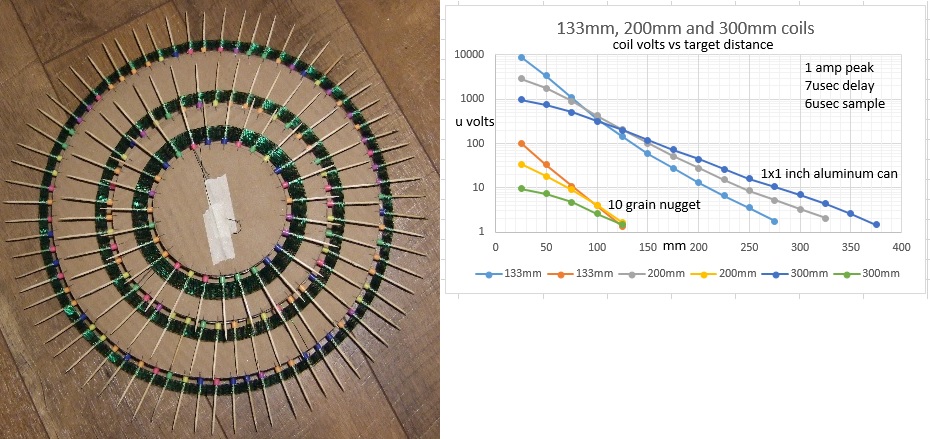

                  I have been using a 200mm diameter coil and wondered how much I would gain with a bigger and smaller coil. I did a test awhile back comparing a 200mm coil with 133mm and 300mm coils. Inductance and current profile the same for the three coils. Charted target distance vs integrator out. Got similar results to a chart posted in other threads. Don't know if it relates to the Vallon coils. The amplitudes crossed at (diameter A + diameter B)/4. Gain on some targets, lose on others. Still don't know what size to end up with.

                    Approximate. Looking at chart reply #593 the 300mm coil would be better than the 200mm coil for nuggets over 1gram, worse for nuggets less than 1gram? Something to try, find what size nugget can just be detected at(diameter A + diameter B)/4. I've found coil circumference converted to round to work for odd shaped coils.
                    My thoughts, appreciate being corrected if wrong.

                      Hi Green good chart thanks, I've been going over some of your charts recently
                      where do you place the target when you take a reading, is it stationary ?
                      Is your integrator a 1c or 2c ?

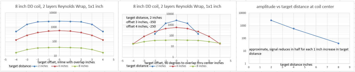

                        1C integrator. Stationary, most of the time over the center of the coil spaced to give a maximum signal without the over ranging the amplifier. Depending on the coil connected(1.5 to 12 inch diameter) to the bench circuit it might be positioned closer to the edge to get a good signal. Or I might change coils. The amplifier full scale is 2.5 volts. I found my scope can effect the slope if the scale is less then .5 volt/div. so I try to position the target for at least 1 volt peak change, no target to target. It's a lower cost scope but does an acceptable recording.
                        Just described what I do when charting decay slope out of the amplifier, no integrator. Charting amplitude vs distance. 1C integrator, target stationary located at defined position over center unless charting amplitude off center which would be defined.
