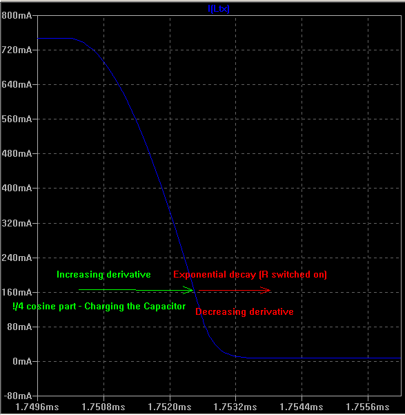

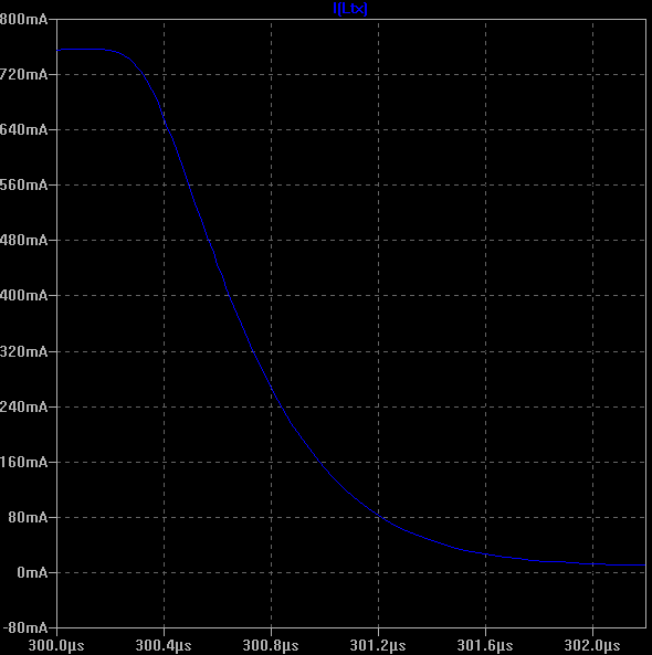

          A normal PI discharges the coil on a resistor which causes an exponential decay. The derivative of the decay decreases with time.
          Te Vallon discharges the coil on a capacitor, which causes a quarter-cosine decay. The derivative of the decay increases with time.
          Targets with shorter tau respond to the derivative of the decay. Compared to a regular PI, for the same sampling delay the Vallon provides a derivative that's larger and therefore a larger signal for short tau targets.

            Why couldn't the Vallon detect the 1x1 inch aluminum foil which would be a short tau target in the above reply?
              http://www.geotech1.com/forums/showt...768#post217768
              Perhaps it has a shorter tau than the 0.1g nugget. Even if low taus are enhanced there's a minimum coil decay beyond which nothing can be detected.
