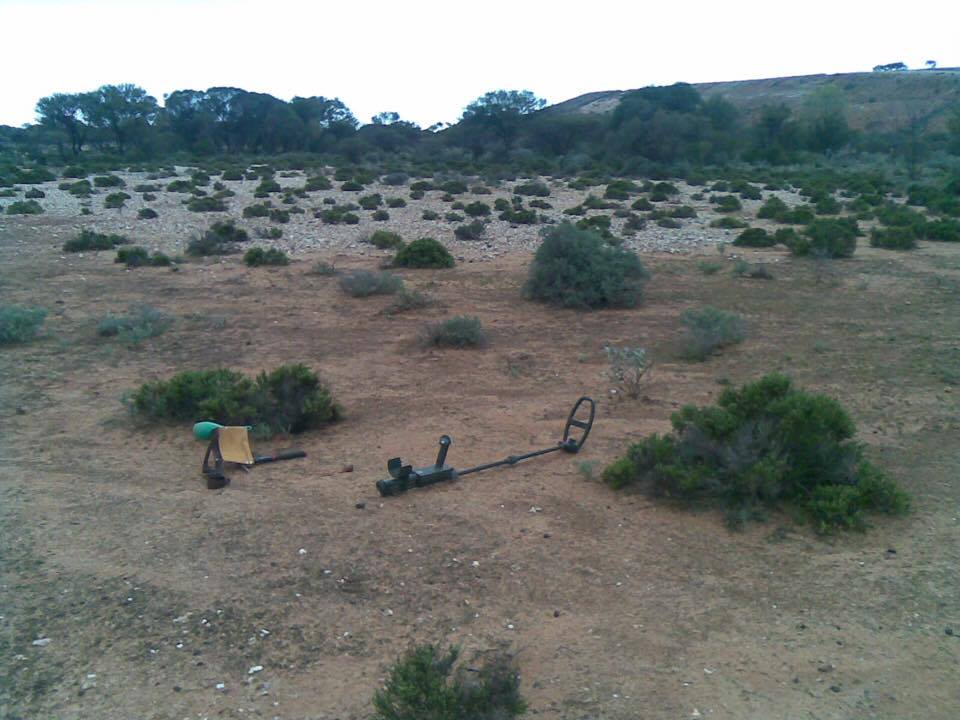

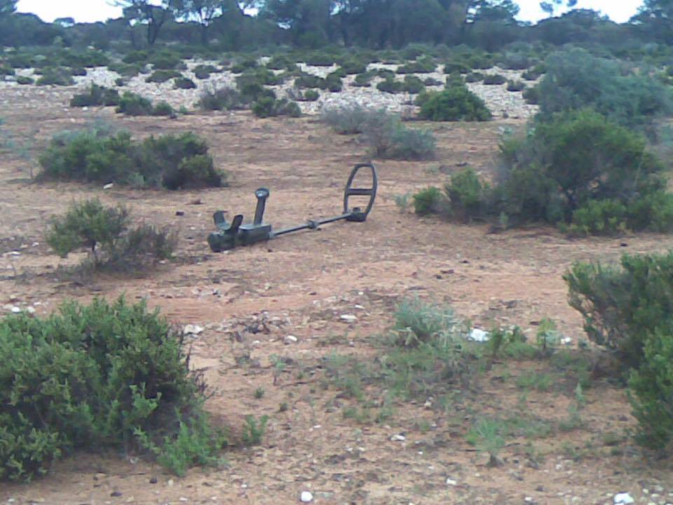

        • I had to share this pic This is the Vallon laying on out gold lease while I went back to get the car....The Vallon looks the part, just hope it acts the part

          • Hi Kingswood looks nice just need a couple of roos in the back ground
            only 32' here today.

              • Hi Kingswood
                Looks ready to go...Good luck on finding a few,
                Chet

                  Thanks Chet. To be honest, half the fun is in trying to find it Quite relaxing.
