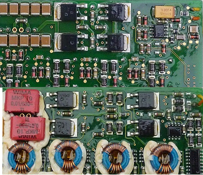

    Reorganized photo of the TX top and bottom view...

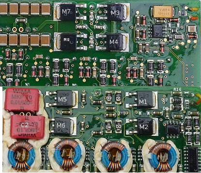

    Annotated photo'''...

    I could not determine from all of the photos where the damping is introduced, so I just assumed (again) what would work. Without having a board to do continuity checks between connections, this is the best I could do for now.
    And, yes, the 4 toroid transformers are gate drive pulse transformers. They used 4:1 ratio to get enough drive voltage to drive the MOSFETS as hard as possible. I can see from the photos (underside of the toroid transformers ) that they used zener diodes in the secondary circuit to limit the pulse amplitude to the limits of the IRFR320.
      ... One obvious thing that I missed is the apparent absence of a reservoir capacitor for the TX stages. There is one 1000uF 16V cap on the distribution board, but that is not where you would expect it to be. It seems to be across the battery input.
      Eric.
      Eric could the 18 47uf tantalums lined up on the top and bottom of the TX boards (as far as I can tell they are arrange as 2 rows with the caps in each row connected in parallel ) constitute your TX reservoirs (one for + and one for - )?
          Actually the damp wouldn't be patently obvious on the board... the dissipation of the damp is only 1.4 mw according to simulation! So, I guess we scan the MELF smd resistors for a value of around 1000 to 1200 ohms (which shiuld damp a 1800uH coil).

            I made a mistake on the schematic, but it really didn't change the outcome. I have Resistors R6, R7, R10, and R11 going to the gate of the respective MOSFETs where the actually go to the source of the respective MOSFETs. I had to adjust the values so that I still had 1A coil current. The reason for the mistake was when I flipped the image in nthe photo editor to line up the top and bottom sides of the TX. Everything else was OK, just a negative image of the M3, M4, M7 and M8 images.
              I still cannot confirm the source of the kickstart as capturing the flyback with the diodes pictured is not enough to kickstart to 1 A.
              There must be a kickstart though. Otherwise you would not see a 250V spike at the start of the TX?
              Eric.
                Eric.
                Oh yes there is a kickstart... it is coming from the large red 630V 0.01uH capacitors (one for the positive side and one for the negative side) on the same side of the board with the toroids. I just can't determine where they are getting an adequate charge from. And I can't get the sim to work properly with 0.01uH. I need to increase the value to about 0.45uH to get the boost up to 1 A. This may be due to inaccurate simulation of the MOSFETs, as even though the model is from the supplier (Vishay), there are many aspects that aren't modeled. But things are accurate enough to prove the concept.
                  Correction... 0.045uH not 0.45uH!!!
