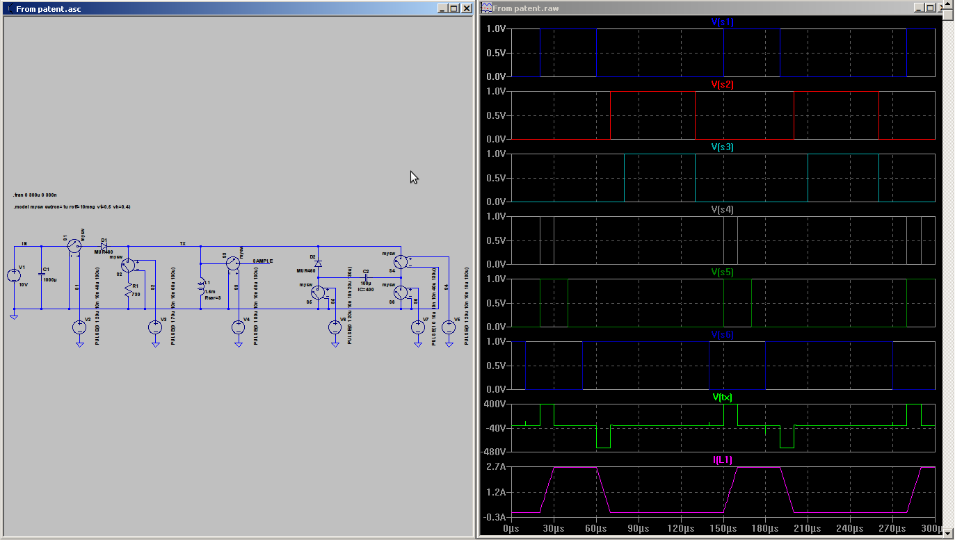

        Well, I think I have determined the configuration and function of the 8 MOSFETs.....
        Well... in light of Phiphi's find of the Patent and the drawings shown with in, I think my presentation in post #466 is totally invalid and is to be disregarded. I do believe that the patent document and the drawings applied to effect bi-polar operation are key to understanding the Vallon TX. I see some areas of the drawings that directly correlate to the board/MOSFET layout. It seems that the underside of the board (opposite side from the visible toroids) is dedicated to the kickstart/HV section. Each side by side pair is connected as depicted in the drawings (note that the emitters of each pair is connected together via a center tapped pair of resistors). I had always wondered why they chose that configuration, but now it makes sense. I have not quite figured the rest of the layout and take the following into consideration: (1) the top right MOSFET, on the toroid side, is connected directly to the coil, (2) both of the right hand MOSFETs, on the toroid side, have the same gate drive signal, (3) there only 4 gate isolation pulse transformers available.
        • First stab at simulating the patent circuit
          Needs some tweaking, but the results are interesting.
Name:	From patent.png

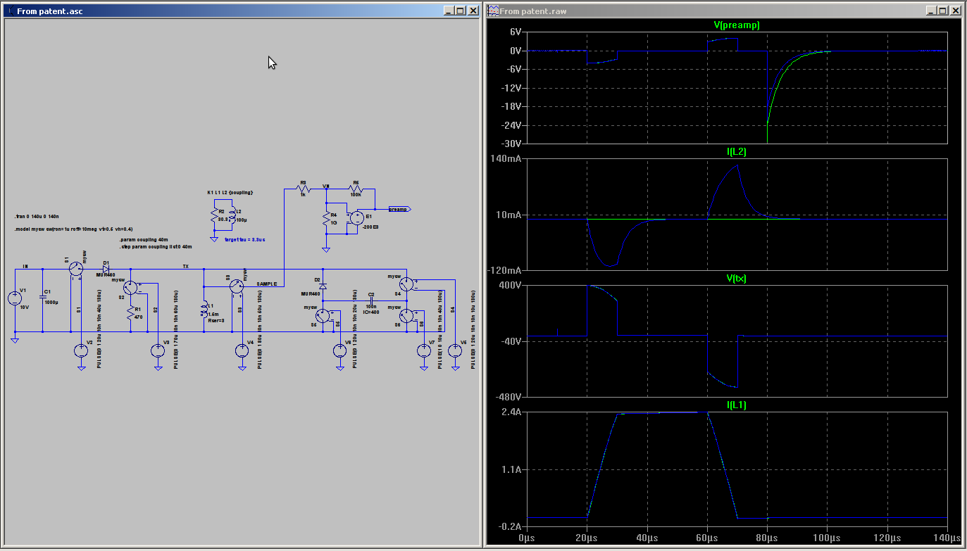

            • With preamp
              Changed C2 from 100uF to 100nF, added ideal preamp (x100 gain), and 3.3us target.
              Now the results are closer to the patent diagram.
              Also, if you remove the initial condition on C2 (400V), and increase the simulation stop time to 100ms, the TX voltage builds up from zero to 400V.
              Interesting stuff ...
