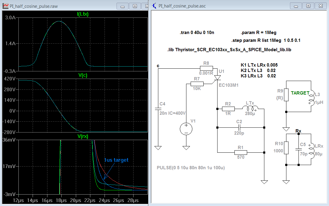

          • Originally posted by Teleno View Post
            A normal PI discharges the coil on a resistor which causes an exponential decay. The derivative of the decay decreases with time.
            Te Vallon discharges the coil on a capacitor, which causes a quarter-cosine decay. The derivative of the decay increases with time.
            Targets with shorter tau respond to the derivative of the decay. Compared to a regular PI, for the same sampling delay the Vallon provides a derivative that's larger and therefore a larger signal for short tau targets.
            The first PI's in the 1960's used to discharge into a capacitor, otherwise the power transistor would instantly die. Then, epitaxial planar transistors came out that, with care, you could run in avalanche mode. Finally came the Mosfet.

                I'm not convinced that's how the Vallon works. According to their patent, they switch in the damping resistor during a later part of the decay curve. If you play around with that idea in SPICE, and switch it in about half way down the curve, you can get it to sample at less than 10us. The hard part is getting it to work using real components.
                  The later you switch the damping resistor on, the larger the derivative and the closer that derivative is to the sampling point.
                  On the other hand, the later you switch the damping resistor on the lower its value has to be. At some point the decay of this resistor gets too long, cancelling the other benefits.

                      Another idea that I tried in the 1970's was to use a thyristor to switch the TX current. I had a 200V supply that charged a 2uF capacitor which then discharged via the thyristor into the coil. This gave a half sine wave of current which gave an increasing derivative as the current approached zero and the thyristor cut off. Measured peak TX current was about 90A.
                      I've done en LTSpice simulation of a sigle pulse from a capacitor precharged at 400V. The response of a 1us target is clear (IB coil).
                      At the end of the pulse the voltage at the capacitor gets inverted (from 400V to -280V). Don't know how to proceed in order to repeat the pulse, eventually reusing the energy in the cap.

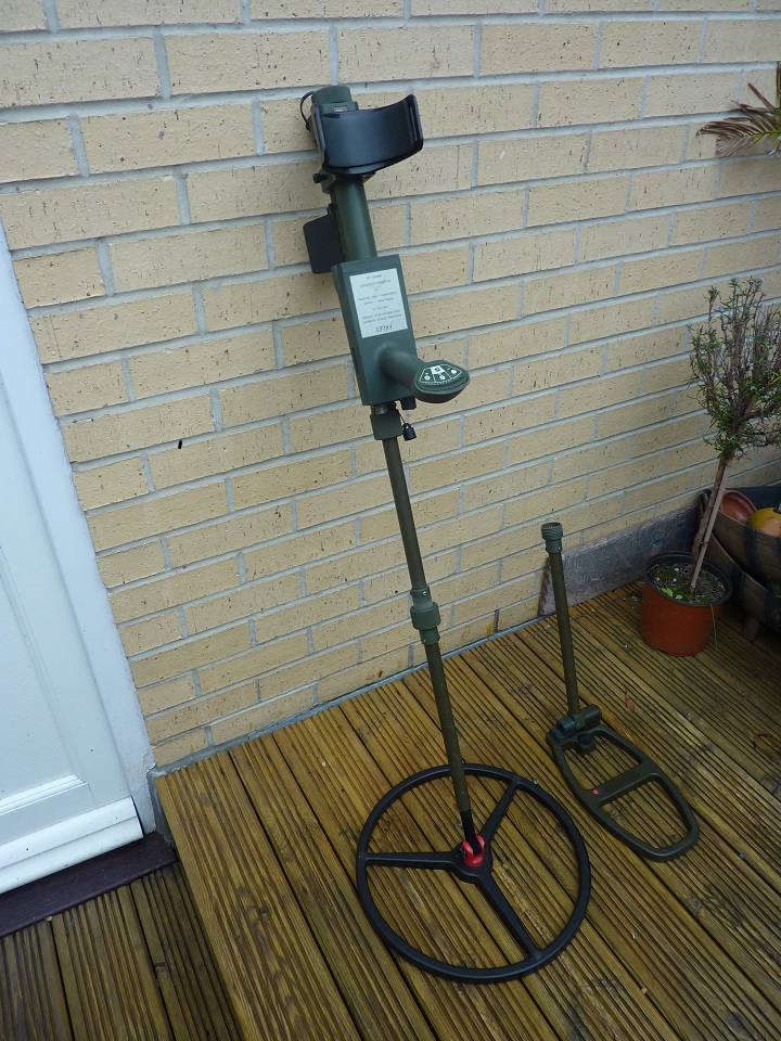

                      • 15 inch search coil for VMH3CS
                        This is what the VMH3CS will look like with a 15in search coil. The standard coil is there for comparison and I will be surprised if there is not a significant performance gain with coin and ring size objects. As yet there is no coil winding, as I have to make a winding jig and I expect there will be quite a bit of fiddling around to get it to work properly once I have made and shielded it.
                        The rod end for the coil swivel is a standard Whites type with a sleeve to fit the bore of the Vallon shaft. This shaft is off a broken coil and is the only one I have, so there is a problem making more coil assemblies unless I can get more broken coils with intact shafts. Hundreds must have been thrown away but I am searching around.
                        I will have to take the coil coax out of the coil and back into the shaft, keeping it sealed of course, but that should not be a problem. I will use a piece of the Vallon curly coax, as I have some of that spare.
                        Eric.

                        • Hi Eric
                          That 15” coil is a great looking setup. I am looking forward to your test results.
                          You previously mentioned that the coil resistance and inductance is critical. Do you think a spider wound or similar coil with less capacitance and/or less capacitance in coax would pass the internal checks?
                          Have a good day,
                          Chet
                          • Originally posted by Chet View Post
                            Hi Eric
                            Have a good day,
                            Chet
                            Many things about this detector are outside the accepted knowledge of PI. The coil wire is 0.53mm solid enamel plated, wound in a tight bundle. The Scotch 24 tinned copper wire mesh shield is not spaced off to any degree. The capacitance of the cable to the coil is about 300pF which together with the 2mH inductance gives a lower resonant frequency than what would normally be used for a 'fast coil'. All this leads me to believe that low capacitance coils may not work, and if they do, there will not be any advantage in performance.
                            Eric.
