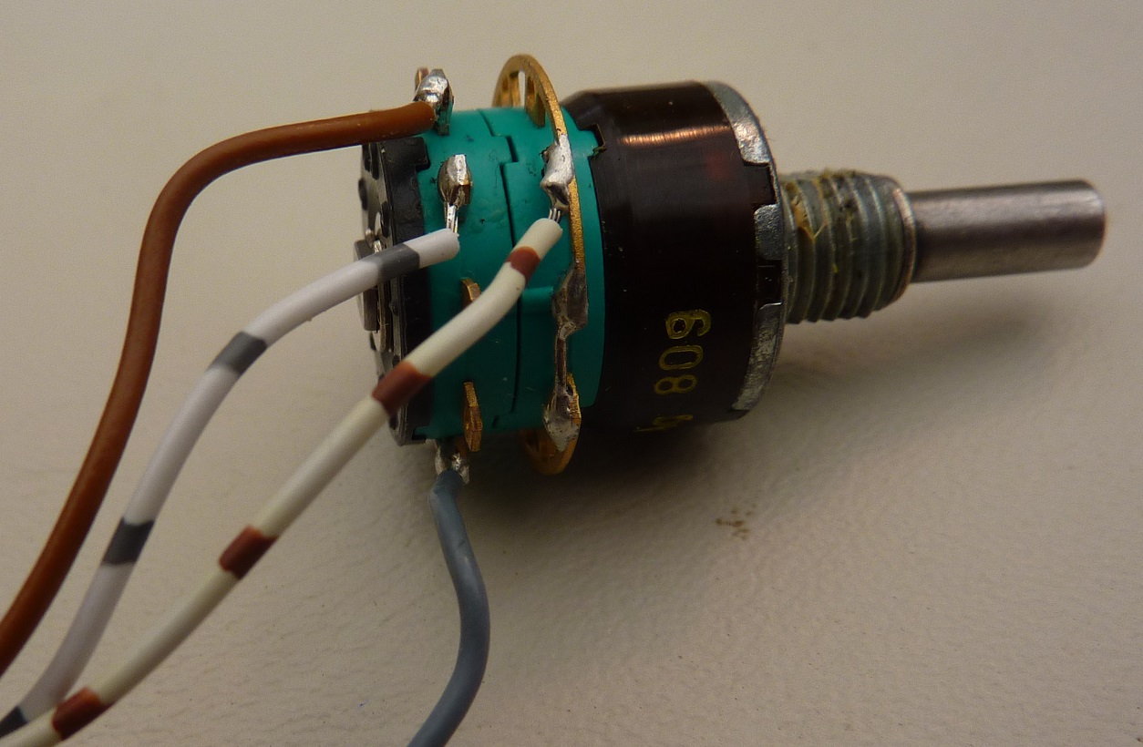

    I encountered a problem, the selector was turning without unscrewing.
    The wires have broken.
    I am now looking for the connections of the wires:
    Brown
    Grey
    White brown
    White gray
    Depending on the position of the selector:
    off
    Normal
    Mineral
    HP
    And I do not see how to put down this contactor.
    I hope you will answer me, but already thank you for reading me.
    • Edit.

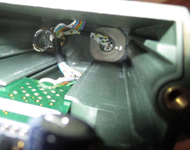

      Selector is down.
      • This will help. The grey wire goes to three terminals that are linked together on the switch.
        I had the same problem myself with one Vallon that had the same knob and knob shroud. However, I bought it cheap as a 'not working' unit and when I fixed the wires it worked fine. Getting the nut off the switch was a big struggle but a drop of WD40 left on the thread for a while seemed to loosen it up. There are supposed to be flats on the hole in the box to stop the switch rotating and also the original escutcheon that ran between the 6 pin connector and the selector switch also had flats in the hole and a much better fixing nut that protruded further.
        Having fixed the wires I did have a problem tightening the nut enough to stop it rotating again. It really needs a locking washer behind the panel instead of the rubber seal. OK as long as you are not planning to take the control box into water.
        Relocating the switch is a test of patience. I poked it around with a wooden stick until the shaft dropped into the hole.

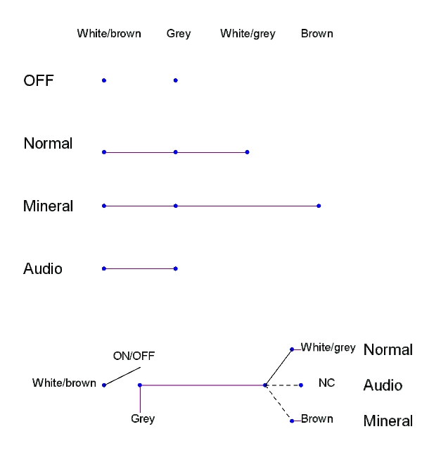

            • To remove the rotary switch:
              Place it in the earphone volume adjustment position, lock the shaft with a pliers and unscrew the nut.
              The rotary contactor connections are:
Name:	Schéma inters.jpg

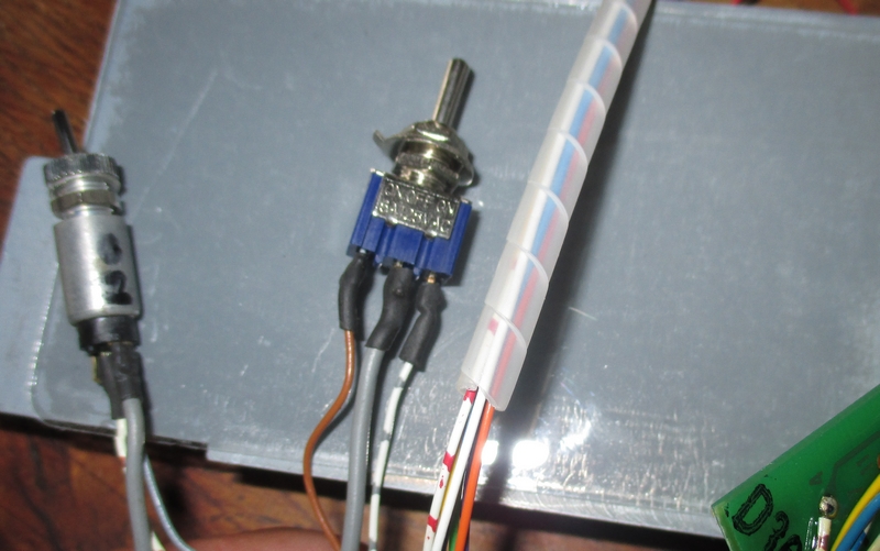

              I replace it with switches with waterproof caps.
Name:	Photo inters.jpg
