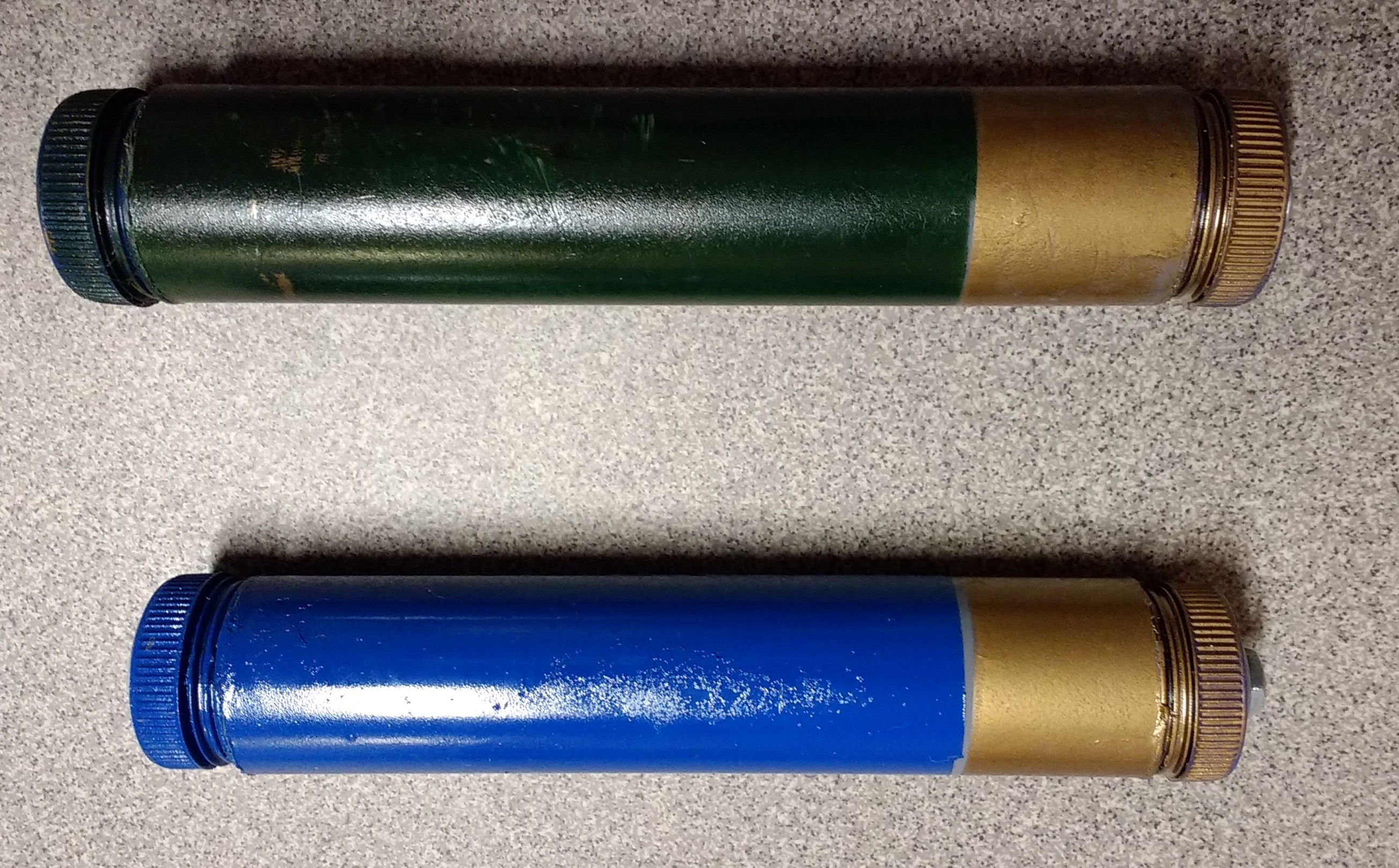

                              • Just a short update on the battery mod I did on the VMH3CS.
                                Instead of putting in 3x D cells in series, I made up a battery tube from a 32mm drain pipe and 2 x 18650 LiIon batteries in parallel.
                                No protection on the batteries - charged with an external charger.
                                I have 2 of these tubes and I use them alternately. This went fine for 7 years, until I dropped in one of the battery tubes upside down.
                                Click image for larger version  Name:	battery_10.jpg Views:	0 Size:	984.0 KB ID:	425958
                                Inside the VMH3CS battery tube, there is a small recess at the positive pole side, that allows for the protruding + pole of a battery to make contact, but not the flat sided negative pole.
                                On my quick and dirty home made tubes, both + and - connections contain a small screw, and this screw head on the negative side was sufficient to make contact to the VMH3CS positive connection.
                                So, a direct connection of + and - reversed batteries without current limitation, resulting in a catastrophic failure.

                                I contacted Vallon in Germany via email and they confirmed in a friendly reply that my assumption was correct.
                                In the mean time I had already replaced this destroyed component with a 1N4007 diode + some wire over the burnt trace.
                                After this repair, the detector was working fine again.

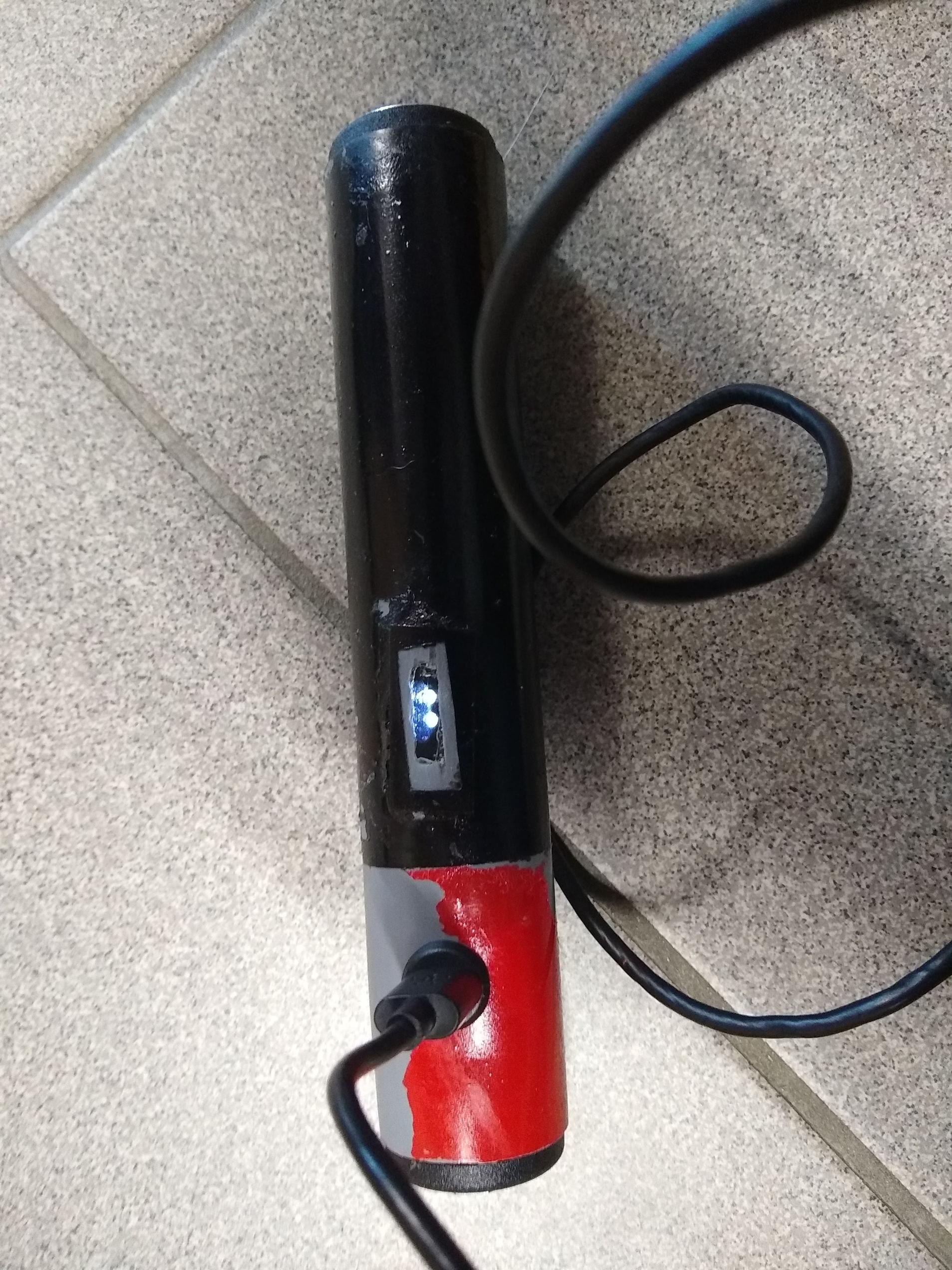

                                To avoid these kind of stupid "accidents", I built a new battery tube from a cylindrical Anker powerbank.
                                Click image for larger version  Name:	powerbank1.jpg Views:	0 Size:	64.0 KB ID:	425955
                                This delivers 5V output to the detector, resulting in a very happy beep and all LEDs lit at switch-on.
                                Click image for larger version  Name:	powerbank3.jpg Views:	0 Size:	783.6 KB ID:	425956
                                I added a small "window" in the drain tube to view the 3 LEDs during charging + an external USB-C connector.
                                The + and - connection of the battery and the USB-C charge port were connected with the USB cord cut in 2 pieces ( USB-A and USB-C) that was included with the powerbank.
                                I also tested that the 5V output is short-circuit proof.
                                Here is the Anker tube charging via the USB C connector --- the paint job has gone terribly wrong:

                                Well, lesson learned: when replacing the 3D cells with an 18650 combination, add some protection around the batteries.
                                Or better yet: use a cheap 5V powerbank, as suggested here in the thread already on a number of occasions.
