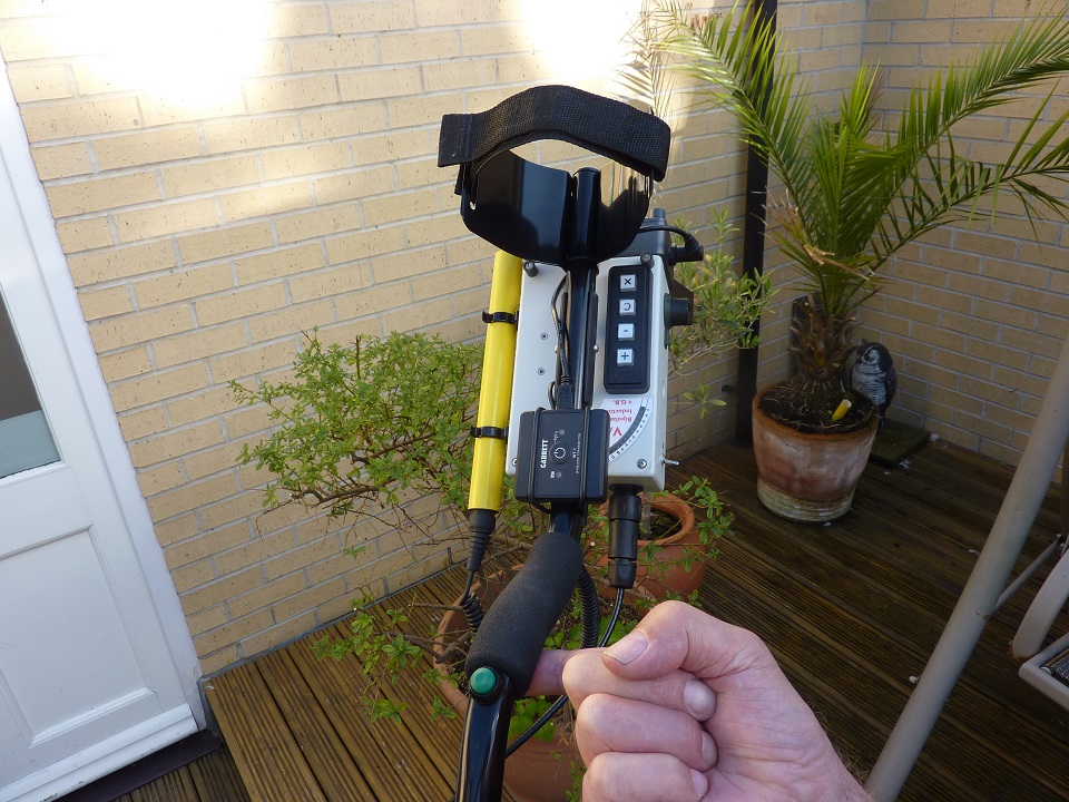

        • The Bridport Beast
          This is the ultimate predator. I have added a Garrett Z link, a push button by the hand grip and perfect balance. The Z Link works great with no noticeable delay and good tone. The C button on the handle is for quick compensation and has all sorts of functions in combination with other switch and button settings.
          Eric.

          • Well sir, that didn't take long!!! Will show Clay. I like it!
            Carolina
            • Great work Eric, that's a nice looking bit of kit!
              Brian
              • Looks good eric
