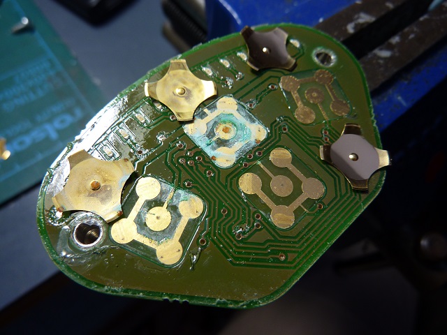

    • I've found the cause of Justin's problem with the control panel. If you look carefully at the picture in post 1346, you can see a green tinge on the edges of the - and C switch mechanisms. Removing the other layers so that the switch actuators can be removed, exposed the following.
      I had previously noticed that the top label had lifted a bit along the left hand edge and I would guess that water got in and caused corrosion of the spring steel top contacts. Only the underside is gold plated but the corrosion has crept there too. The contact with the brown dots should be for the middle C switch and that was completely inactive as you might guess. The - switch worked now and again if you pushed hard. The board should clean up OK and I could use it on one of my variations that use external push buttons or toggle switches.

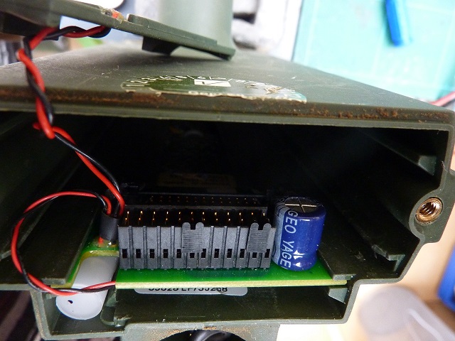

            • Vibration does not work.
              There are three ways for turning vibration on:
              1) press - before and during switching on and let go => should give vibration only but detector seems to be dead (like no battery)
              2) press - and C before and during switching on and let go => should give vibration plus tone but gives tone only
              3) press - and C and + before and during switching on and let go => should give vibration plus tone plus LED but gives tone plus LED only
              My conclusion is : the switches on the panel are OK but the stick-shaker/vibration device not(including the possibility of broken leads or a defective chip).
              Eric could you please confirm this diagnoses is correct.
                  Yes, your switch on sequences are correct. The vibrator is a small motor with an off centre weight on the shaft. It is clipped and cemented in the main box close to the left hand bolt that holds the battery bulkhead. It has two very fine leads, the far ends of which are soldered to a circuit board under the main electronics module. The picture shows the vibrator which is the white cylindrical object.
                  You can see where the red and black wires are attached to the circuit board just to the left of the 24way connector. The main electronics has been removed in this picture. Note that there is heat shrink sleeving and epoxy over this joint to give it extra support and stop wire breakage at this point. This is a 2010 model and from the earlier models I had, I noticed that this reinforcing was absent. Obviously, breakage was a problem and as yours is a 2007 model, this is the likely cause.
                  Personally, If the detector performs all the other functions OK, I would not worry about the vibrator leads as it takes quite a bit of dismantling to get to. I do not use it in any seaching that I do, and it uses a bit more current unnecessarily.
