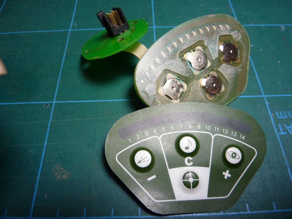

                        Hi Dutchie,
                        Here is a picture of the panel with the top layer removed. Underneath is another layer which covers the LEDs also. Below this second layer are two other layers, but have a full arced cutout for the LED's and don't provide further protection. These last two layers are to hold the switch parts in place.
                        Presumably your no.9 LED is still functioning? I had one unit where the puncture had gone through and broken the LED. I wasn't bothered as I bought a few units very cheap just for spares as they were otherwise unsellable.
                        The one I am dissecting in the picture is from Justin's machine where I am trying to find the fault that prevents the buttons working properly. I don't fancy my chances though as it is all microcircuitry with a programmable chip. The board has been replaced in Justin's unit and it's on its way back.
                        I will check tomorrow how well my polycarbonate adhesive film sticks to the top layer.
                        Eric.

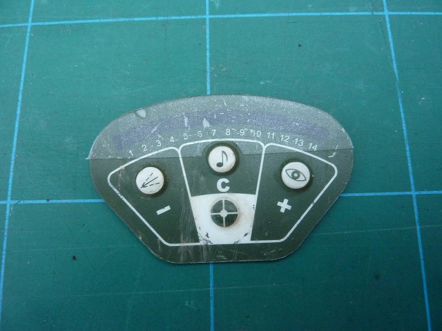

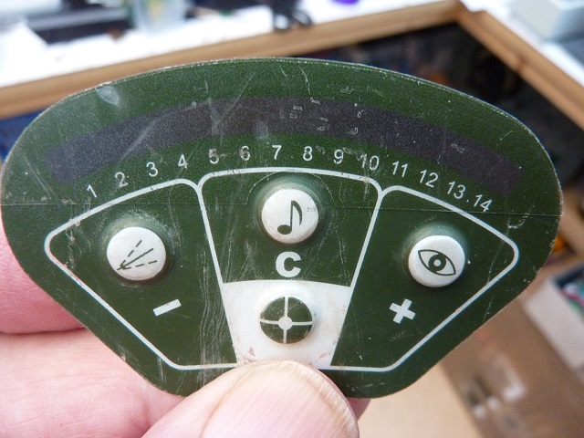

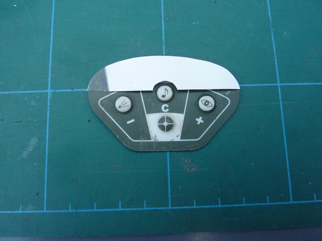

                              Hi Karel,
                              There is no fabric or cloth in the display panel. The pictures show how a hole can be fixed with label laminating film. The film is a matt one, but as you can see, the numbers show clearly through it as do the LEDs when they are lit.The top label I used is very scratched and the scratches show through as well.
                              First I cleaned the area where the film will be stuck with methylated spirit. I then drew the profile I wanted on the backing paper, then cut out with sharp scissors or scalpel. The push switches must be clear of the film, particularly the C switch. Peel back the paper a little way on one corner and cut the paper off as shown. This allows you to align the laminate easily. When it is correct press down that corner with the exposed adhesive. With the laminate anchored, progressivel peel back the remaining paper, smoothing down on the top label as you go.
                              You should end up as the second picture which was angled to the light so that it could be clearly seen. The third picture shows how the eye would see it, as barely perceptible.
                              Eric.
