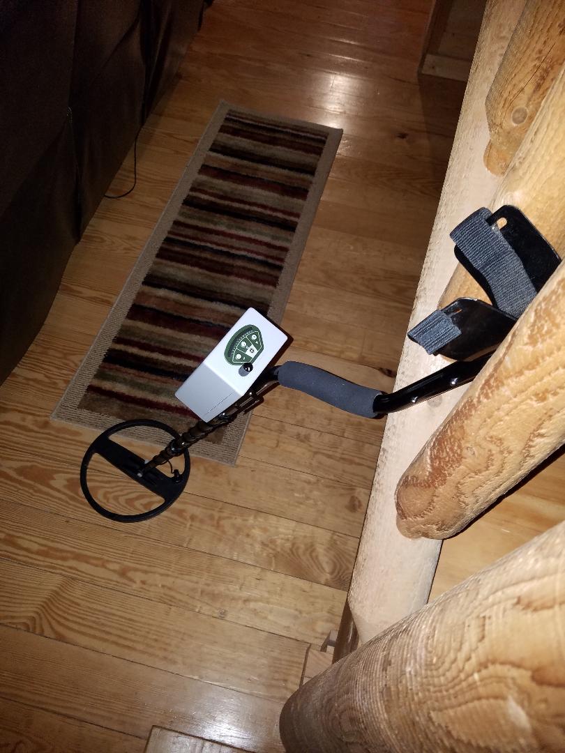

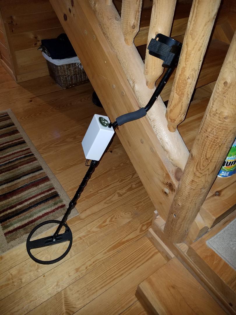

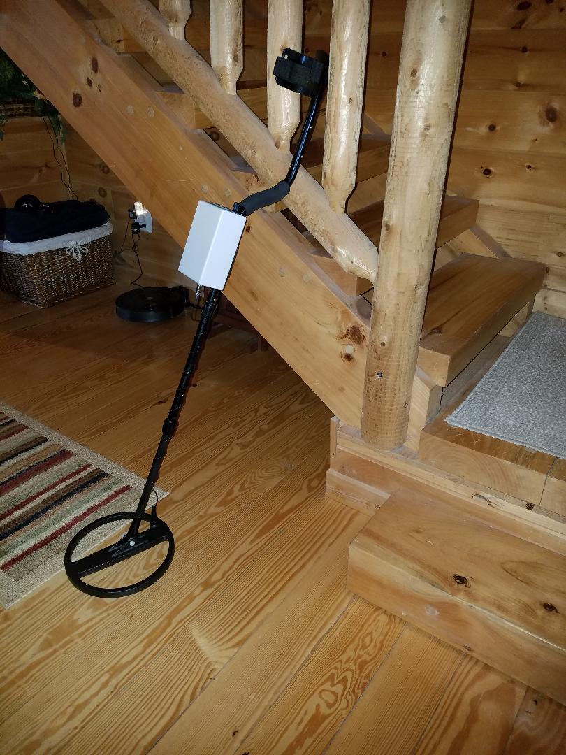

        • New Home for Test Environment
          I have put the Vallon test environment in a proper case.

            • I have put the Vallon test environment in a proper case.
              Nice
