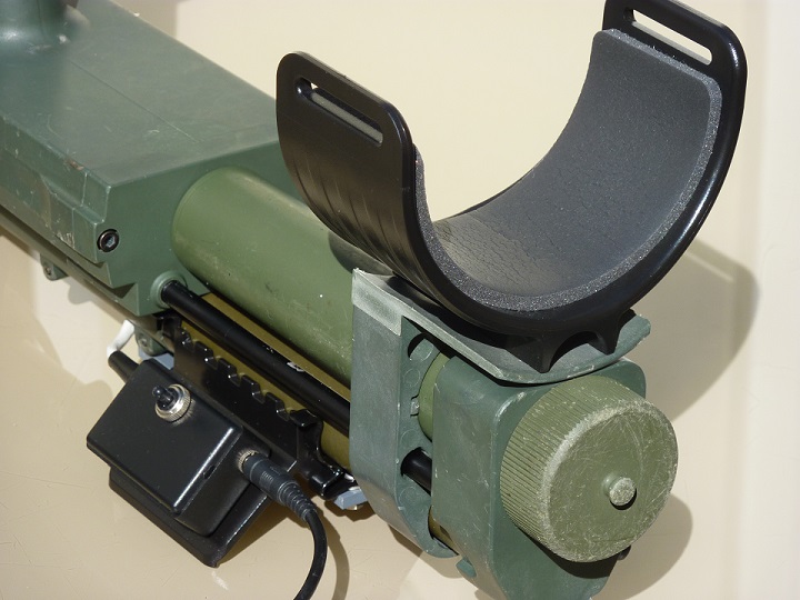

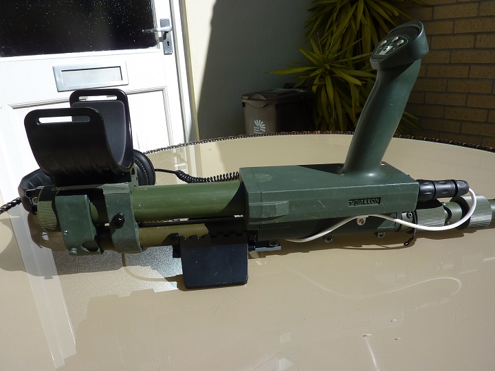

        • Latest Audio Converter
          Here is the latest version of the audio converter for standard moving coil headphones. A switch has been added so that the internal speaker can be used instead of phones if quiet conditions allow. i.e switch toggle pointing away from phones socket is internal speaker only: switch toggle pointing to phones socket is for phones only and speaker is muted.
          A 100nf capacitor has been also added in series with the transformer primary to eliminate the 'thump' on each audio pulse when the detector is self testing and also on the 1 second 'confidence pulse'. This is necessary because the moving coil headphones have a much extended low frequency response than piezo ones. With the phones set to stereo and connected in series at the socket (common ground not used), either volume control can be used to reduce the sound level, which is more than adequate when turned right up.
          Eric.

          • That looks great Eric. On my unit I didn't want to source a connector, so I used the factory audio cable/connector. What I noticed is the external speaker is muted when the connector is plugged even with nothing connected to the two wires. In other words using the factory headphone cable and connector, you can't have the option of toggling between speaker and headphone as you have done. I suspect there is a load resistor or some kind of jumper potted in the connector? When I get time I'll pull mine apart and take some ohm readings.
              Hi Altra,
              Yes, in the Vallon connector there is wire that links pins B and F. This mutes the internal speaker. According to the manual, F is ground and C is live to the piezo phone. In my commercial connector the link from ground to B is provided by the switch on the small box housing the transformer. You can do it with three wires in the cable.
              Eric.
