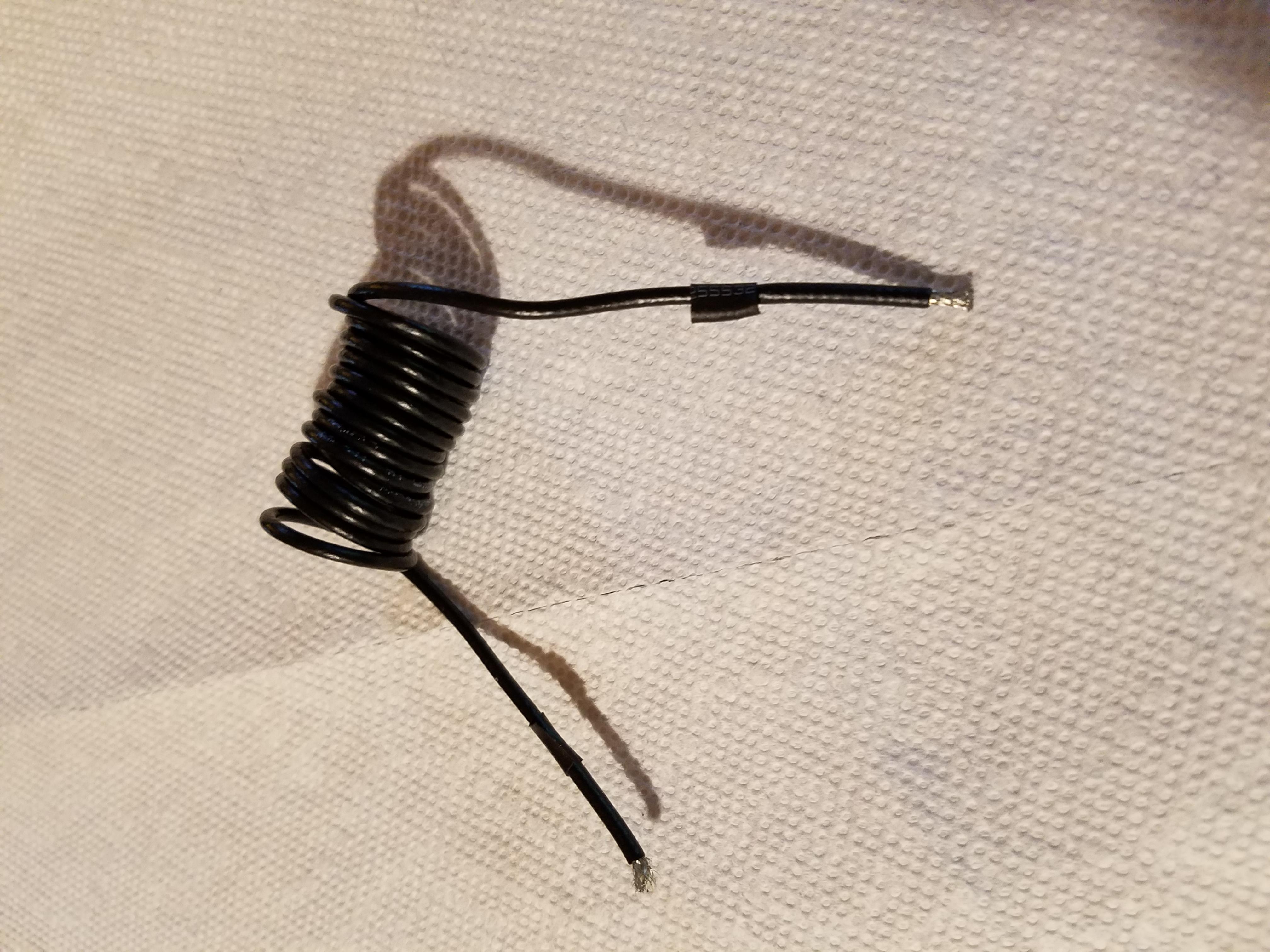

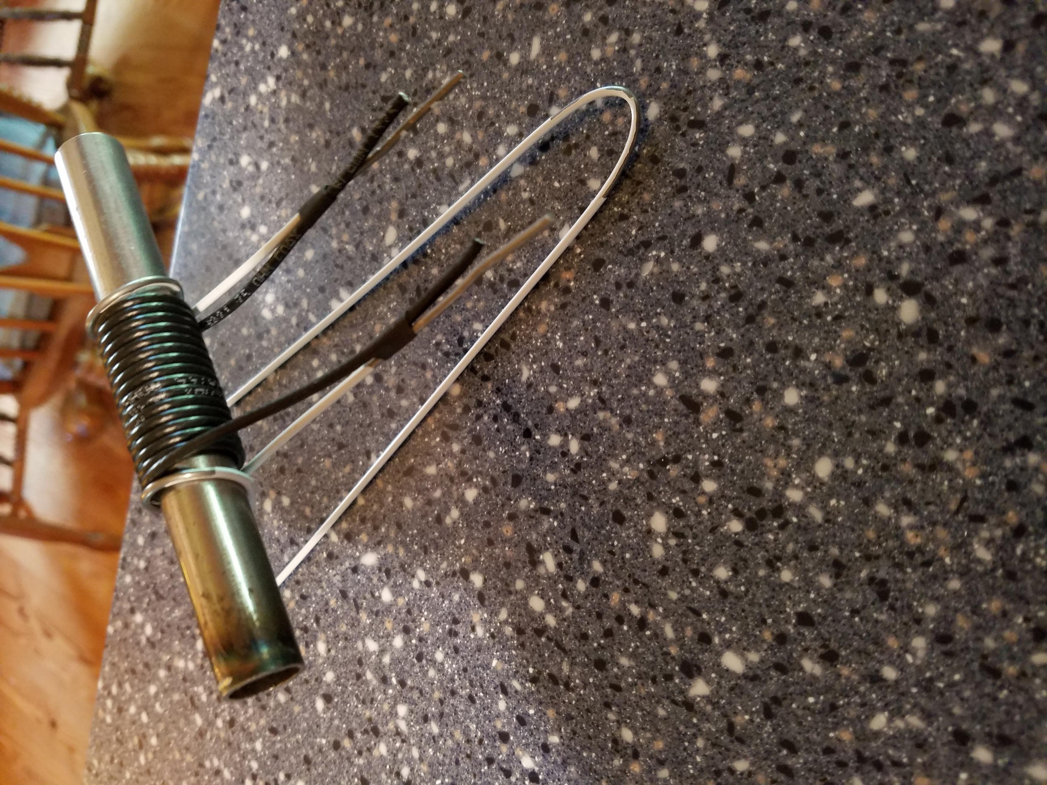

                              • Success!
                                Eric,

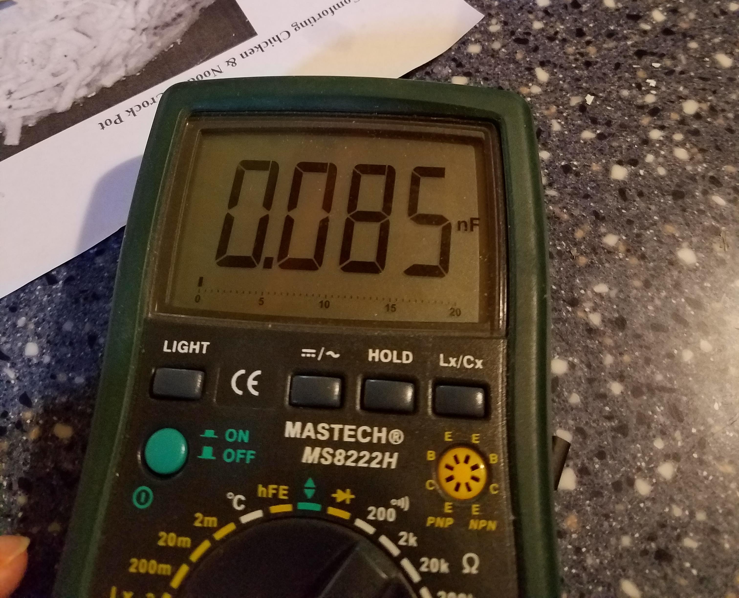

                                Just made a curly cord with Belden 9221 coax cable using Sean's method (modified)... 20 min @ 250 deg F (121 deg C) (in my wife's kitchen oven).; 20 min in freezer... results: 1 meter curly cord, 1/2" coil inside diameter, 85 pf (measured).
                                The form fixture:

                                after oven,freezer treatment and taken off form:

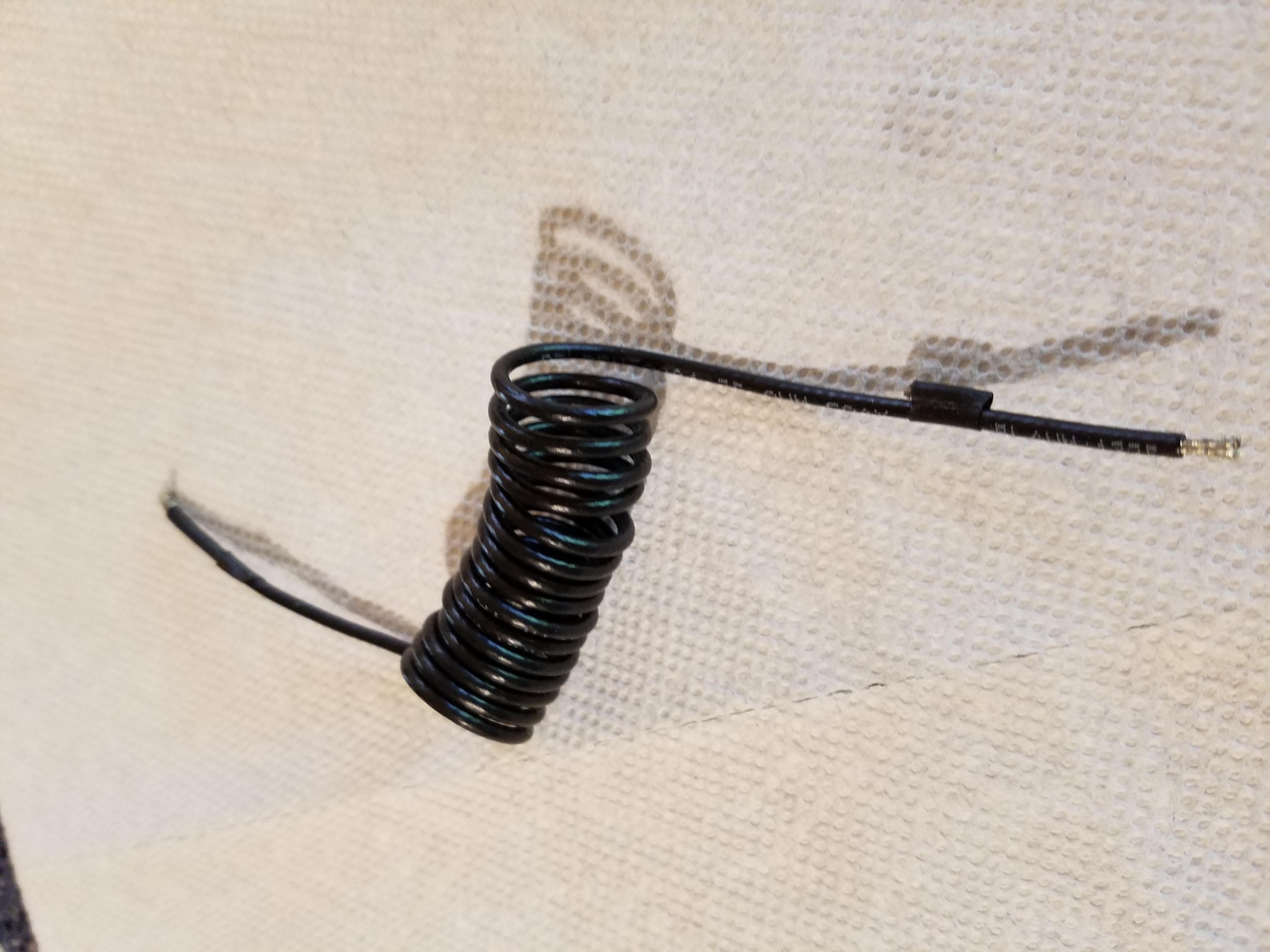

                                after turning inside-out; the coil tightened up:

                                now to measure the capacitance:

                                I think I will make about 3 more of these... I got 20' of Belden 9221 cable with BNC connectors on each end. I will keep the BNC ends with 40" of cable and use the rest for 1 meter curly cords!
