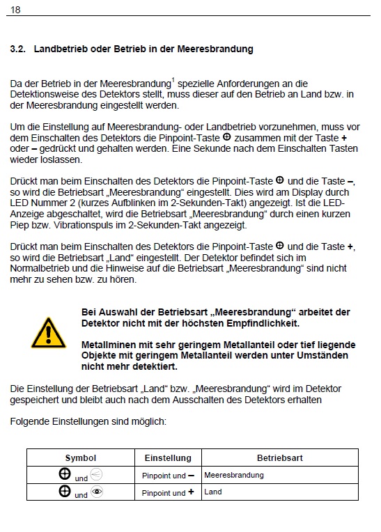

                  My Vallon cames with Surf mode/ salt water mode switched on (LED 13 glow every 2 seconds and you hear a blip, in Mineral setting you hear 2 blips). The Question is how to switch it off, because I have no salt water near me. Pressing the "minus" button and pin-point while turnig machine on does only change the indication to LED only (no sound, no vibration).

                          • Originally posted by mschmahl View Post
                            This is the same for the VMH3CS.
                            You cannot switch off LED 13 and the blip (1 or 2) every 2 seconds. This is a confidence signal that the detector is working, which is something you definitely need to know when looking for mines. To warn you when you are in mineral mode where the machine behaves a bit different, you get two blips. As there is no background threshold sound there is no way that you would continously know that the detector is working properly or not, without the blips.
                            If you have surf mode then, according to the manual, LED number 2 does a short flash every 2 seconds, but the UK ones I have do not appear to have this facility. I have not tested them all however, but from my tests on the beach you do not need it.
                            Eric.
                              [ATTACH]38804[/ATTACH]
                              In paragraph 3, in German, "LED nummer 2", followed in () by (short flashing every 2 seconds). Could you have counted the LEDs from the wrong end? 1 - 14, starting from the left is correct.
                              Eric.
                                Eric.
                                You are right Eric.
                                I the LED that is flashing is LED 13. On my older Vallon (without Pin-Point Button) there does no LED flash. Maybe it was programmed in a later firmeware as security-indication. The older Version is silent if you have set it up right.
                                Thank“s for clarify this.
                                I will do some depth test with both Vallons, so they should get the same distance.
