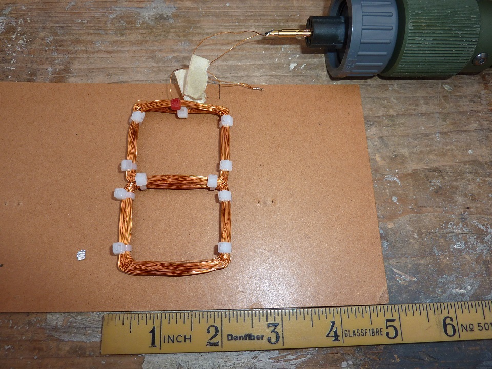

            • Foil and Coil Tests
              Wanting to do some waveform tests free from noise, I constructed a small Fig. 8 test coil. This was made of of two windings left over from some industrial sensor work a while back. The windings are about 350uH each and by putting two, one on top of the other, I managed to achieve 1.36mH, which I didn't expect to work on the Vallon as it is rather low. Additionally the resistance was too high at over 6 ohms due to the thinner wire used. I was quite surprised therefore, on power up test, that the coil checked OK and the Vallon was alive.
              The next thing I wanted to do was some more tests on kitchen foil that I had started earlier. I cut a piece 1in square (25.4mm) and found that I could detect that at about 1 in above one side of the coil. Wanting to start with a size of foil that was just not detectable, I cut the foil down to 20mm square. [From here on I stuck with metric for the foil]. I then folded the piece in two to give 20 x 10mm and found that it was just detectable above the coil. Second fold and the range was an inch. Third and fourth fold and the range was up to 1.5in. Fifth and sixth fold and the range was dropping but still 1in when the foil was 2.5mm x 2.5mm. The folded thickness ended at 1mm.
              This is interesting because the mass of metal remains constant while the surface area reduces and the thickness increases in proportion. This begs the question on how realistic is the kitchen foil test in relation to what we are looking for? The sensitivity of industrial metal detectors, are tested by using ferrous and non-ferrous spheres as this gets rid of the orientation problem. Metal cubes and cylinders are also used, where l = d in the case of a cylinder.
              I shall be using this small fig. 8 coil to look at the object signals at low levels free of noise, although I shall use my preamp across the coil as the Vallon one is inaccessible.

              What looks like a solder splash is the folded piece of foil.
              Eric.
