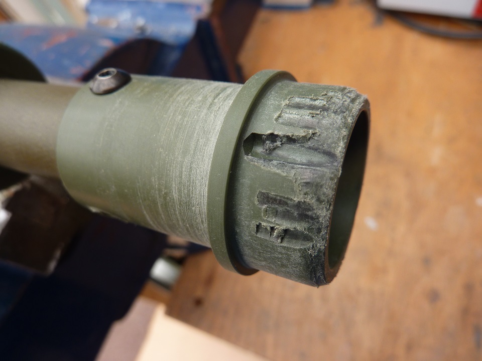

    If your coil shaft and connector is difficult to align in the keyway in the upper shaft, don't give up. A little force may be necessary, but it will go in eventually. A push from a passing tank may help, but in this case it broke off the outer collar.

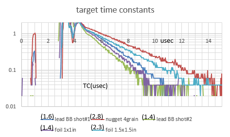

                            Used a lead shot(BB split shot, fishing wt. pinched closed) to try with the detector I'm making. Charted some target time constants. Two split shot from different packages, 4 grain gold nugget, 1x1in aluminum kitchen foil and 1.5x1.5in aluminum kitchen foil. Reply #159 Eric could detect a 1.5x1.5in aluminum foil but not 1x1in aluminum foil. The time constant for the 1x1in aluminum foil and the BB split shot are close. I was thinking he couldn't detect the 1x1in aluminum foil because of the short time constant. Could you try a piece of aluminum foil 1x1in? I used Reynolds wrap regular strength not heavy duty. I got a little difference between the two split shot and foil thickness could be different. Wondering if there are reasons the split shot could be detected and not the 1x1in foil.

                              Interesting! I did try 1x1 inch foil ages ago and couldnt detect it...maybe its because the lead shot is round so is more dense??

                                Thanks, might be my error. Looked up shot size and a BB was .55g close to what you had(.6g) so that is what I tested. Just looked up BB split shot, .4g. I'll try to get a lead ball close to .6g and try again.
