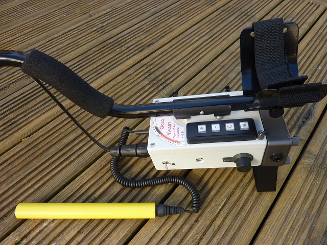

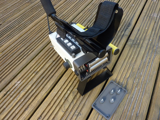

                  • Here is the probe that has been added to my re-boxed Vallon. The toggle switch changes from main coil to probe, and it works without the detector going through its start up sequence again. It is a 2 pole changeover switch as you need a 1k damping resistor across either coil when it is not used. This is to prevent ringing being induced.
                    The other change is that the batteries are now in an additional rear box which makes them easy to change. The space vacated by the batteries in the main box now incorporates a speaker, and phones are now from a 1/4in jack on the battery box. The speaker is muted when phones are plugged in.
                    Eric.

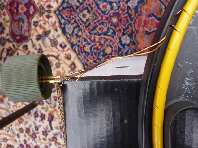

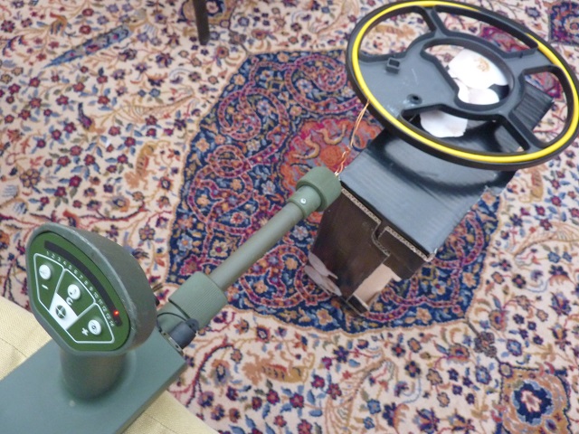

                          Hi Stefan,
                          I have just wound a 28cm coil but not shielded it. It has 44 turns of 0.53mm enamelled wire (solderable); a measured inductance of 1.51uH and a resistance of 3.2 ohms. I connected it to a VMH3CS as in the pictures, so there is an additional 0.6 ohms in the coiled cable in the top shaft. It worked perfectly at the default sensitivity(12), with only an occasional flash from the No.1 LED and very rarely the No.2 LED. The illuminated LED is the confidence one. The channel that the detector is set to is 4/13. I will shield it tomorrow and am reasonably confident all will be OK. I am going to try silver fabric tape this time.
