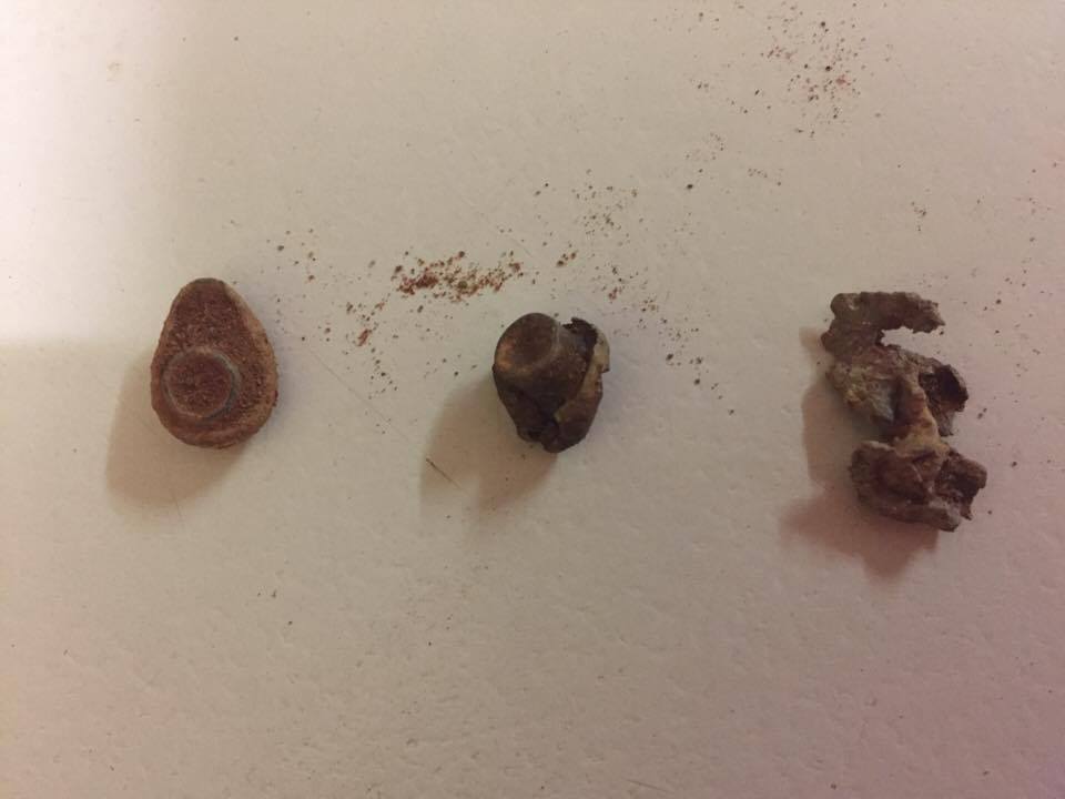

          • Few hours out this morning near an old open pit gold mine.
            Used the 30cm coil with good success. Easily to GB and no false signals like it did previously. I think it works much better with a faster swing.
            Found numerous bits of trash. Most promisingly, detected 3 smashed up bullet leads....one 2.8g, one 2.6g and a really smashed bit of 1.6g. Gave awesome signals and all were at about 2-3 inches.
            Gold cant be far away

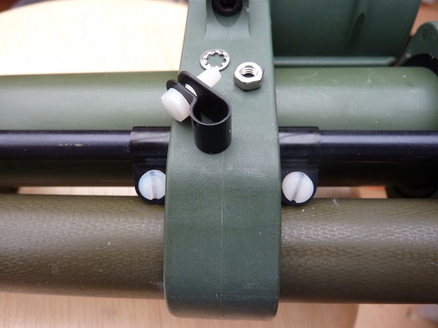

                            • Armrest restraint
                              Here is another solution to prevent the armrest shifting position. I used a 6.5mm P cable clip, with a nylon 4mm bolt and stainless steel lock washer and nut. I would have used a nylon nut, but it is not something I have in stock.
                              The 6.5mm clip is a bit small for the 7.7mm tube, but the next size clip available from my supplier is 8mm and as they come in bags of 50, I decided to play safe. It locks the armrest nice and tight and position is easily shifted if necessary.
                              Eric.

                                Nice an simply solution, I like it!
