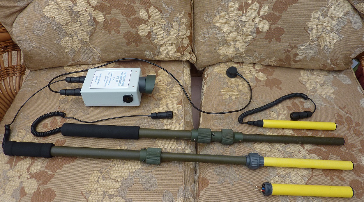

          • The Probes are coming.
            I have been trying various ferrite rods, probe configurations, and range comparisons with some interesting results. The first probe I made used a 4in x 1/2in diameter core which was housed in a Vallon telescopic shaft assembly from a broken coil. After experimenting with the wire type and gauge it worked fine and would detect a nickel at 8in. This is the full army green shaft below the yellow hand probe. The lower probe housing can be unplugged and changed for a standard Vallon elliptical coil or an 11in open round coil that I made.
            The yellow short probe with the coiled cable is a hand probe that can be plugged into the control box instead of a standard coil. This probe has the same ferrite core and winding as the first probe.
            The third long shaft probe uses a 6in x 1/2in core but with a series resistor, as explained later.
            The fourth probe uses a 4in x 3/4in D core in a larger diameter outer tube. This can be interchanged with the probe head that has the 6in core for comparison of detection ranges.
            All probes have been wound to an inductance of 1.8mH and a final resistance of about 3 ohms. The first probe was wound with Litz wire and gave about 3 ohms, but subsequent ones wound with 0.2mm Teflon wire only measured 2.3 ohms so a 1 ohm metal oxide resistor was put in the live side in series with the coil. The exception was coil on the 4in x 3/4 rod which came out at 3.3 ohms and didn't need any extra.
            The VMH3CS is quite sensitive to coil characteristics and there is obviously a balance between inductance and resistance, either of which if changed by a fairly small amount, the startup check fails and the detector not operate. I also check the current draw at 4.5V by using a bench power supply. The Vallon ellipical coil give a draw of 315mA, so I check that the probes also draw that amount
            Testing the range on a nickel and using the 4in x 3/4in core improved the range to 10in. I appeared to achieve the same range with the 6in x 1/2in core. The latter is probably of more interest as 3/4in cores are harder to find than 1/2in cores and the slimmer tube has a better appearance. Standard heavy duty pipe couplings were used to make the probes detacheable. Just a little machining was needed to suit the fibreglass tubing. Good job I still have my lathe.
            Given the good ranges on coins and rings I am going to do a beach search just using the probe with the 6in core. That way, as I dig, I can go right down in the hole without need for a pinpointer. In sand, a lot of time is wasted just chasing the target around so I hope this will speed up recovery.
            All the probes are (or will be) potted in polyurethane resin and the couplings are sealed, so immersion up to a couple of feet should be OK. Additionally there less water resistance than when sweeping with a standard coil.

              Hi Eric
              This is an interesting operating concept. I am looking forward to your beach hunt results. I am very interested in how well the small circular area of the probe responds to the salt and how well it ground balances.
              Have a good day,
              Chet
              • Originally posted by Chet View Post
                Hi Eric
                Hi Chet,
                I don't anticipate any problem with the salt as it appears that the sampling in the Vallon is quite late in time i.e 20 - 30uS. It it only when you go to <15uS that the salt signal becomes significant. At 5uS a PI detector is barely useable in wet sand.
                Iron mineralised ground is an unknown at the moment. The Vallon appears to be good with standard open coils but there comes a point in magnetic field strength where the signal departs from the 1/t^-1 law that ground balance relies on; which may occur if the probe tip contacts the ground. The end of the ferrite rod is about 1/8in in due to the thickness of the plastic bung in the tube end. I would think that scanning with the probe an inch or two off the ground is OK, but for down hole pinpointing it would be nice is there was no such non-linearity. The Victoria goldfields in Australia would be the best test as, in some areas, the ground is the most iron mineralised that I have come across. Soil from Red Hill, Virginia, USA, reads about 300 for a 10gm sample on the viscosity meter, while the same sample size from Wedderburn, Victoria, is over 1000.
                Eric.
