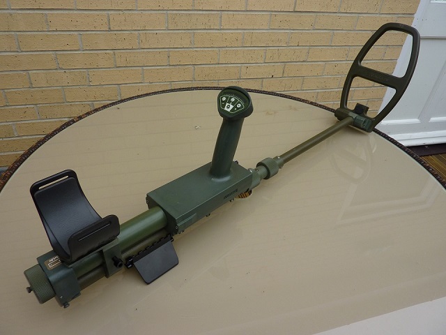

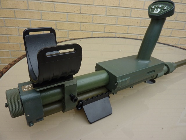

                • I have made some ergonomic improvements to the VMH3CS in the form of a proprietory armcup and a clip-on ground stand. The original 'rabbit eared' armcup base was retained, but with a small amount of machining, to fit the new stronger and better looking one. A 8mm nylon bolt was also fitted to lock it into place and stop the tendancy to slide up or down the battery tube, as it did previously.
                  Another useful bit of information is that I think I have identified the preamp chip in the electronics. It is a TI OPA627AU which described is a very low noise precision high speed Difet opamp. I look forward to getting a scope on the output sometime soon. Being a SOIC on a crowded board, that might be a bit tricky.
                  Eric.
