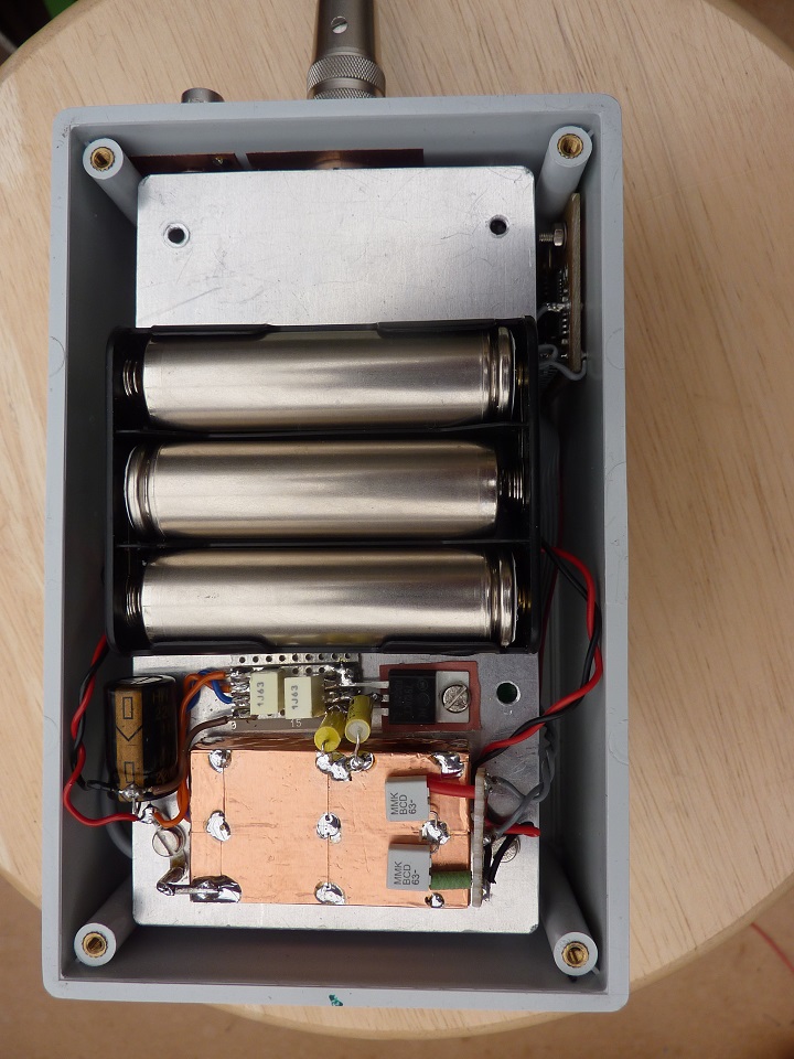

          There are quite a few variations on the market, but the one I chose uses the MT3608 converter.
          My MT3608 converters have arrived, nice little board will have a test of them later today.

                  • My MT3608 converters have arrived, nice little board will have a test of them later today.
                    Yes, there are a few problems I have come across though. The multiturn trimmer for adjusting the output voltage has quite a bit of backlash, so turning it one way, and then back, the action is not immediate.
                    Mine will not run on one of my bench power supplies, but the other (older) one it is OK. Batteries work OK
                    Small box shielded with copper tape seems effective in stopping radiated noise but I had a bit of a problem with conducted noise. Some good quality capacitors on input and output leads fixed that, together with a linear regulator and low esr electrolytic cap on the final output.
                    What I am doing here is taking the three series Li-ion batteries and setting the converter output to 15V. This I then regulate to 12V for the TX circuit. I need to do this so that the TX voltage remains constant over the range of battery voltage otherwise the calibration of my viscosity meter will not hold.
                    Eric.
