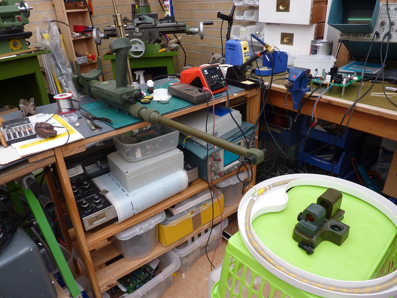

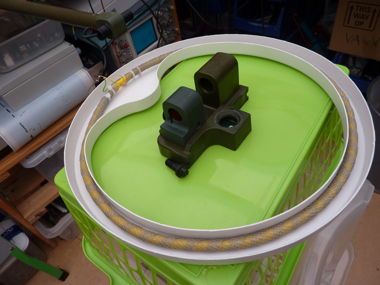

Today, I thought I would have a go at making a 11in coil for the VMH3CS. I used the same gauge wire and found that 50 turns gave a similar inductance to the standard truncated ellipse coil. I then overwound it with PTFE tape and then helical cable wrap to space off the shield. The shield is Scotch 24 tinned copper shielding and this went on quite smoothly when I anchored the end with tie wraps.
I had a spare bottom shaft and connected the coil to the internal cable. This is where I thought failure was going to spoil the day, as the detector signalled a fault. I put the scope across the coil wires and nothing was there. I then checked the continuity of the internal cable in the shaft. That was the problem. The shaft has a six pin connector and when I removed this, the cable was totally disconnected. Someone had tried to unscrew the connector and twisted the cable to the point where it completely broke. This took a while to fix, but when the coil was reconnected everything works fine. Great range, very stable - success. The next problem is purely mechanical: mounting the huge swivel assembly onto the coil shell. This has already been cut off a dud Vallon coil and it looks as a bit more work on the mill will be needed. The swivel is very good though as the cabling is internal and sealed. Just the job for shallow water hunting.

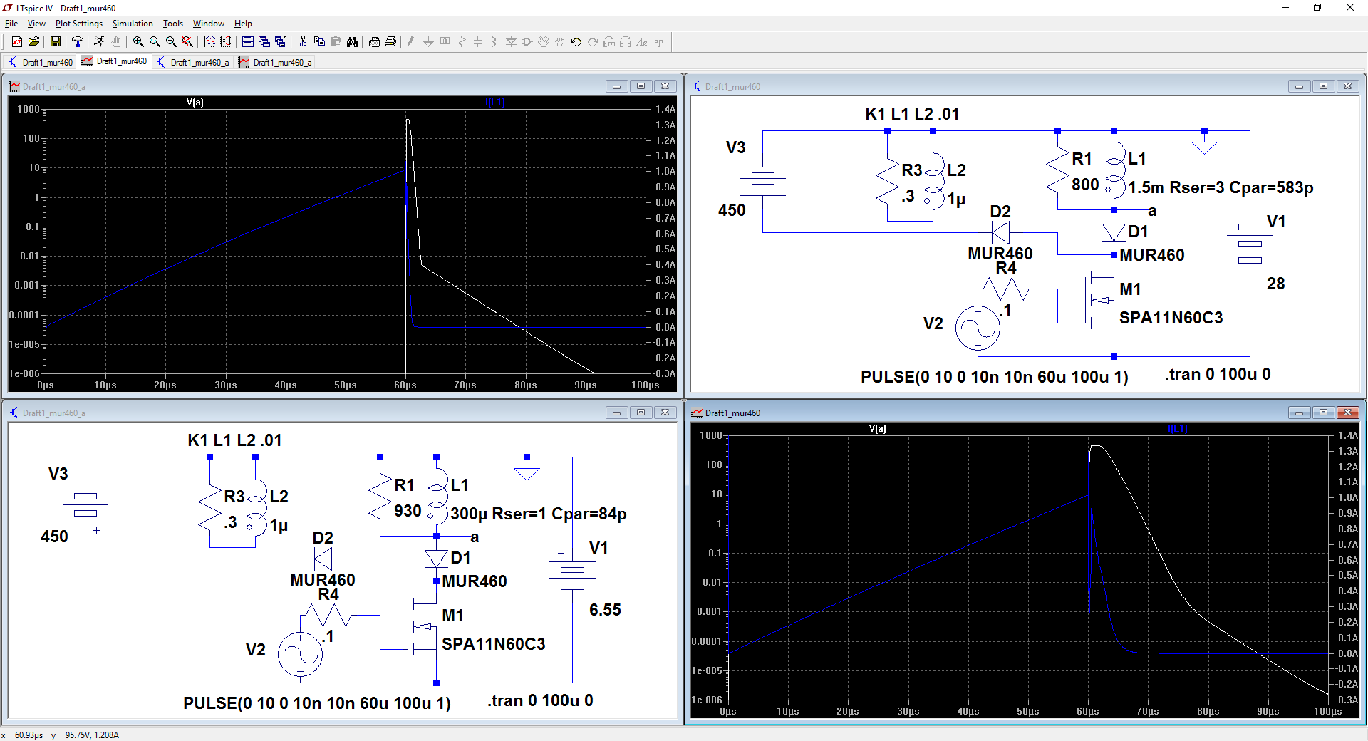

Did a simulation in spice. Don't know if it means anything since I couldn't enter coil diameter. Compared to coils, 300uH(1MHz resonance) and 1.5mH(170kHz resonance). Target TC 3.3usec which could be close to a .3gm nugget. Could see target decay on both simulations. Tested a 6x6mm piece cut from the bottom of an aluminum coke can(TC=3.1usec) and a piece 6x6mm cut from the side(TC=1.3usec) awhile back. Couldn't see the target decay on the 1.5mH coil simulation with a target TC of 1.3usec.Attached Files

Eric,Originally posted by Ferric Toes View PostToday, I thought I would have a go at making a 11in coil for the VMH3CS. I used the same gauge wire and found that 50 turns gave a similar inductance to the standard truncated ellipse coil. I then overwound it with PTFE tape and then helical cable wrap to space off the shield. The shield is Scotch 24 tinned copper shielding and this went on quite smoothly when I anchored the end with tie wraps.
[ATTACH]36214[/ATTACH]
[ATTACH]36215[/ATTACH]
Your use of Scotch 24 is very good to see as I discovered this stuff many years ago when doing independent coil research. Lead shields seems to have fallen into safety and health issues these days. I see that you chose to spiral wrap the double layer Scotch 24 around the coil. Another method is to cut it in a single layer a bit narrower than the coil cross section bundle circumference and put it on the coil as a U-shaped shield with the open seam on the top of the coil. This keeps the wire mesh shield from forming a shorted cross section loop around some coils that may be detected at low delays. I used this U-shaped shield method along with Teflon insulated coil wire for an 11" 300 uH coil used on your CS6PI low power PI design that I modified to operate at 13.5 KHz at about a 7.5 uS delay. This gets me about 14" on a U.S. Nickel. The spiral wrap shield method, however, may not be an issue with this VMH3CS mine detector coil where low noise and not coil speed is the main issue.
