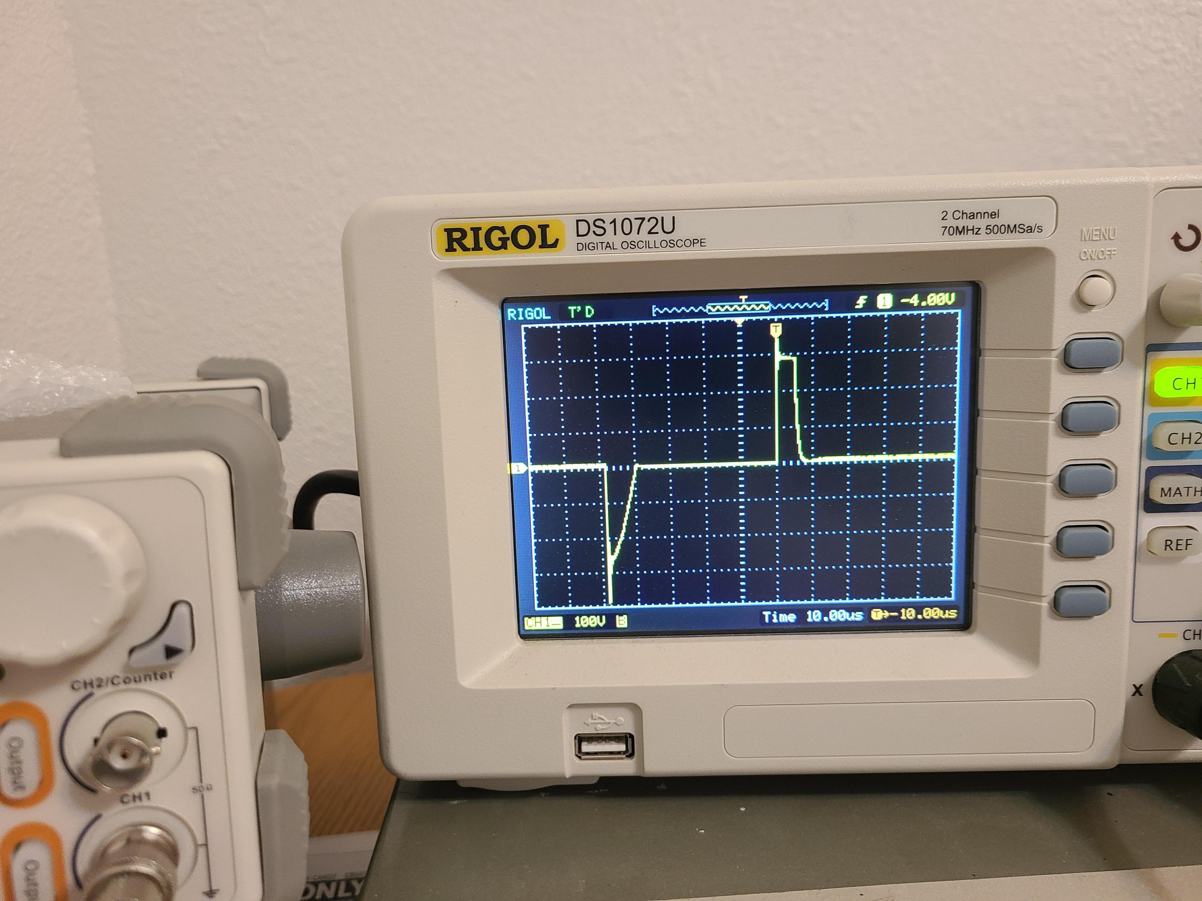

    I was using my probe at 6 inches from edge of the coil.
    Today I was finally able to get the cap off the coil and attach the probe directly.
    I measured the coil at 1.54 mH and 3.1 ohms but that was attached so not sure about the resistance.
    I measured SRF at 1.38 Khz.
    It looks like the coil specs are in line with the VMh3 coils.
    So should be able to make a smaller coil for it.
    Here is the Tx directly attached.
Name:	vallon tx direct.jpg
    Compared to the Vmh3 the Vmc1 is quite a bit different as far as the Tx ,10 us pulses versus 50 us and 40 us between pulses versus 500
    I'm still not sure if the different pulse forms are correct or if there is a problem with the gizmo.

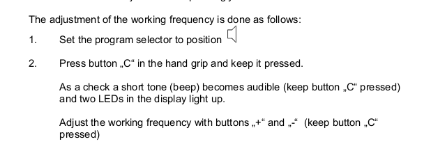

                    One thing you could try regarding the EMI on one of the Vallons is to check the channel settings to see if they are different.
                    On the one that is less affected by EMI set the mode selector to the speaker symbol. Press C and keep it pressed. After 3 seconds you get a short beep, but keep pressing C. Two LEDs should eventually light, 12 being one of them, but ignore this one. Note the LED number of the other one.
                    Switch off the first detector and go to the noisy one and repeat the process. If it settles at a different LED number, press either the + or - button so that the channel LED number is the same as te first detector. Switch back to the normal mode and see if the EMI is any better. Any channel change is stored on switch off, so on further use it will be the last change that you are working with.
                    If there is no improvement in EMI, then there could be a difference in the firmware settings of the two.
                    EMI is a problem for me in, or near, my workshop. No change in channel setting will cure it and I have not yet found out what the source is. Whatever causes it, goes off after 5.30pm and then the Vallons are quiet. It must come from an adjacent shop; maybe my wife's. I can hear it quite loudly on a medium wave radio and during the day it blots out all but the strongest stations. I use a 14in search coil as a loop antenna, so it is definitely the EM noise that plays havoc with the detectors. I'll have to find a portable radio with ferrite antenna and do some direction finding.
                    Eric.

                      Look at Eric's post #1186 to change channels.

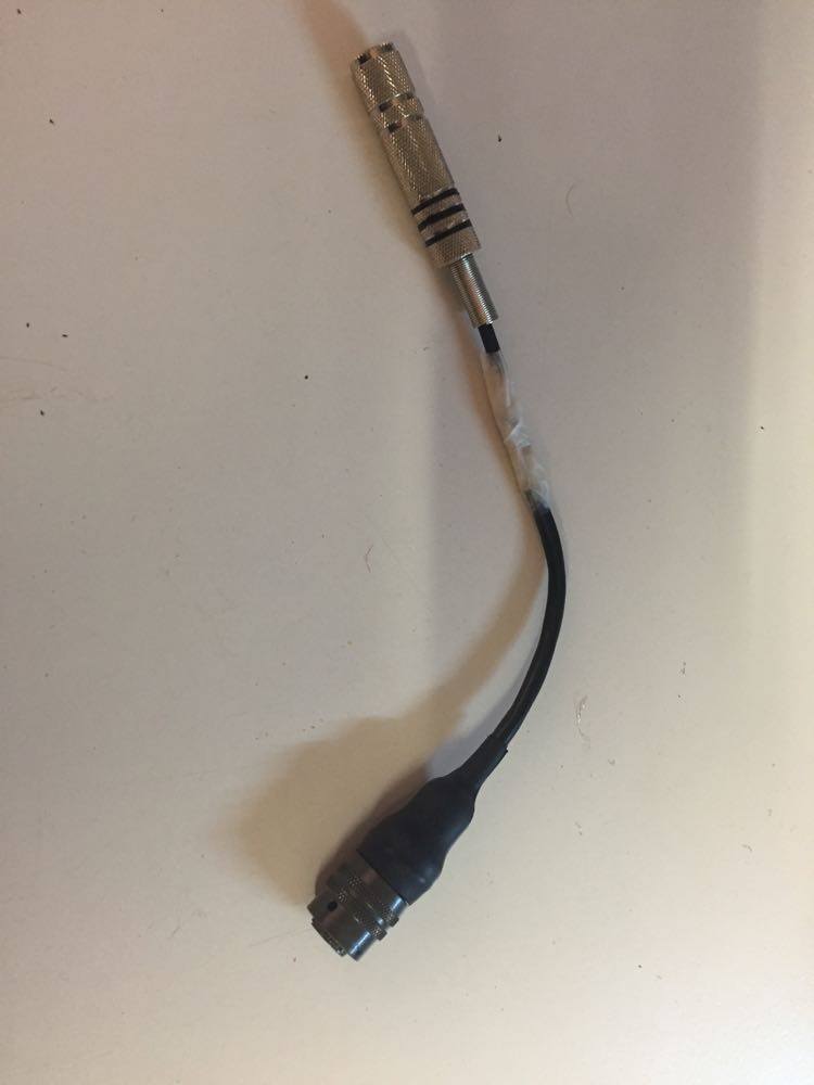

                      • My 10 minute agricultural nothing fancy audio fix
                        used a broken adapter cable I had from the sdc2300. Attached white and brown wires. Plugged into my booster via cable, its very loud thru dual detecting speakers!!! Used normal tape as was experimenting. Will solder and use electrical tape later. It works...loudly! Will try with normal headphones at some point. I dont generally use headphones when detecting anyway, so dual speakers would work for me. I am scared of wild dogs attacking me and would rather hear them before they jump on my back

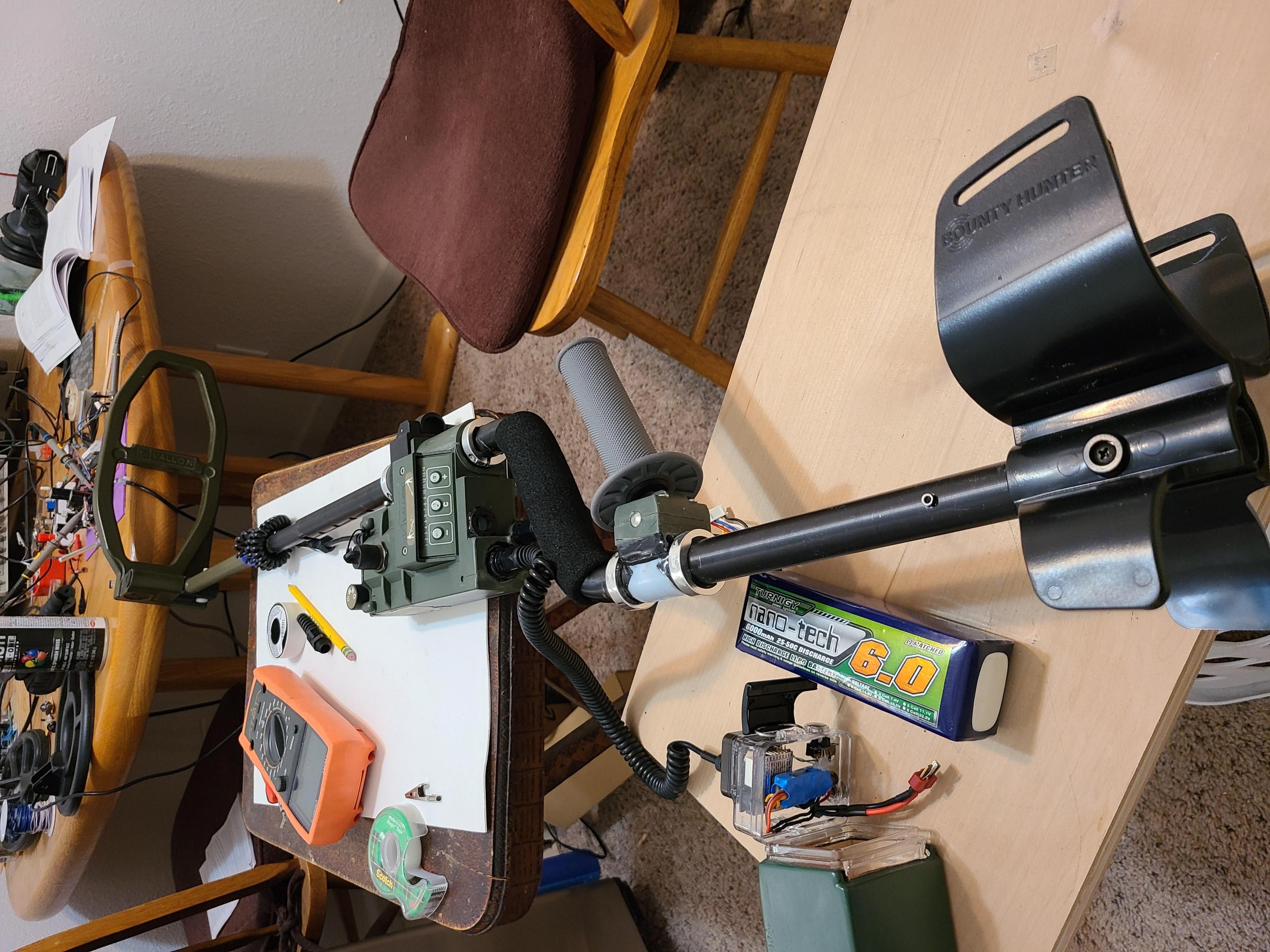

                                So I repackaged it.
Name:	borg vallon .jpg
                                my battery is a bit over kill and at the moment is waist mount eventually will be under arm cuff.
                                The whole mod with a 1and a 1/2 pound power supply is 5.5 pounds.
                                used a go pro case to make it water prof. 10 amp battery eliminator and battery monitor both fit in the case.
                                Just finished my first coil for it came up a little short at 1186 uh and 1.68 ohms but the gizmo accepts it so seems there some room to work with.
                                for kicks tried a 300 uh coil , no go would be nice to know where the cut off is both for l and R.
                                as I find out more Ill post and would be interested in your experiences as well.
