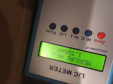

            how does your vallon not going into alarm for not using 1.5mH?

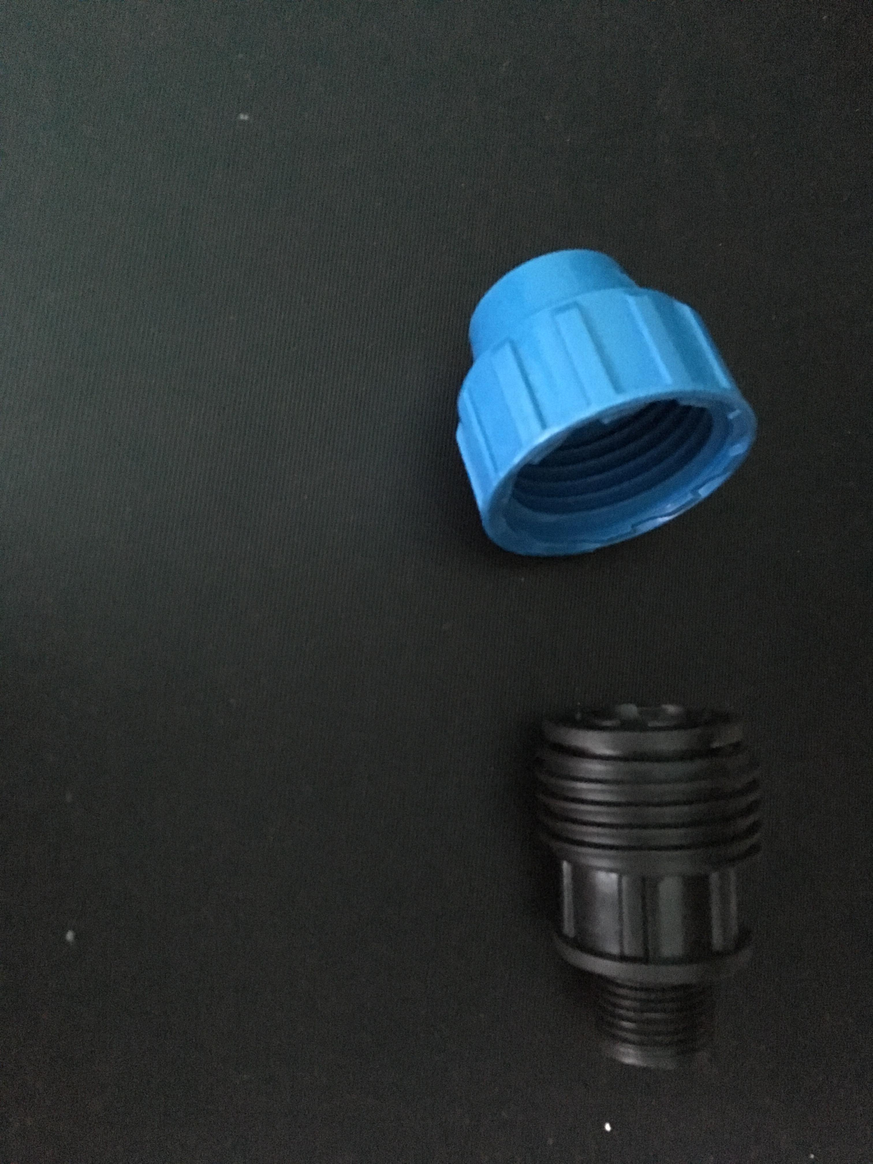

            Thank you for your usefull posts. I managed to find a coupling for water hose with same tread as vallon connector. on the inside i had to trimm like 1-2mm to fitt.

            • Yes, i drilled it out the same way whith 25mm drill bit and sanded threads a bit. The only thing in my opinion which matters is resistance and capacitance and resonant frequency. I made one tiny 4 inch coil with 0.9 mH and it works too. It takes time for Vallon to check it but then it calms down. Large coil I made 1.5 mH.

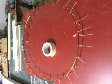

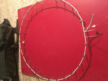

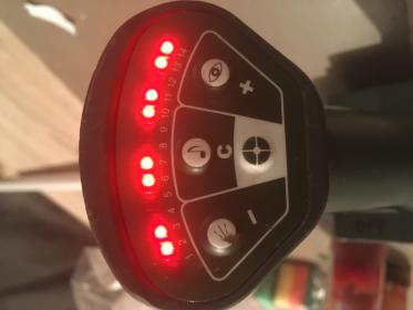

                          • Made 60cm coil (25”) 0.5copper wire, before shielding with fabric nickel tape i had it tested. With 2metter of rg 58 vallon give error. Without the cable(leads directly into the vallon connector) it works. What shoud i do? I did not check resonant freq. i’m afraid that if i complete the coil, will be to late for adjustments/moddifications.

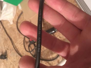

                            • This is cable error. What rg 58 you used. Use with tinned copper shielding RG58 CU. I had same problem with cheap RG58. It seems Vallon is very sensitive on cable. Use at least 1.5m cable with resistance (with cable ) at least 3 ohm. In my case it worked. I think it is somehow related to damping adjustment in Vallon firmware. There are only certain regions where damping can be adjusted. If your coil is out. Meaning too over or under damped Vallon gives this error.
                              • Originally posted by MTammet View Post
                                I will do more experiments. I use good cable, tinned:
