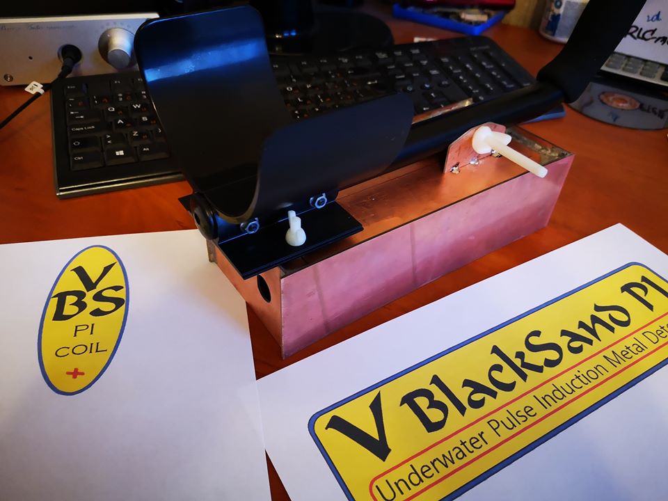

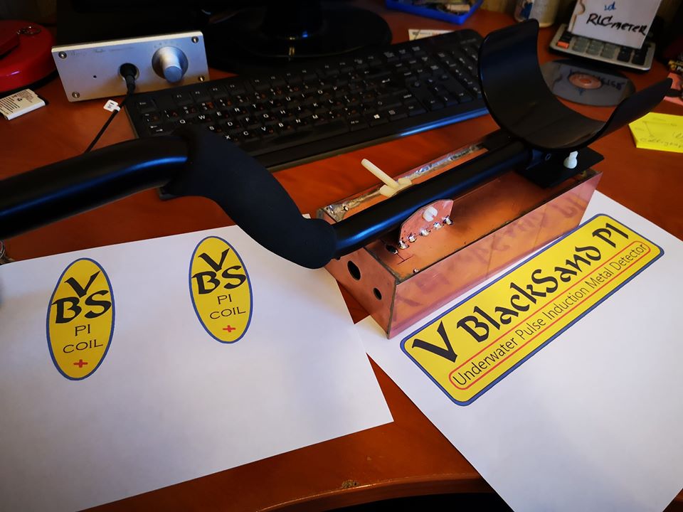

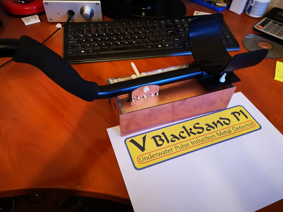

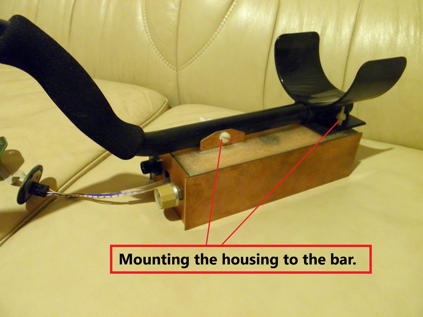

              • The case for the detector is completely home-made.
                It is soldered from double-sided foil fiberglass.
                Upon completion, it will be a fully enclosed blind structure. Like a tin can.
                The plates are soldered on both sides with a small allowance where the epoxy is poured which additionally seals the solder joints.
                I call this design "hi from the 80s"

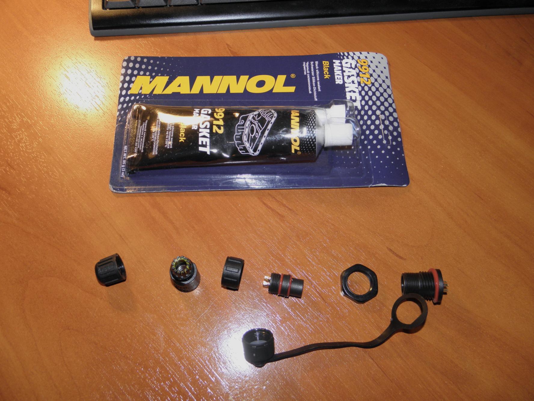

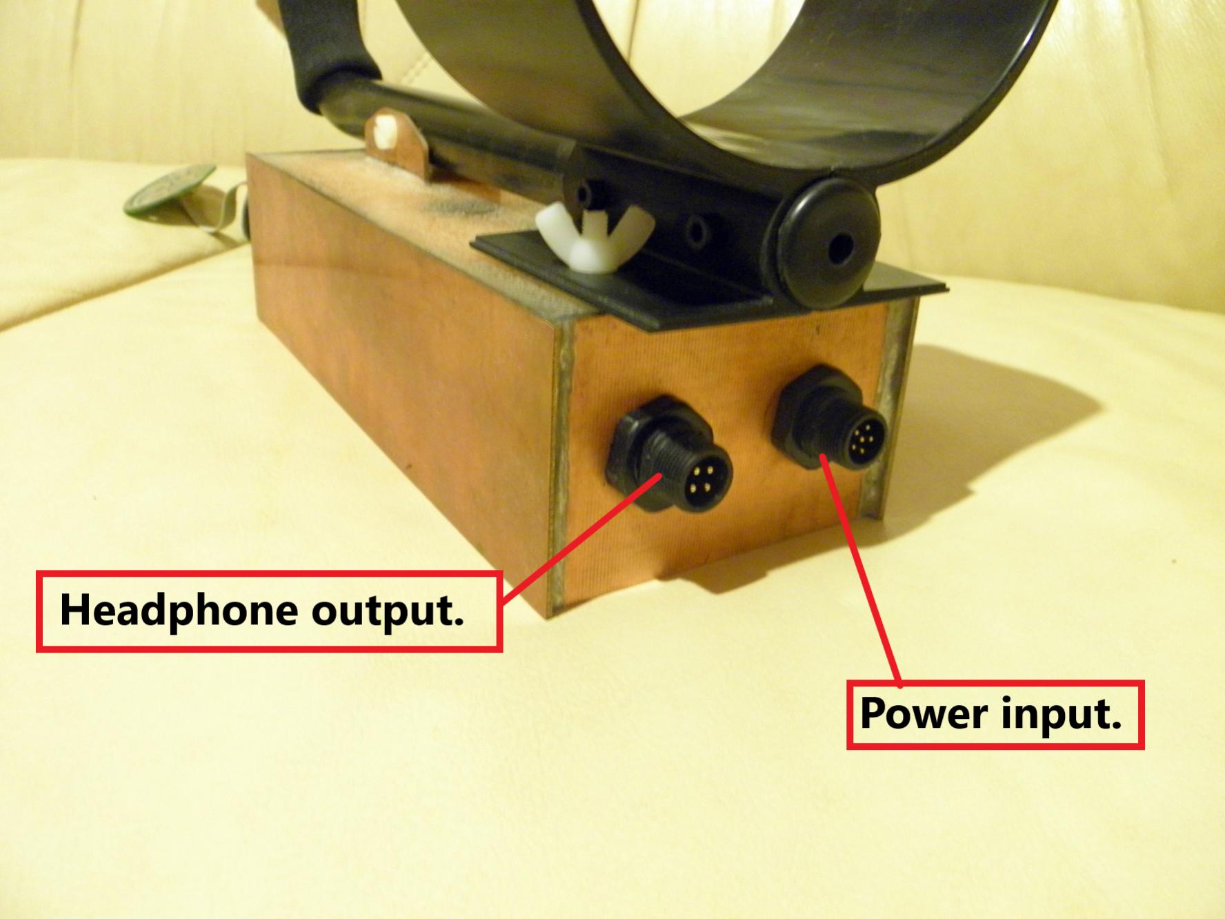

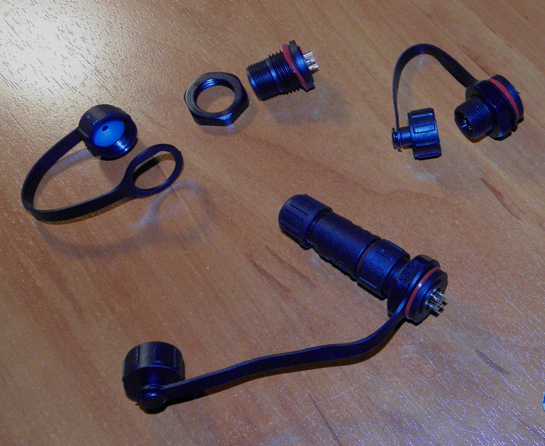

                Curly holes for connectors are sawn in the case.
                All IP68 connectors on the inside are further seated on a very strong rubber sealant.

                The operating mode knob is brought out through the gland.
                RS ist der führende Anbieter von industriellen und elektronischen Lösungen. Sichere Online-Bestellung. Versandkostenfrei ab 100 € Nettobestellwert.

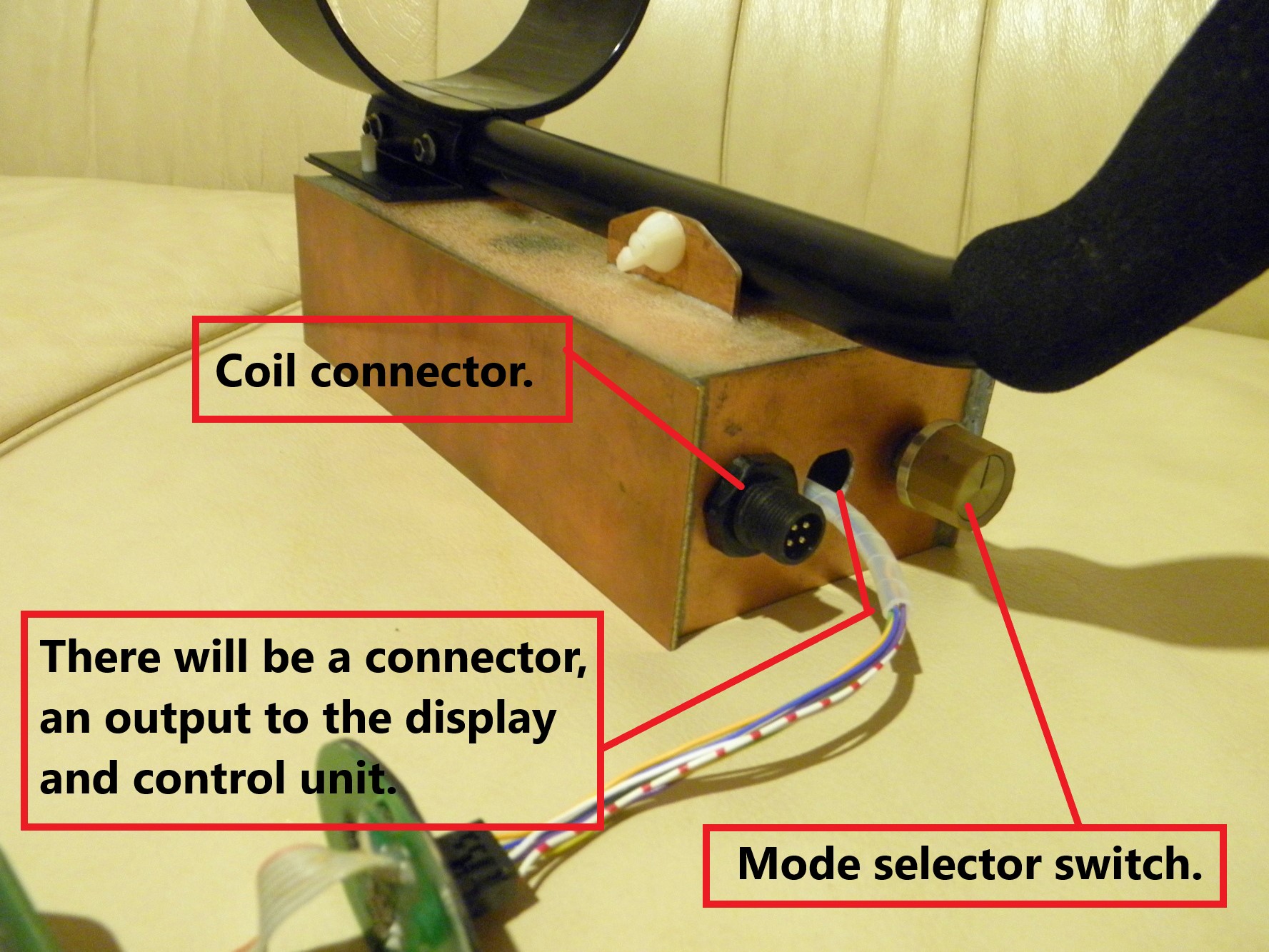

                In the photo, the purpose of the connectors. Mount to the shaft.
                The battery pack is separately in a sealed non-separable case.
                Indication and control unit in a separate housing.

                After the case is ready. It will be painted with an 1k epoxy primer. Great thing.
                It adheres very strongly to the surface and fills all microcracks. The main thing is to let it dry well.
                Then the main painting ...
                Well, something told.

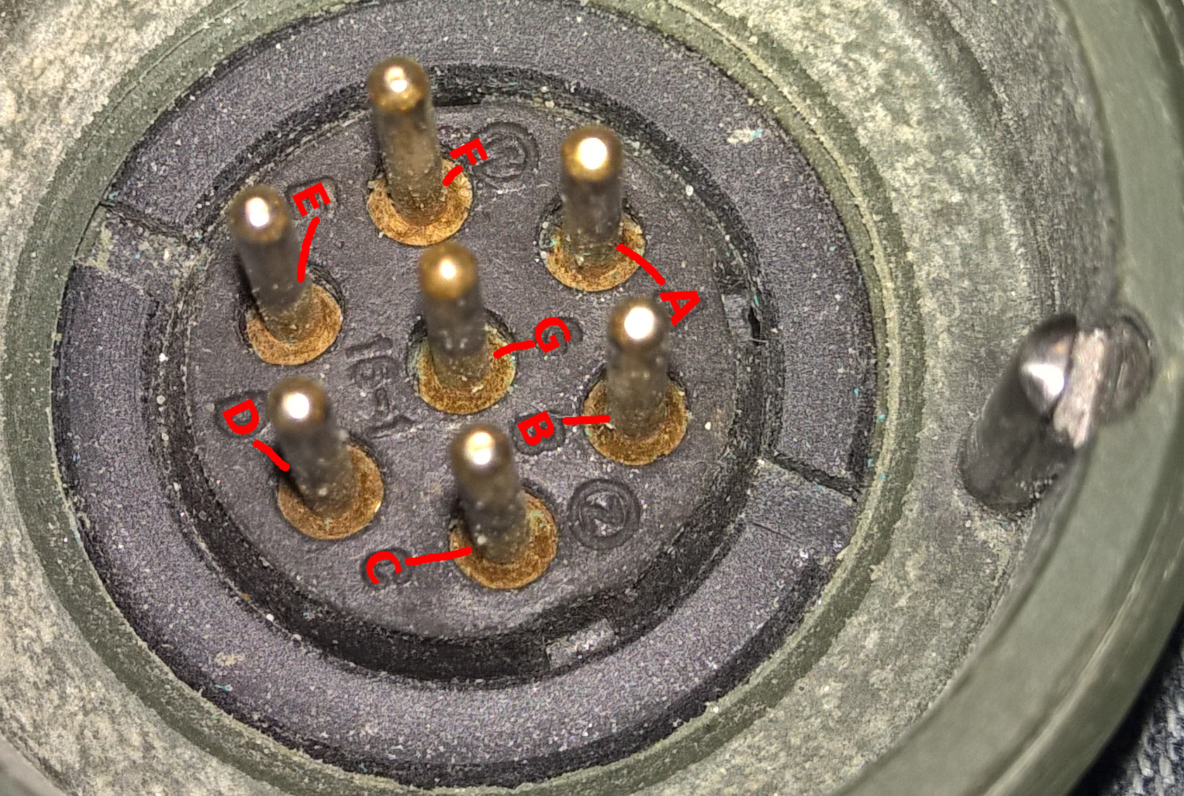

                • Coil - Measuring resistance between the pins
                  Hello,
                  I've got a coil-related question. As Mr Foster stated in the post #18 "The 7 pin connector has the centre pin as live to the coax core and all six outer pins are wired together forming an outer shield and connected to the coax braid."
                  The pins are marked A, B, C, D, E, F for the outer pins, and G for the centre pin. I can measure ~ 5 Ohm between the centre pin and any other outer pin, but I measure ~ 2 Ohms between the outer pins. Is it OK ?
                  Best regards,
                  MC

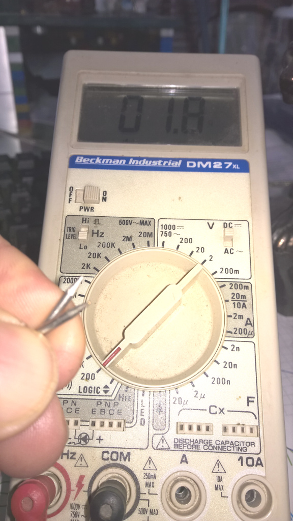

                  • What reading do you get on the meter if you short the probes together?
                    • What are you measuring, which device. It should not be. Close the probes of the measuring instrument, what shows?
                      • When the two probes touch, I read ~ 2 Ohm, and when the do not, it displays 1 ... Does it mean my multimeter is fried ? I is set on 200 Ohm (see photo).
                        I'm not skilled in electronics. Sorry if my questions seems of a noob.
                        • Everything is normal, with closed contacts 2 ohms error. Now consider 5-2 = 3 ohms coil resistance. 2-2 = 0 ohm between contacts a, b, c, d, e, f

                            • Brin,
                              You may have a small potentiometer or knob that you can use to zero the meter on the ohms scale when the 2 test probes are joined together.
                              • Thank you all for your answers.
                                I checked and rechecked, but my multimeter has no potentiometer to adjust the zero. I checked in the battery case too , but there are only fuses. I'll go with -2 Ohm measures.
                                So I have ~ 3 Ohms between the centre pin and the outer pins. Is it OK ?
