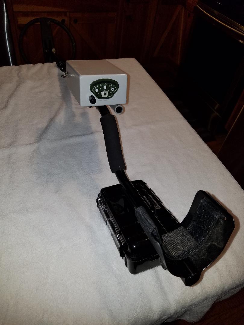

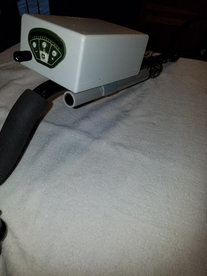

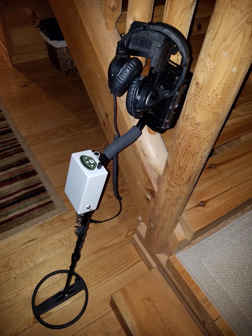

                • Predator II

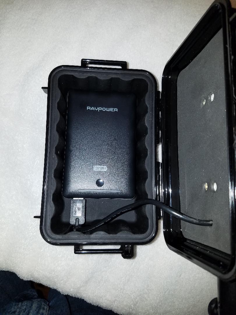

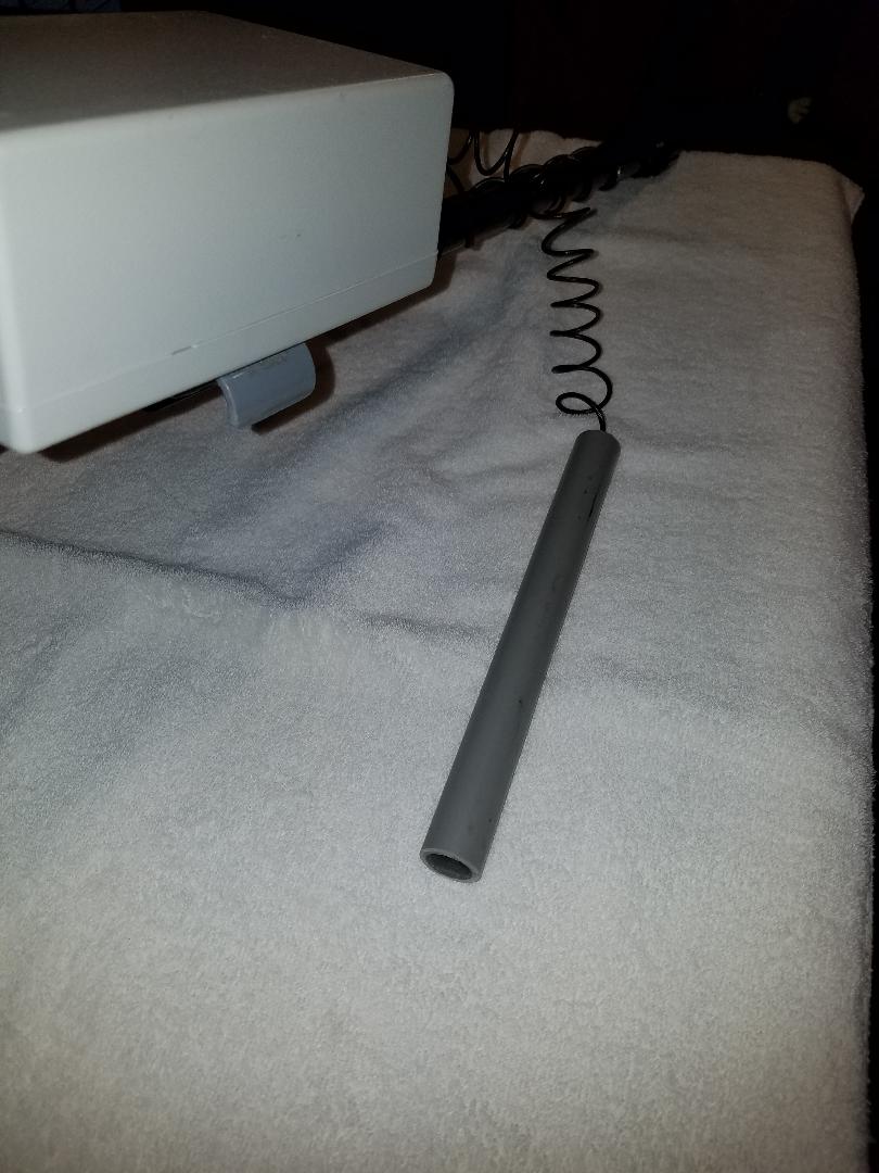

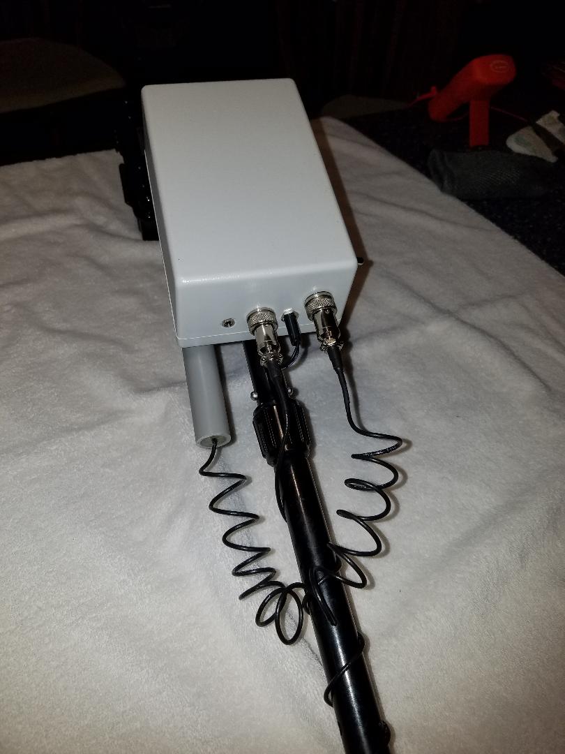

                  Finished up the re-case of the Vallon electronics that I used as a test envirionment. Power is supplied by a RAVPOWER usb power pack (16000 maH) mounted in a Pelican case that mounts on the rear of the shaft. The total weight of the pelican case and the power pack is about the same as 3 "D" cells and pretty much balances the the weight of the detector fore and aft of the grip. The pelican case also functions as an effective "stand" when laying the detector on the ground. Made a 1500 uH probe with a snap-in clip that is mounted on the underside of the Hammond case. Mounted a switch to switch between the search coil and the probe. Not the ultimate, but a "predator" just the same!
                  • Nice job!
                    • Great job, KIngJL.
                      Does your detector behave itself when switched from coil to probe? My rebuild sometimes locks up and I have to switch the detector off, switch to probe into circuit, and then power up again.
                      Eric.
                        Eric.
                        So far it behaves itself... but I have only switched it a couple of times. If it does start acting up, I may try a On/Off/On switch and let it register "open coil" between the probe and coil switch.
                          Locked up one time out of 20. It was switching from probe to search coil. I don't know yet if it means anything but at switch time the probe was providing a "substantial" target signal for the detector. When it switched to search coil, it was still indicating the "substantial" target signal.
                            Yes, that is exactly what happened with me, except it was more frequent. The on/off/on switch is a idea worth trying.
                            Eric.
                              I found ( I think ) that if I minimize the probe response (hold it so that the probe end is away from the unit) when switching, I avoid the lockup.
