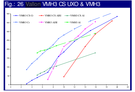

        • Doing a little reading today...came across a mine detector report. They compared the VMH3 and the VMH3CS UXO against steel, chrome and aluminium balls. If I am reading the graph correctly, the "regular" vallon did better than the UXO on aluminium balls!Click image for larger version
Name:	Screenshot from 2017-04-08 15:56:34.png
          They said: "Special cases are visible for the other detectors and aluminium (Figures 23, 24, 26) where it seems as if the crossing will appear much later and the curves are almost parallel".

          • Originally posted by kingswood View Post
            Doing a little reading today...came across a mine detector report. They compared the VMH3 and the VMH3CS UXO against steel, chrome and aluminium balls. If I am reading the graph correctly, the "regular" vallon did better than the UXO on aluminium balls![ATTACH]39456[/ATTACH]
            Interesting
            http://bookshop.europa.eu/hu/metal-d...-NA-22534-EN-N.
            That is an interesting report, which I will study further. On a quick look, it wasn't clear if the VMH3CS UXO ran a different program or was the standard unit but with the 60cm UXO coil.

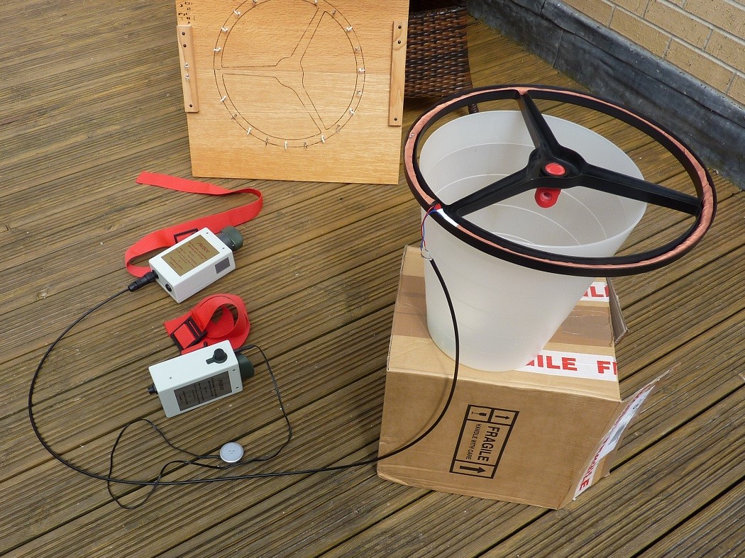

              • The coil that shouldn't have worked, but did.
                I made a shielded winding for a 15in coil to suit the VMH3CS but made a mistake that I should have been aware of, having made so many coils before for standard PI's. It's all about measuring inductance. For many years, I used a Thandar TC200 meter which operates at 1kHz. This seemed good enough and still works fine, but a couple of years ago I bought a digital LC meter where the range setting is automatic, except that you have a HI/LO button depending on the size of the inductance you hope to measure. There is an overlap between HI and LO which enable me to measure 1-2mH on either range. The difference is that the measurment frequency changes depending on the inductance and whether you are on the HI or LO setting. For small inductances on LO it can be 100kHz while on HI it can be 10kHz.
                The problem became apparent when measuring the inductance of the 15in coil where I started with 50 turns and took some off until it was about 1.5mH at 43 turns. This was on the basis that when the coil is taped up to pull the wires closer together, the inductance goes up, which it did. It reached 1.9mH which I thought was about right. I measured a stock Vallon coil for comparison and it read 2.0mH. This is where things were going wrong as the meter was for the LO inductance setting and running at 90kHz when the button was pushed that shows the frequency of the measurement.
                I continued, oblivious to the mistake, and added the shielding which in this case was woven copper fabric tape. I then measured the inductance which had shot up to 2.8mH which was a large jump for no apparent reason. There were a few other changes I had made, one was to use 7/0.2 pvc wire instead of the enamelled 0.53mm solid wire that Vallon use. Additionally I used 1.5m of RG58 coax instead of the thinner Vallon stuff, so was fully expecting the coil to require some major tweaking.
                I plugged it in to one of my re-builds in a belt mount enclosure and surprise, surprise, it worked with one noticeable difference; after the self test the detector took a while to zero down, although it could be speeded up by pushing the C button. Detection range seemed excellent but no actual measurements were taken at this stage. I then went back to the inductance problem as I couldn't accept the 2.8mH being correct.
                The Thandar meter gave 1.8mH and the digital meter 1.76mH provided I pressed the HI inductance button where it was operating at 11kHz. Next I measured a stock Vallon coil which was almost spot on 1.5mH and the measuring frequency 12.5kHz. I believe I have stated 2.0mH for the Vallon coil in some recent posts due to this measurement confusion, but it is certainly 1.5mH that is the correct figure.
                I suspect that the overlong settling time is due to the inductance figure being too high at 1.8mH, so I shall reduce it to 1.5mH and test again. The resistance using 7/0.2 wire plus the 1.5m of RG58 is 4.6 ohms as against 4.0 ohms for the stock Vallon plus all the cable to the electronics. My resistance will come down a bit anyway when I take 2-3 turns off.
                The lesson for me was - always check that the frequency for checking the inductance of PI coils should be 12kHz or less as considerable errors can occur in the measurement.

                    • 15in coil - Air Tests
                      I made a second winding as the first one only worked at night . It seems to be a temperature effect, but still investigating. The second winding was a bit more accurate i.e. much closer to 1.5mH and with Scotch 24 mesh shielding as Vallon use. This seems reliable throughout the day.
                      The following measurements were made at 5am as EM noise is then negligible. Measurement is for two LEDs lighting up. Default sensitivity in 'normal'.
                      US nickel .............................18in
                      Guinness beer can .................40in
                      UK 50p coin .........................24in
                      10gm nugget .......................13in
                      1gm nugget .........................8in
                      I'm happy with those initial results , and more tests will follow when the coil is potted and ready for the great outdoors.
