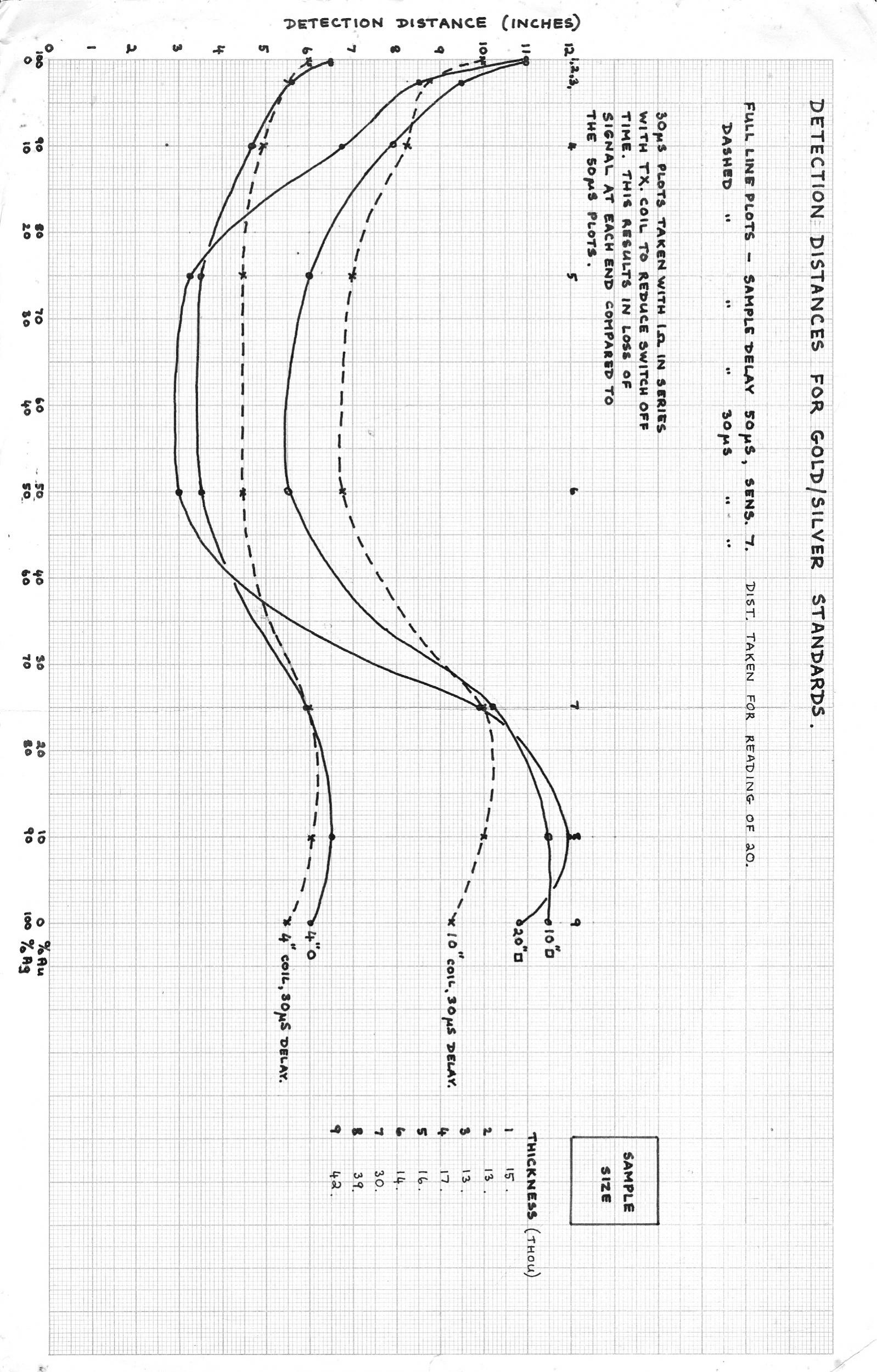

    Hi Eric,
    You said that you've attached the plot for gold/silver, but the plot is actually the one for gold/copper. Oops!
    Oops is right. Here is the correct one. A bit more complex as it deals with the different coil sizes.

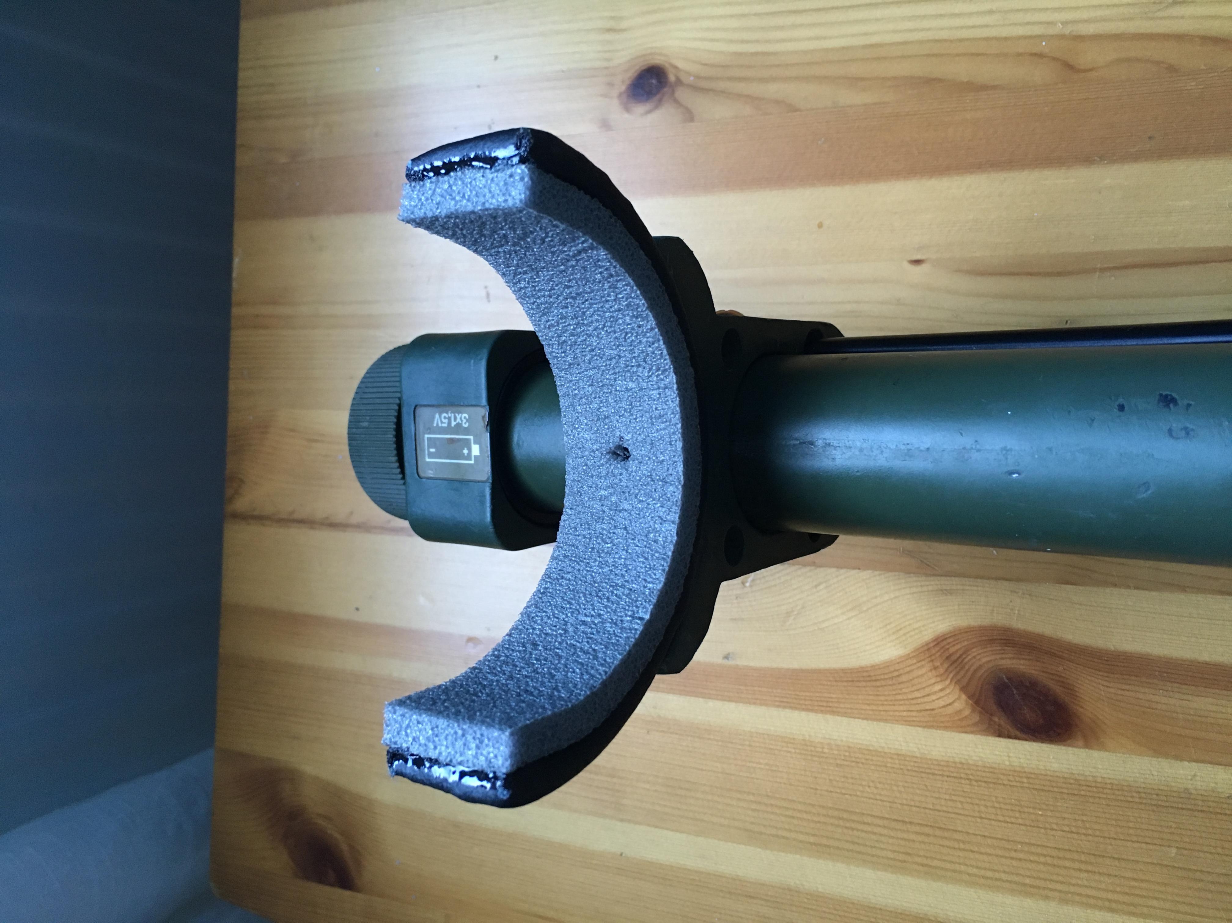

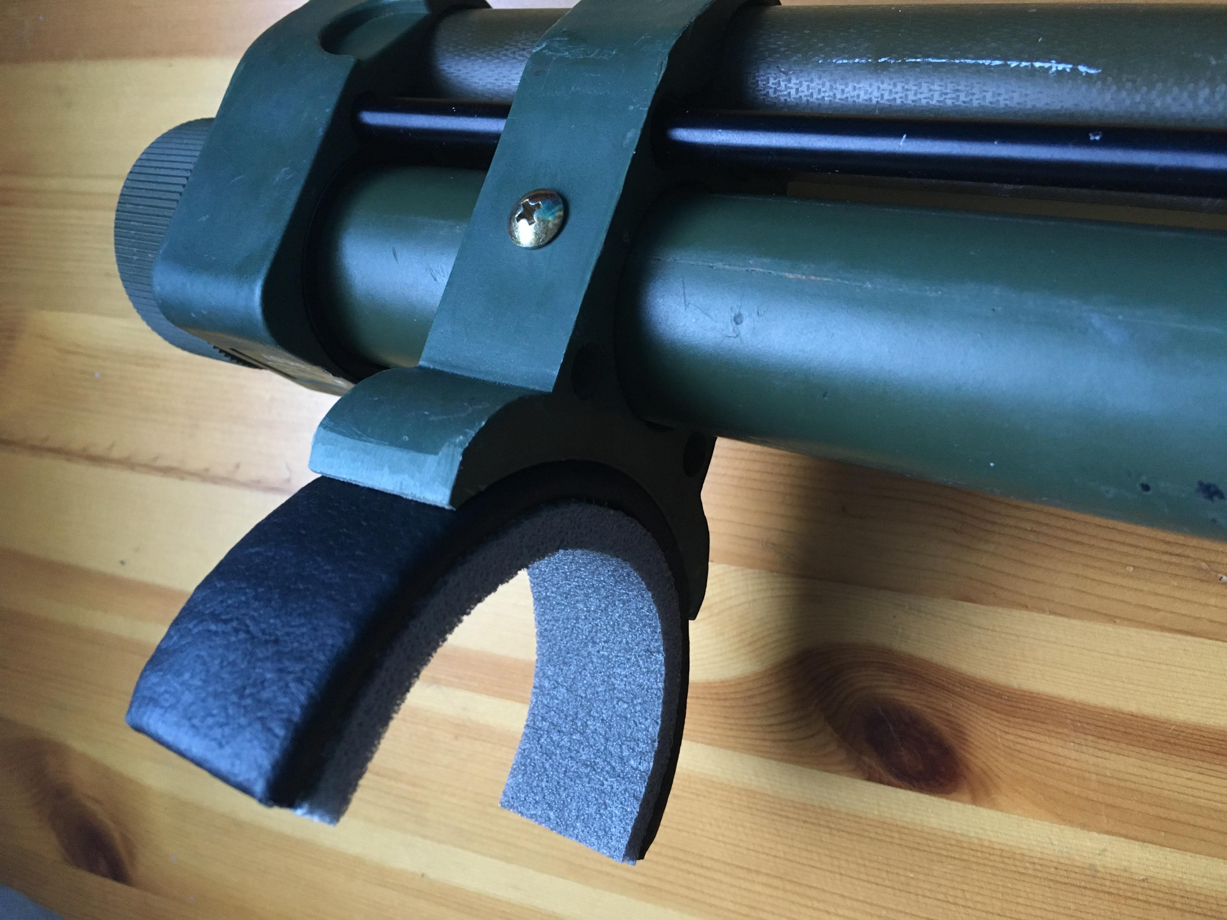

      This is the armrest i made from pvc/leather for this vallon.

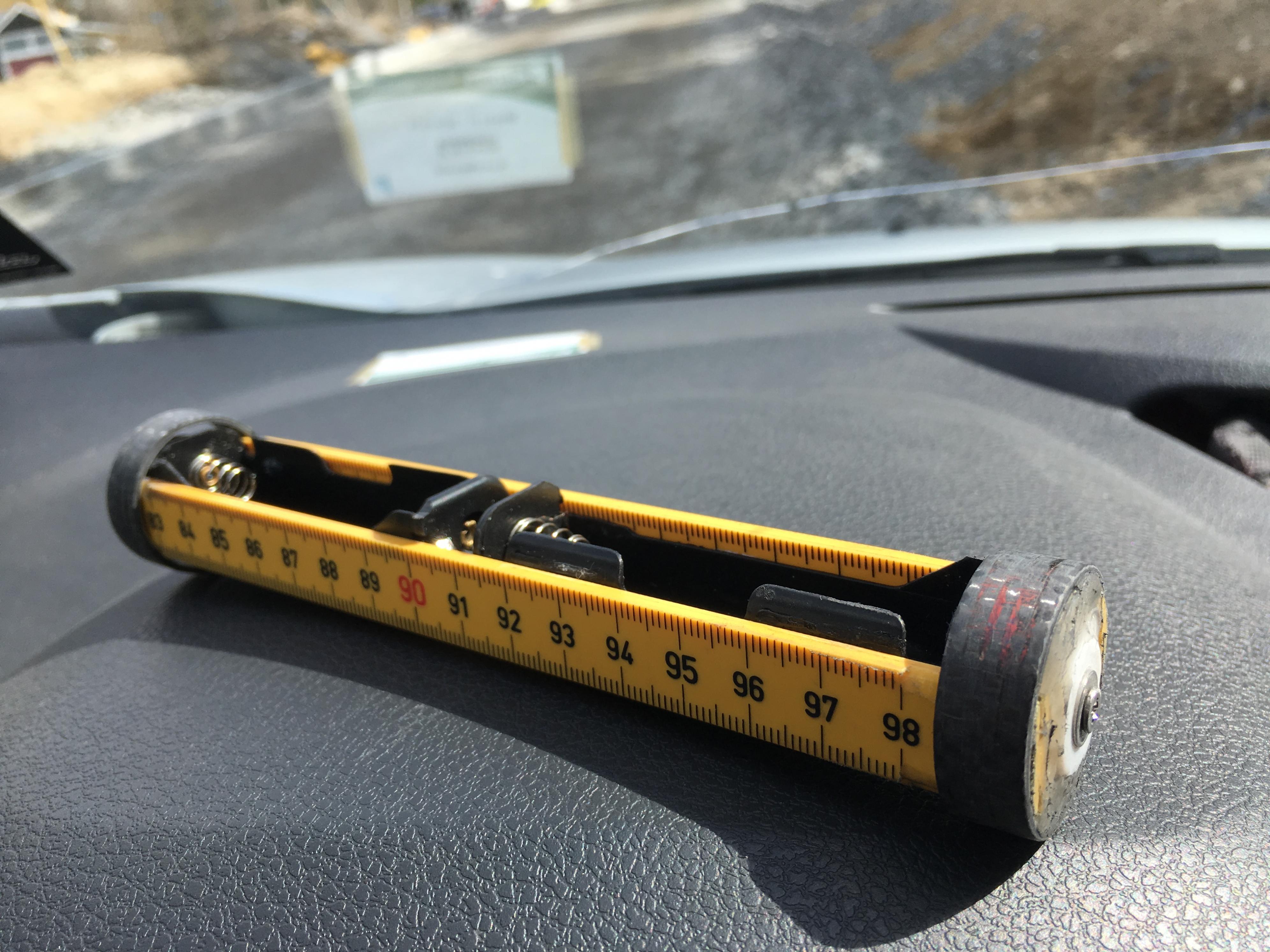

      • 2x18650 in paralel, vallon adapter.

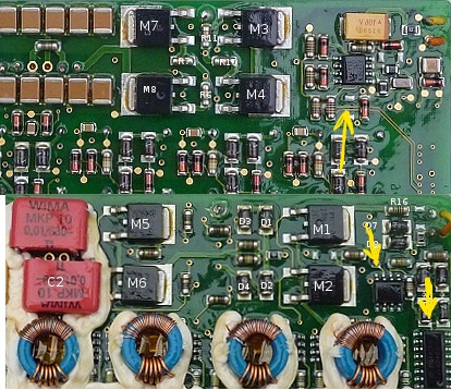

                        HI
                        A question.
                        I have drawn yellow arrows on the image. Does anyone know what components they are?
                        BYE
                        • TOP right: 4532A
                          Bottom right: 8 pin SOIC is OPA627; 16 pin SOIC is DG442.
                          • Many thanks kingjl.
                            In my PCB OPA627 is marked 48760 and DG442 is marked 48790.
                            You have feedback with other pcb as it is marked on mine?
                            I think start retro engineering. I wanted to understand how schematic structured.
                            If not problems for you I would like to write you in private message about the work to have an exchange of ideas.
