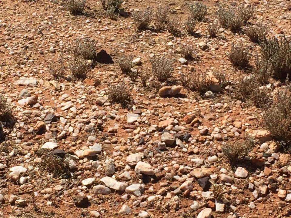

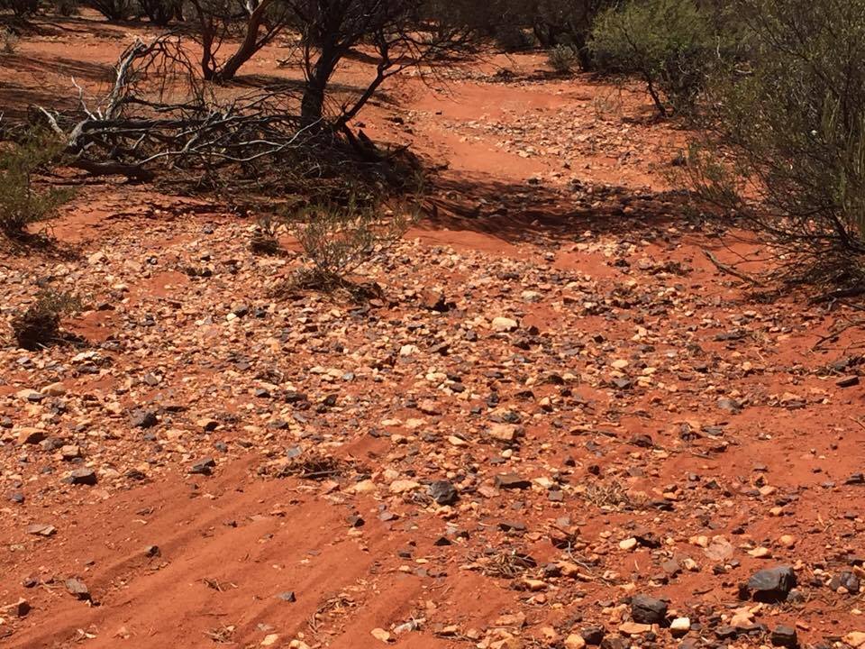

              • First test report of the Vallon!....Location: Murchison Gold-fields, West Australia.
                Spent only 2 hours out this morning as it was 35 degrees by 9 am

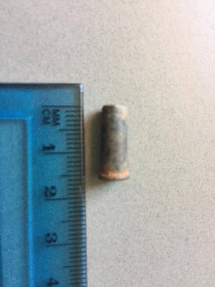

                First location was a mix of quartz and black rocks (I think these are basalt). The Vallon had no issues ground balancing. A couple of bigger hot rocks gave a hum, but they were either kicked out of the way or the hum stopped if the coil was lifted up a couple of inches. Found a bullet casing down at about 6 inches....it made the Vallon screech like a banshee!

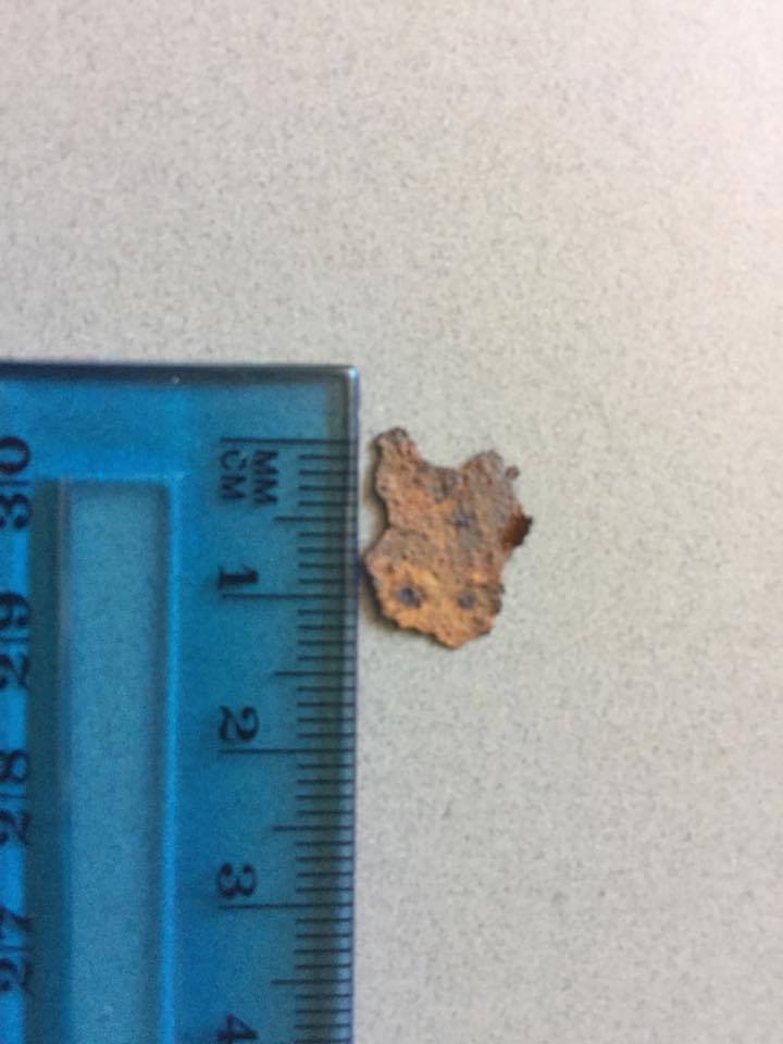

                The second spot was a creek bed, a mix of sandy soil, quartz and black rock. The Vallon again ground balanced beautifully Found a small 1cm very thin piece of old tin at 8 inches that again set the Vallon off. The pin point function worked in helping to find it.
                I have no doubt that if either target found had of been gold, the Vallon would have found it Did discover that all parts of the coil are quite sensitive...if I moved the coil to far back, it was detecting my steel capped boots from about a foot
