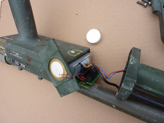

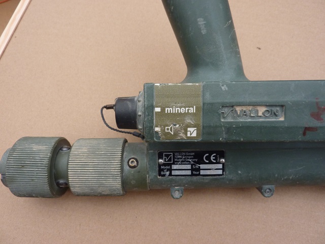

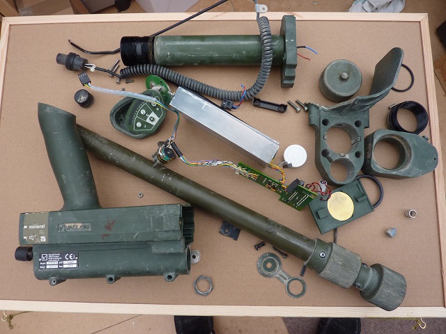

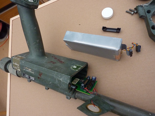

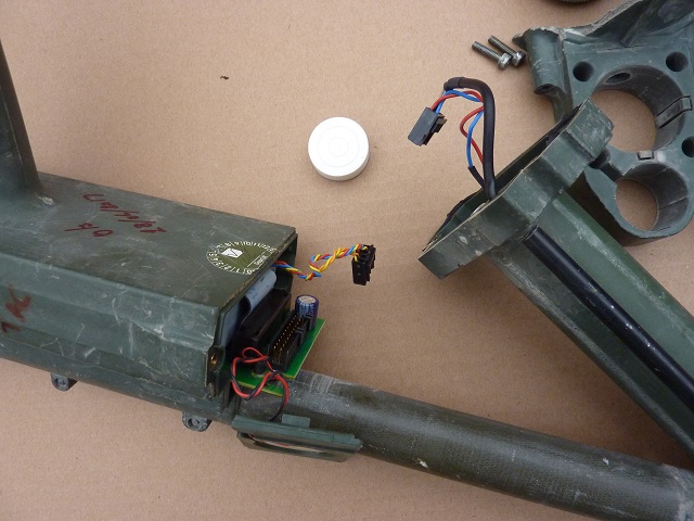

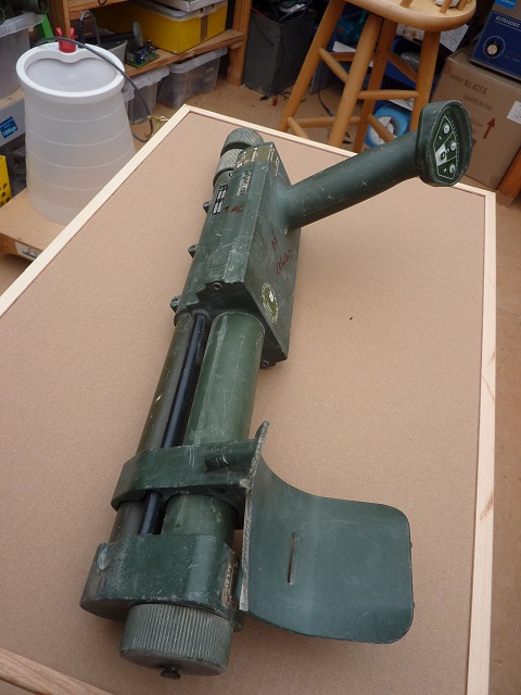

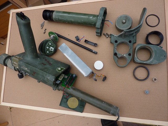

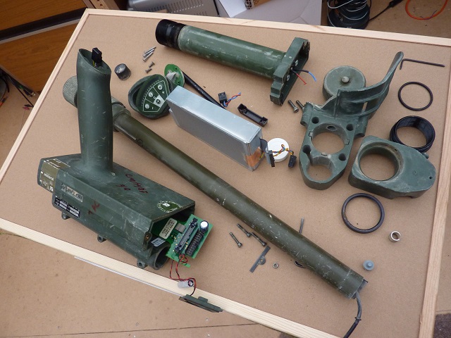

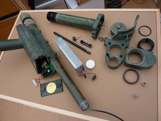

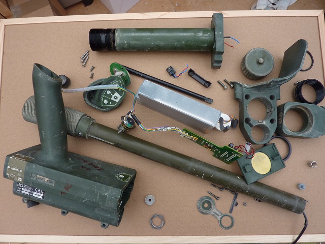

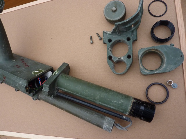

        • 40 minute Vallon Strip Down 1
          I started this on a machine as bought and in a bad state, at 14:46. Stripdown completed at 15:27. I have shown each part of the sequence in case any others are inclined to have a go. Only do it if you are competent and have the tools. The battery tube and coil lead connection are best cut and later rejoinded with heat shrink sleeving. On the coil lead pcb connector leave enough lead to resolder to. Unless the internal electronic box is damaged it is best to leave the internal pcb's alone. No one outside of Vallon have any servicing or schematic information on the electronics which is all firmware controlled.
          Now the big cleanup and reassembly which will take rather longer. I will post a picture when finished.
          Note. The final stage pictures will appear in a following post as any more here will exceed the limit.
          Eric.

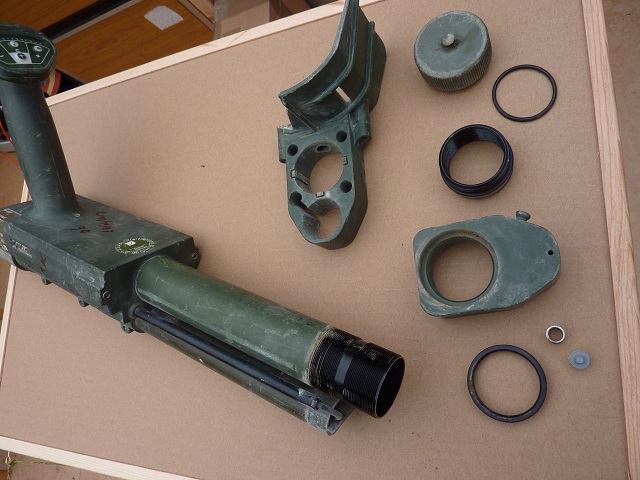

          • Vallon Strip Down 2

              • Thanks for the stripped down pics Eric...nice to know what it looks like inside!

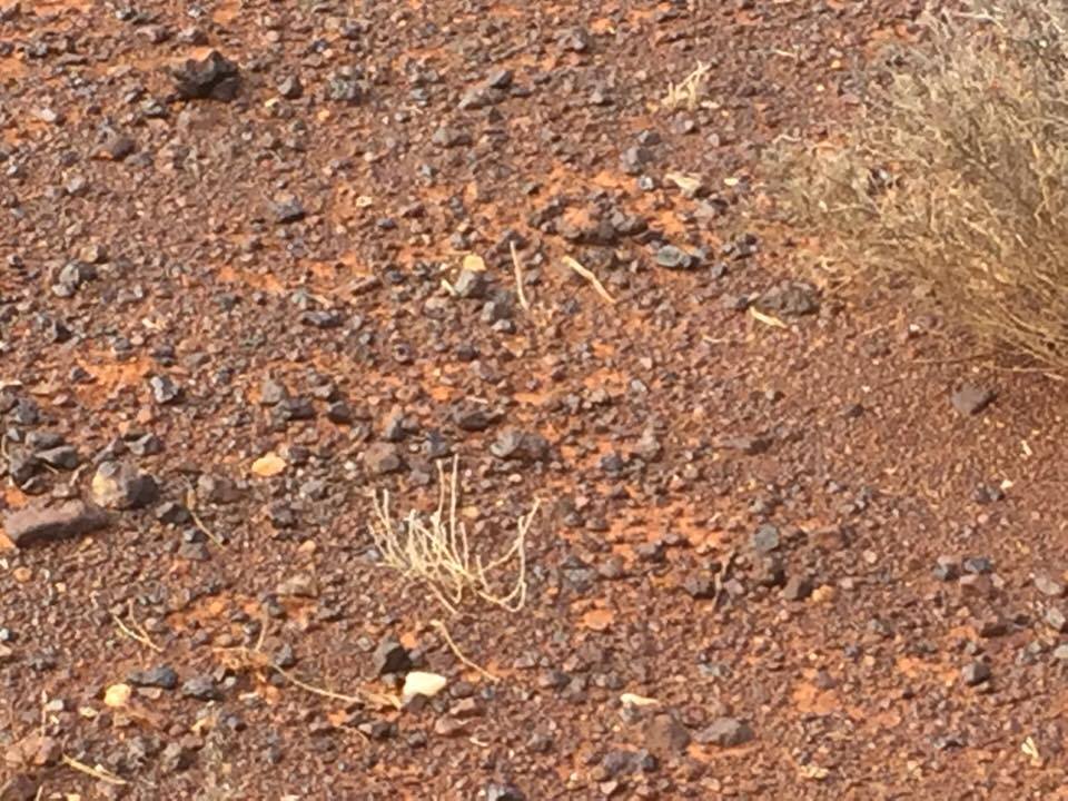

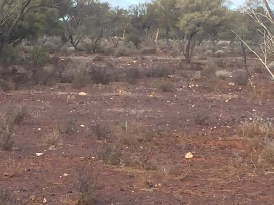

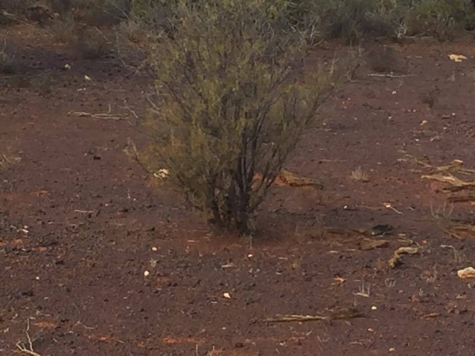

                            • GB was much better today
                              No gold, but none for the SDC2300 either.
                              Quite a few hot rocks that gave great signals. Wife using the 2300 dug a few as well.

                              • Kingswood do you ever get areas that have water worn and rounded edged quartz, to indicate your area was under an inland sea like parts of NSW was?
                                if so pay carefull attention to those areas.
