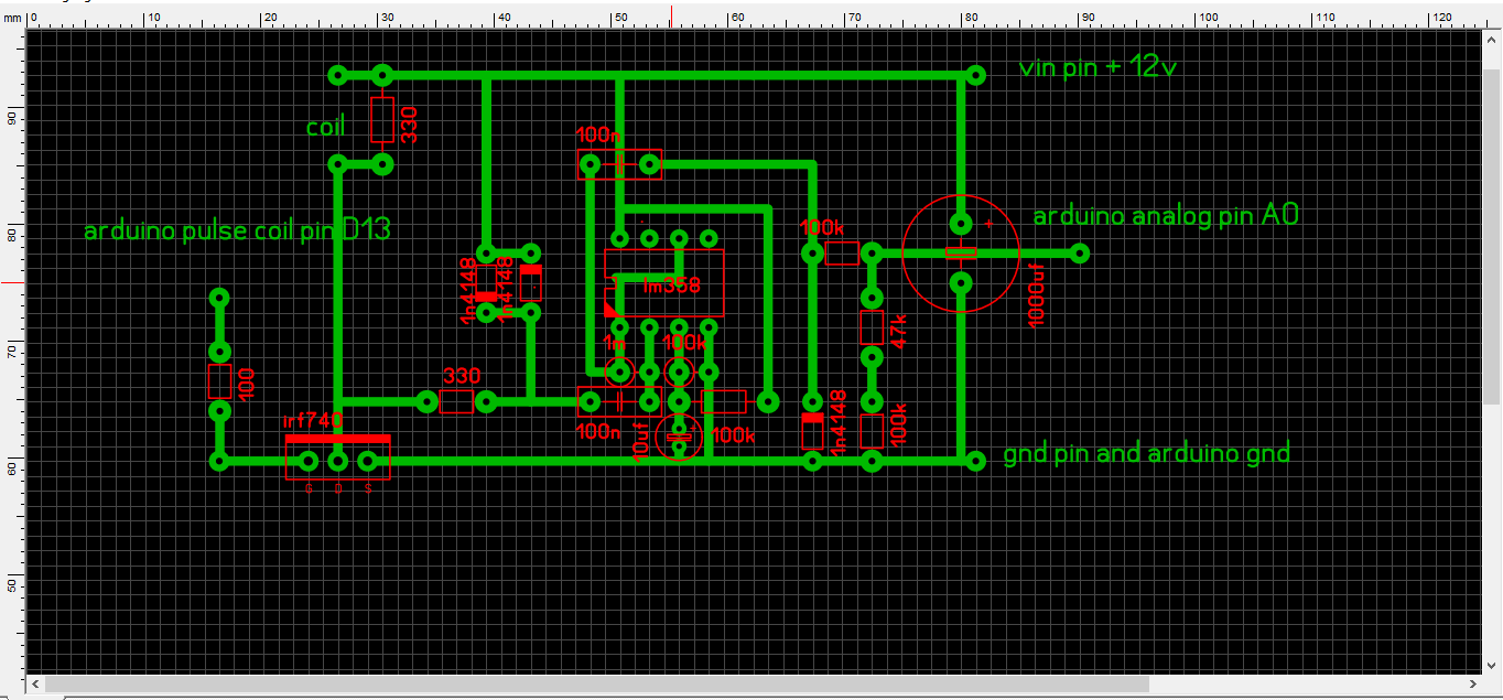

    this is what i have been working on so far it works quite well, im looking for some help in improving it i have had no luck in trying to add a pizo buzzer the EM off it just disrupts the sensitivity
    the buttons are just 5v supply with 10k resistor to ground
    when calibrating just use the delay, if its not calibrated right the numbers up and down wont match just switch it up and down again
    then adjust the sensitivity the lower the more sensitive it will get (SN)
    adjusting the delay is like what it says it will wait a few microseconds before sampling well as long as what you set it for basicly find the sweet spot lol
    i tryed a few things on the site but none seemed to work so i had to try my self, its easy to build and uses minimal components and should be easy to use other OP amps
    Most Cool. What did you use as a coil ? What LCD did you use? I have a few. I'll play with this for sure. Thank You !

      it was just a 1602 16x2 but any will do, as for the coil im undecided i used a 350mh but i think any coil will work, damping i don't think it critical lol i removed it and it still works if not better
      it needs some research into it what would be the best setup that's why im posting it
      i use a nano and a mega both work fine
      you can probably build it without a display i don't see why not just add a pin to flash a led on button pushes
      as for a buzzer hmmm its that sensitive the EM off it disrupts the field when you test it you will see what i mean
      but i have done as much as i can i need new input on it but it makes a good detector

                        Do you have the PCB with just the Tracks I can burn a board with ?
                          i used a bread board then strip board i was thinking of building a cnc since i have a few arduinos lol, think that might be my next project
                            for all who dont have full Version of Sprint Layout, please upload pdf with black pcb tracks as pdf
                              arduino_mdee_final.zip
                              ok got the hardware stable time to work on the software all seems to work stable i will update the software soon
