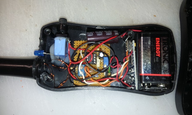

                          Code:
                          int calibrationcounter = 0;
                          int Coil = 13;

                          this is what im using for my pinpointer no buttons or display just using a nano
                            arduino_mdee_pinpointer.zip
                            https://youtu.be/F9I11qfqrA8

                            i had to change the digram for some reason the coil pulls to much power and slows the arduino down so added a 100ohm resistor and pulled out the damping resistor it runs on a pp3 so any improvements will be appreciated
                            forgot to add you can use about any coil on it i had a few on it of different uh they all work

                                i haven't got to the pcb stage yet i used strip board
                                as you can see it fits in that cheap pointer box and when i get some etching stuff i will make a smt version using a smt fet
                                also i updated the layout it looked like the + rail joined to the output
