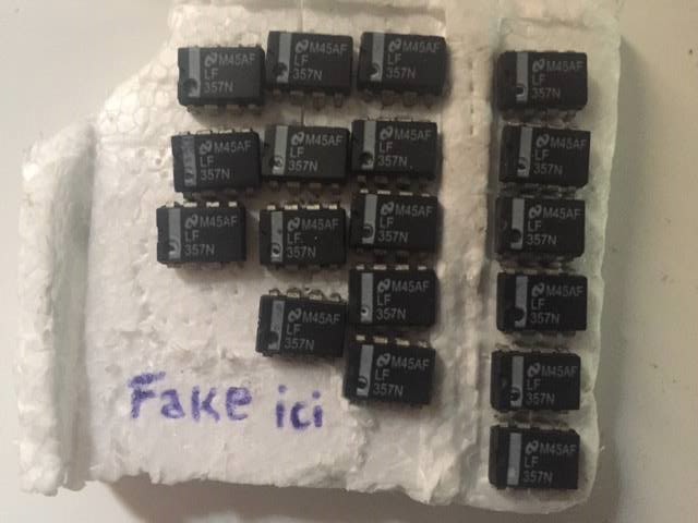

            hi kt315
            ici lf357n not original
            I tried this version of ici (m54af LF357N) is fake ici . Coming from China or singapor

              hello Karim, how do you determine that its are fake?
                i Buy them and try with delta pulse and felezjoo No sound comes out
                with lf356n Works well
                  try another opamps too. i gave BOM file with all subs.

                            you are right Karim. problem was LF357. probably its really fake (((
                              Yes my friend has tried this type and did not work with any device. This particular figure does not work (m54af LF357N)
                              Try any other type that will work : tl081-lf356n-lm318-ua741...
