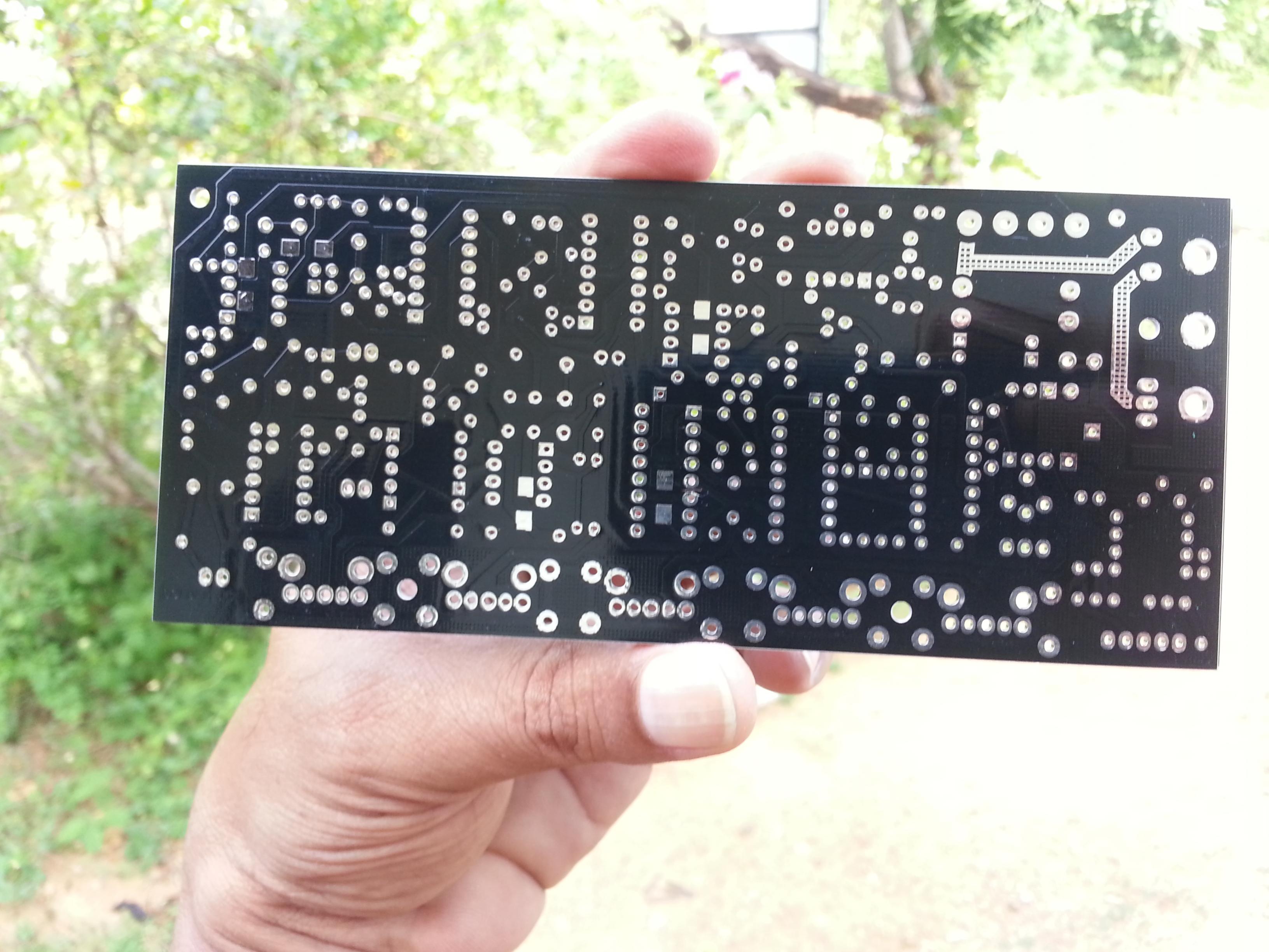

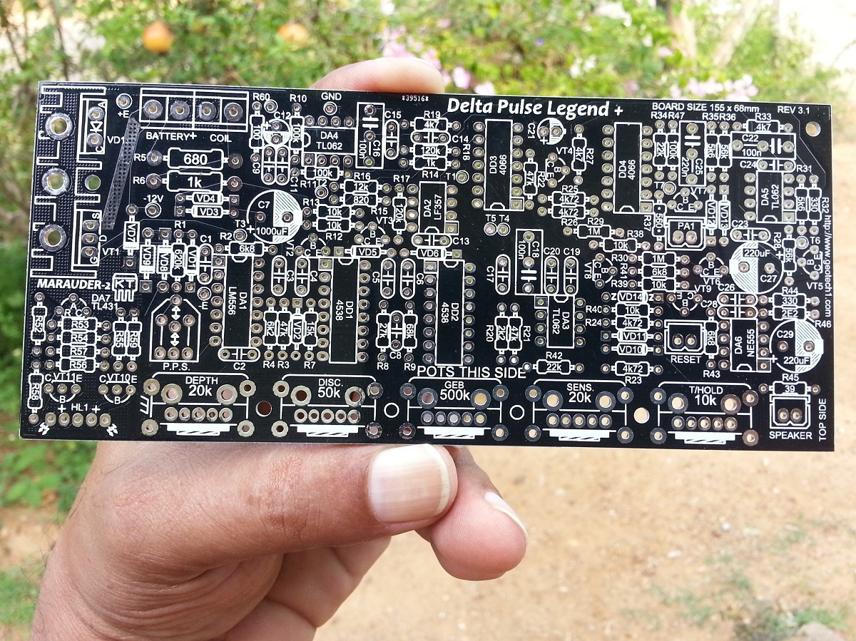

          Hi kt315, Thanks , I received your DP 2 ' Black Revision ' PCB . It is a super quality PCB . I am in a hurry to build the project . Can I use aluminium box for it or should I use plastic box with shielded sides .
            hi Tissa,
            i am glad you got superior product.
            you may use and plastic and metal box. while if you use metal enclosure with coil 1mx1m coil certainly you will get additional instability.
            so metal one with small coils, plastic one shielded with huge coils. your choice.
            i use plastic.
              Got it . Thanks .

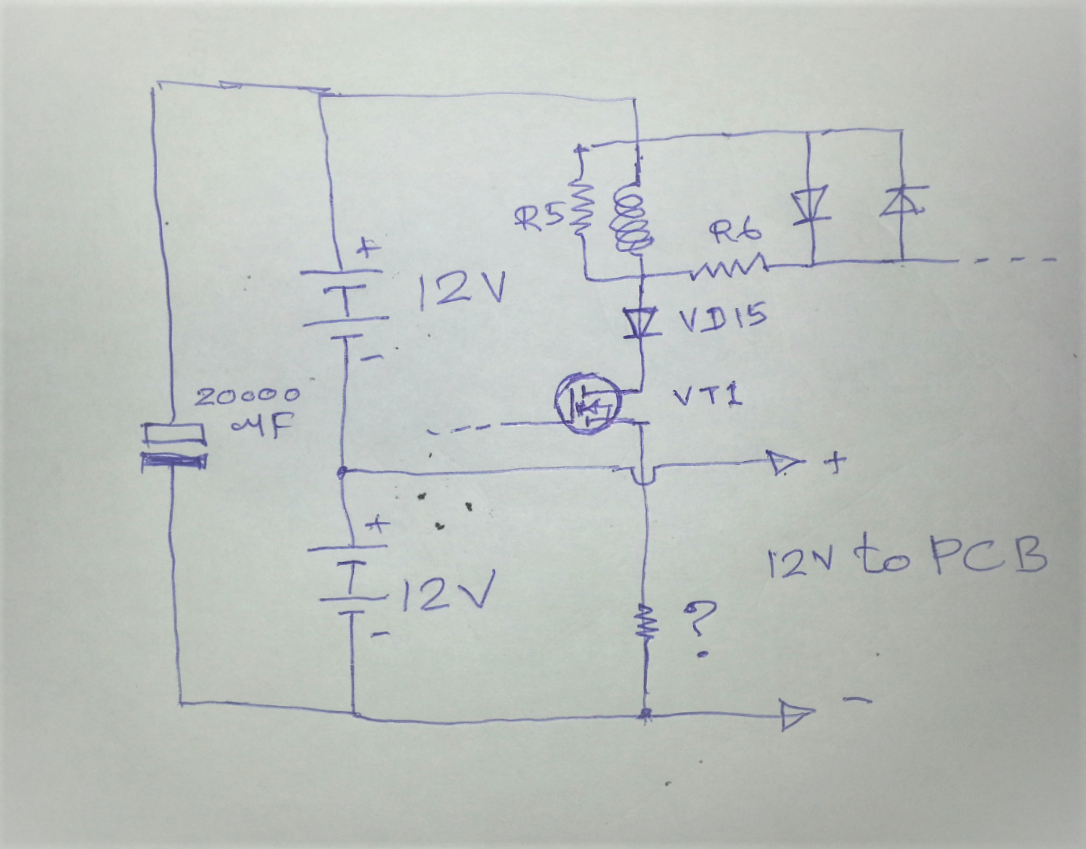

              If I use isolated 24V to the MOSFET with 1.2 ohm 5W series resister will it give me more output power ?
                with 24V you burn the board. output power is getting another way. if you increase PULSE WIDTH to more than 500us.
                also you must use another type of MOS-FET and another type of battery just cause a current consuption will increase too.
                  load this file http://depositfiles.com/files/2m3mfw6xy
                  unRAR. you have to do same way if you want more depth - the box, the batt, the transistor, the capacitors. it is a PI with 1000us pulse width of Eric,
                  he found otocha gold with. in that (THAT) case you can split power supply - 24V on MOS-FET, 12V on the rest of schematic.
                    Thanks dear Anatloy , I mean that kind of thing . I know it will be a heavy project .
                      Increase output power ?
                      Is this kind of modification work for me ?
                        your offers and suggestion on the depth more write in this thematic
Name:	Black Edition bottom.jpg
ID:	349240Click image for larger version
ID:	349241Here are the photos of Marauder Black Revision
