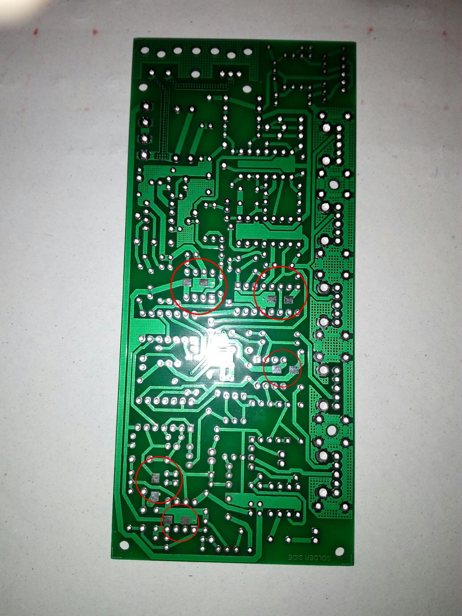

    sorry, are these jumpers
    • #62

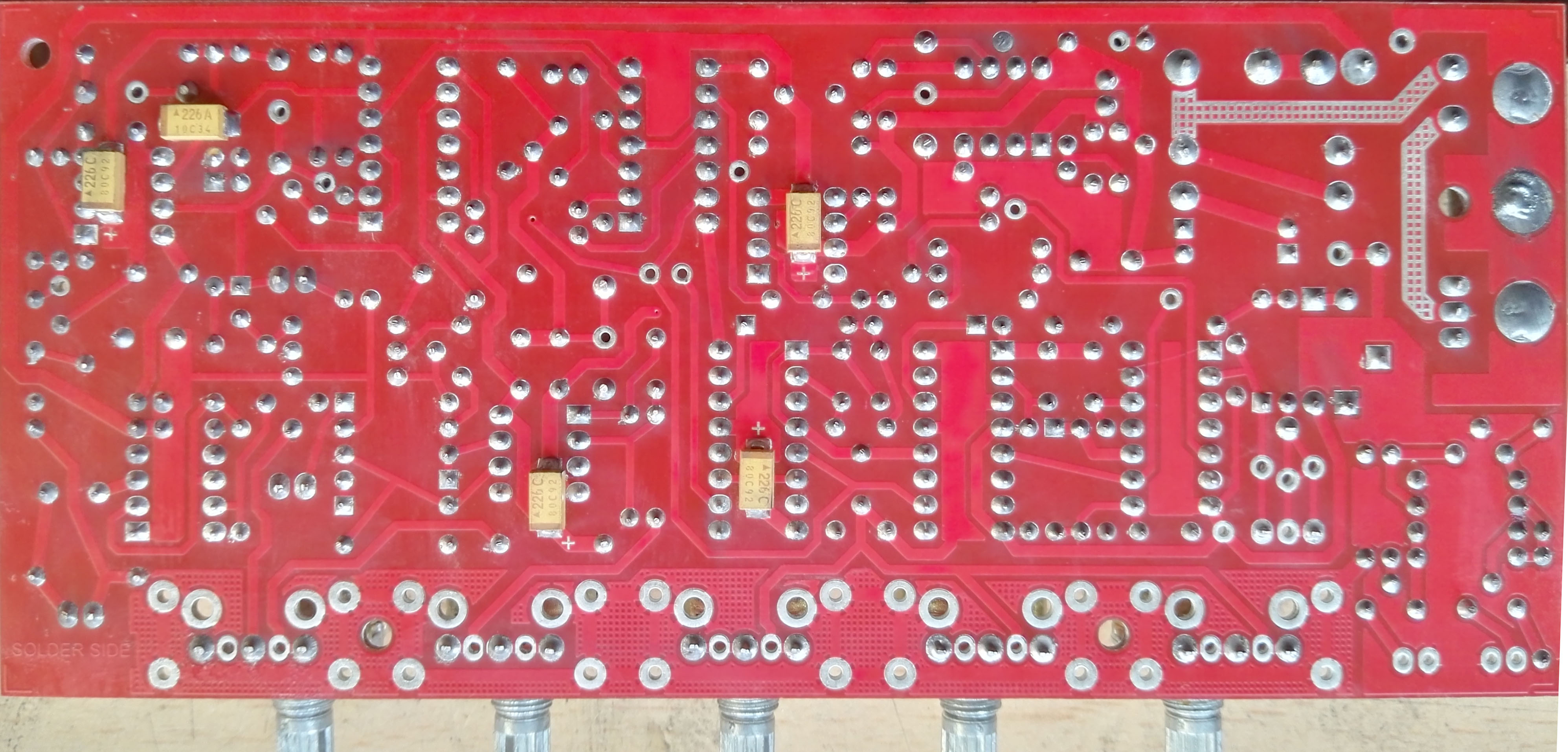

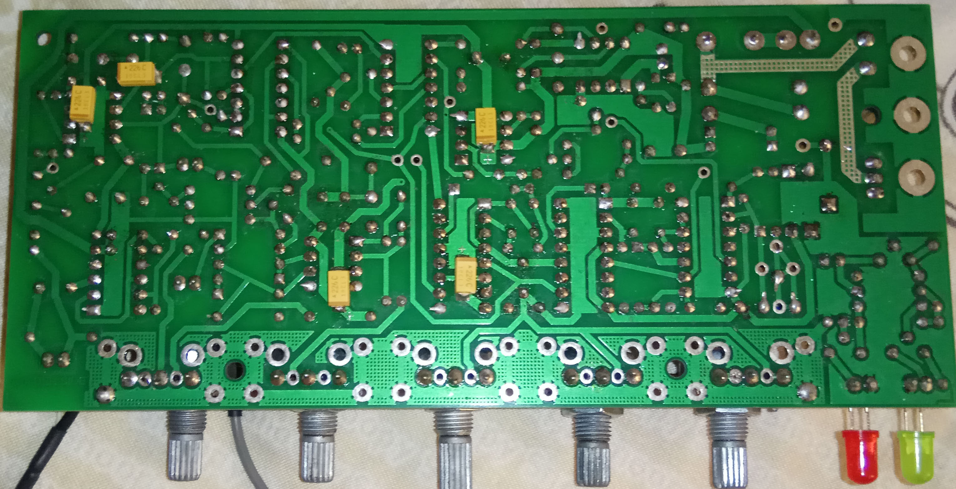

      these pads are for tantalums on back side. they setted for general stability and the suppression of a noise on power lines, like always you see
      in electronics they used.
      that is sweety raisin of the board
      do not solder C30 now. i will tell you later why.
      tantalums are soldered at LAST STAGE, after the board will be working good and fully tested.
