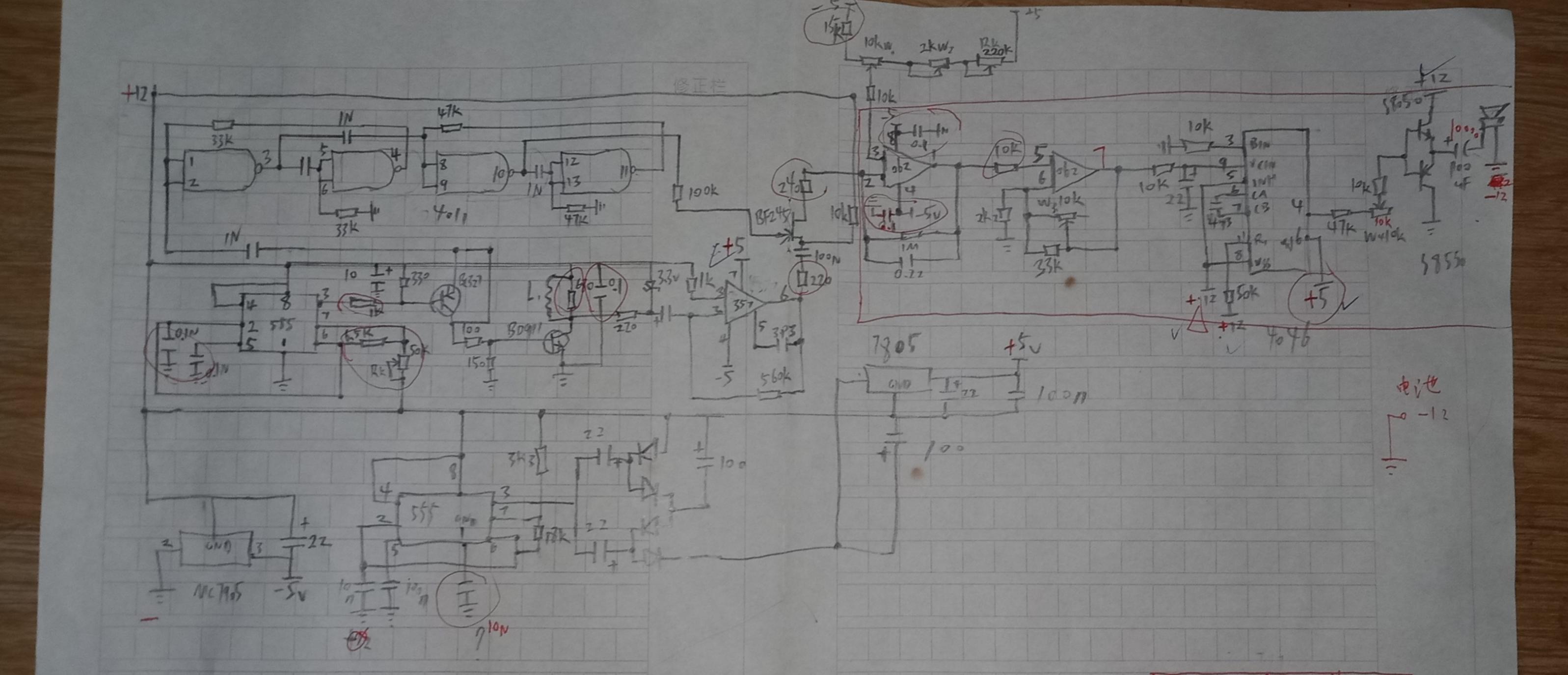

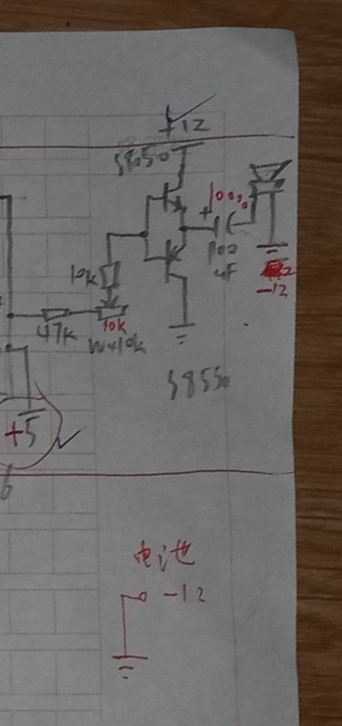

                            • Can anyone tell me what's wrong with this circuit diagram?Or no problem, just this C39 error.
ID:	362359Trash 6103,Click image for larger version
ID:	362359Rubbish 6103, which dog made the fake drawings?
