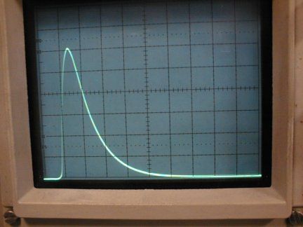

          • [QUOTE = Qiaozhi; 285703] La imagen del 560R muestra una forma de onda subamortiguada. La imagen de la resistencia de 1k muestra a?n m?s falta de amortiguaci?n. Supongo que el valor correcto de la resistencia de amortiguaci?n es 470R.
            Puede ver en la imagen de 1k que el preamplificador se satura al riel negativo durante el flyback, y luego se satura al riel positivo antes de decaer a 0V. El valor correcto deber?a hacer que la salida del preamplificador se sature al carril negativo, seguido de una ca?da suave a 0V. La conclusi?n es que 1k es demasiado alto y 560R puede causar cierta inestabilidad. [/ QUOTE]
            This photo that I show would be the correct damping?Click image for larger version
            • Originally posted by Carlos View Post
              This photo that I show would be the correct damping?[ATTACH]54992[/ATTACH]
              Your picture looks ok. I did a video for coil damping that you might find helpful:
              https://youtu.be/Gr__N4_k2Mc

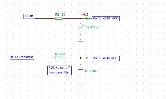

              • has anyone done a newer layout variant with integrated 4046 vco block, or a smd variant?
                latest mod i have done was a external board with 4046 vco, but audio direct output form 4046 driven by two 2n2222 ist not the best sound
                https://www.youtube.com/watch?v=p0sZnO0uaMw
                  Try RC filters for 4046 power and control voltage.
Name:	Filters for 4046 vco.jpg

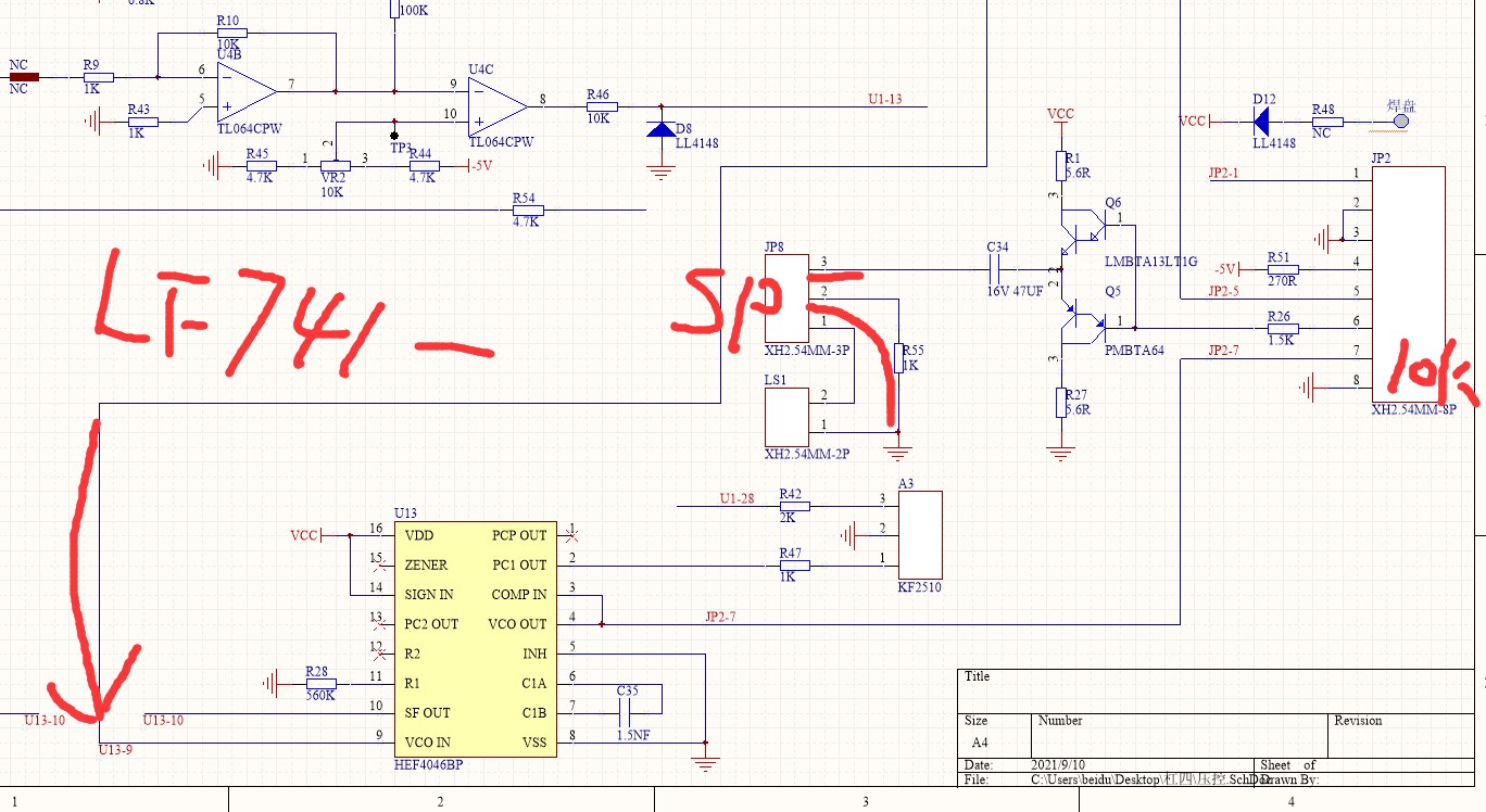

                    • 这是我制作的VCO视频,希望能帮到你 https://youtu.be/z2UugNldhRU
                      • Originally posted by beiduo View Post
                        Please read the forum rules and make your posts in English.
                        • 好的
                            Hello
                            Dear Bayu
                            I have built Mr. Mickstv's VCO (4046) but i have some problems. Since you could build it, so i hope you can help me.
                            As you know, pin-1 of its first opamp must be adjusted to 0 mv. Do you remember your voltage?
                            I didn't measure it, if your layout is in accordance with the MickTV scheme, your VCO will definitely work, and I use a separate audio Amplifire from the VCO
                              What is vco name?
