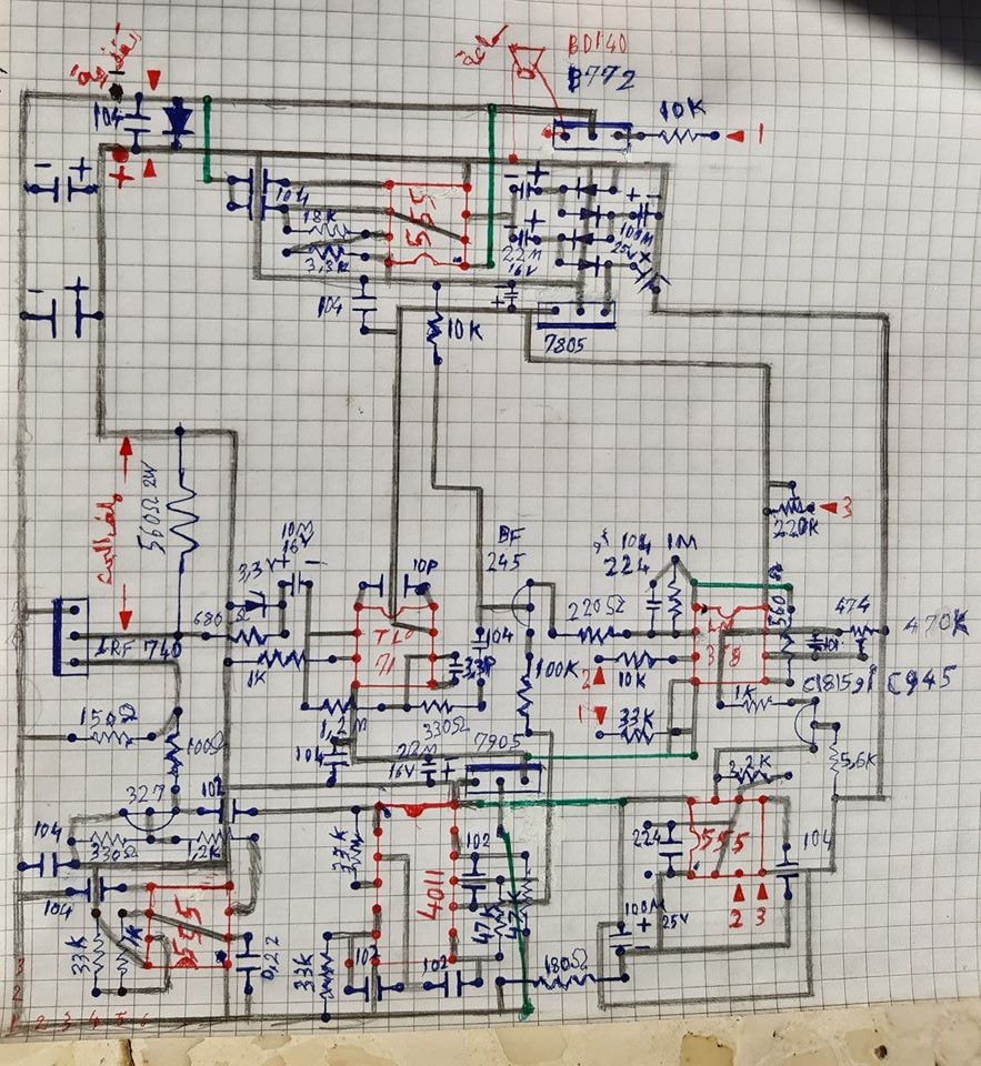

    Hi, I watched the video on YouTube There is a group on Facebook The page manager was able to modify the device Excellent wayClick image for larger version

        thanks, i moved to fb group
        will try to add the mods step by step
        hope i find good translator for arab to german or english
          do you test a frame coil 1x1m or something bigger like original 25-30cm coil
          which are the datas
          maybe 10turns of 0,8mm wire with a dia of 1m (round shape)
          which modifications on pcb, a variable wire damping resistor perhaps

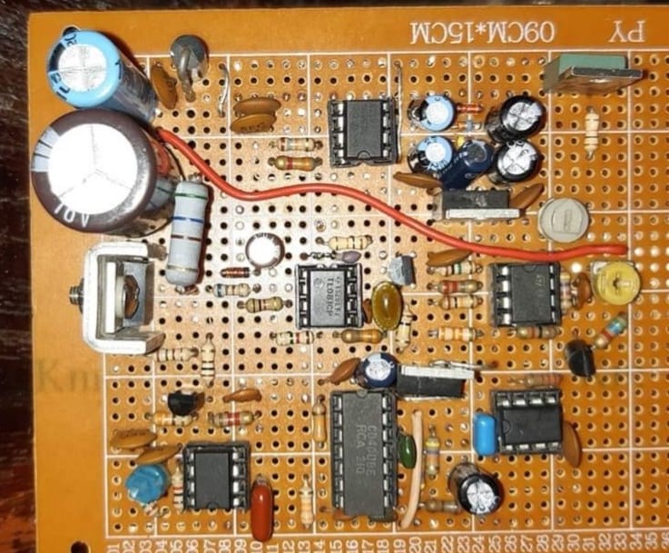

ID:	356239Hi Bernard Use Google Chrome Translate to translate for you from Arabic to German I didn't make it, but now I'm making electronic components
              I have to say that this circuit does very well on the beach, I was able to find coins at over 10 inches deep. I move slowly over the sand and listen carefully for small increase in the "click click" sound. I was surprised at how well it worked, it is very stable at the beach where there is little interference. My coil is not shielded. I set the threshold for just about 1 click per second, there I have best results.

                      after assembling working detector its time for some mods
                      but i am not sure which direction, deep hunter for big objects or medium hunter for coins and smaller stuff
                        Hi Watanabe, thanks for the answer, thats interesting that the circuit does not give false beep at the end of a coil swing
