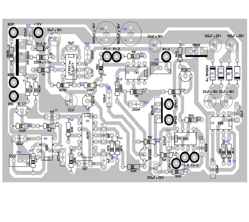

      Hello Bernte,
      Where did you get your PCB for this project?
      Cheers
        look easyeda project database, different versions, i used the one from mr freitas
        you can order project direct from easyeda or partner jlcpcb
        but remind corona virus 2019/20, i can confirm that there is a big delay in production and shipping chain
        if you live in europe i can help you out with my pcb
          Thanks very much for the quick reply. I will look at EasyEDA.
          Cheers

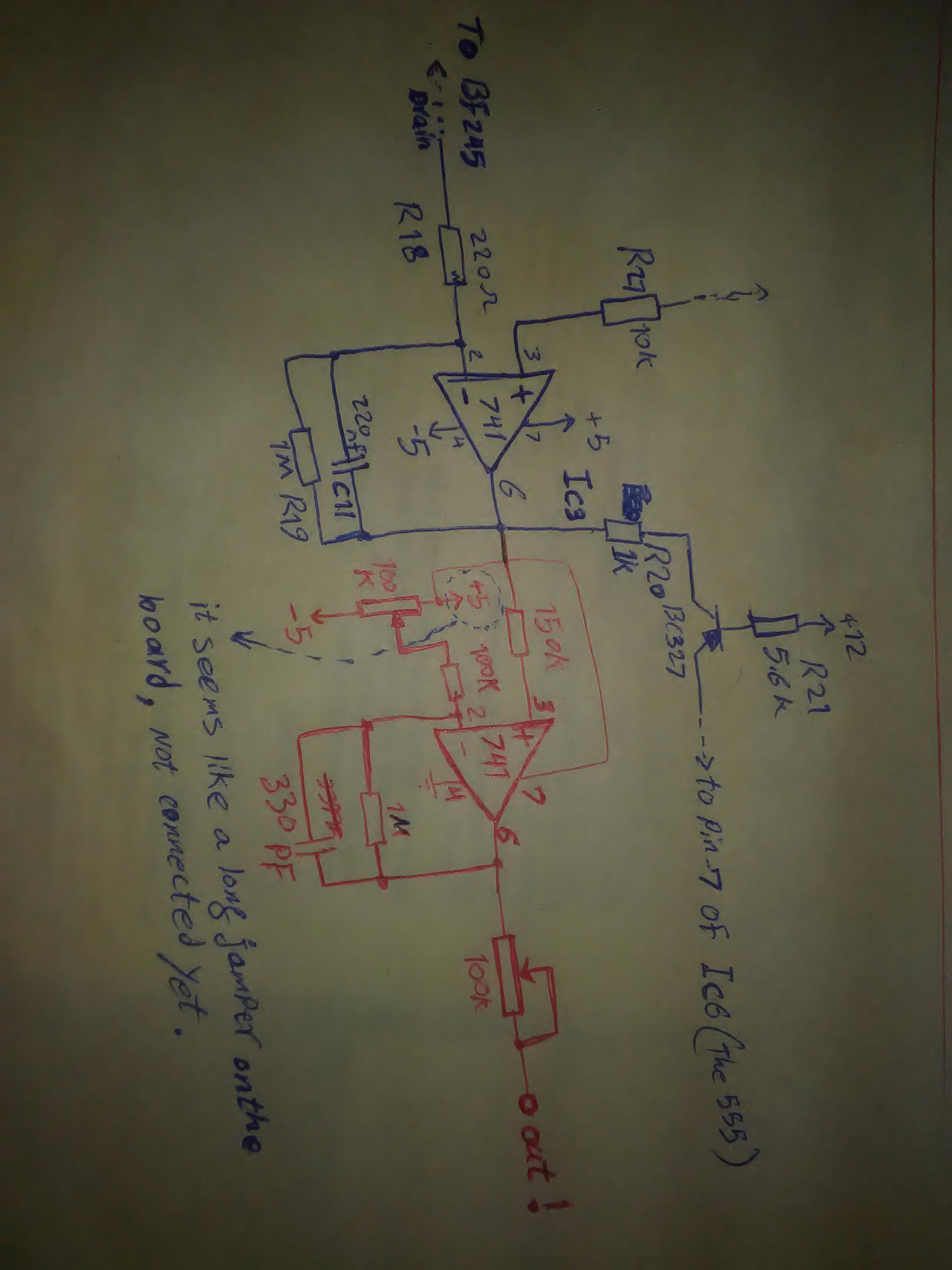

            hello there
            i have some questions about this project:
            1) has anyone measured the power consumption of Polones detector (coils connected)
            i'm going to make a 18650 battery pack (4 cells, 16V) and i want to know how many batteries should i use in order to get good battery life in field
            like 4 batteries or 2x4 ? (each 2000mAh)

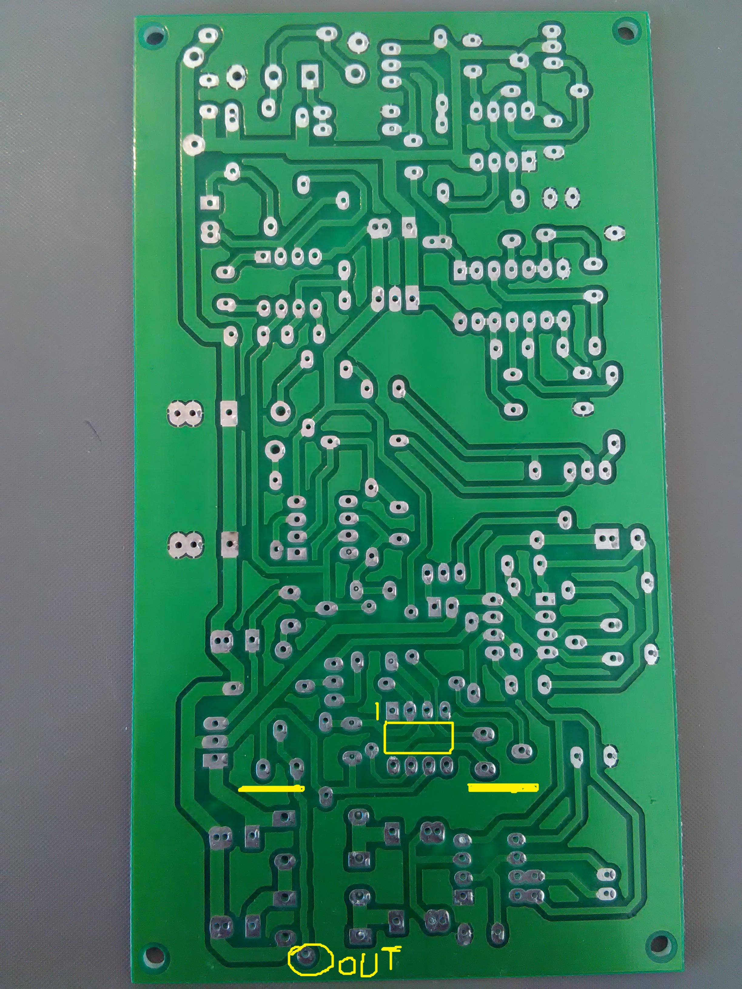

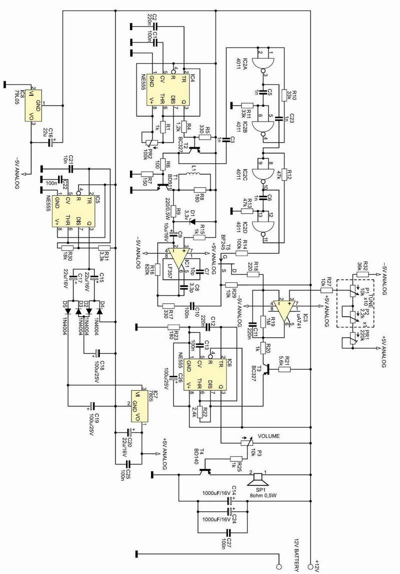

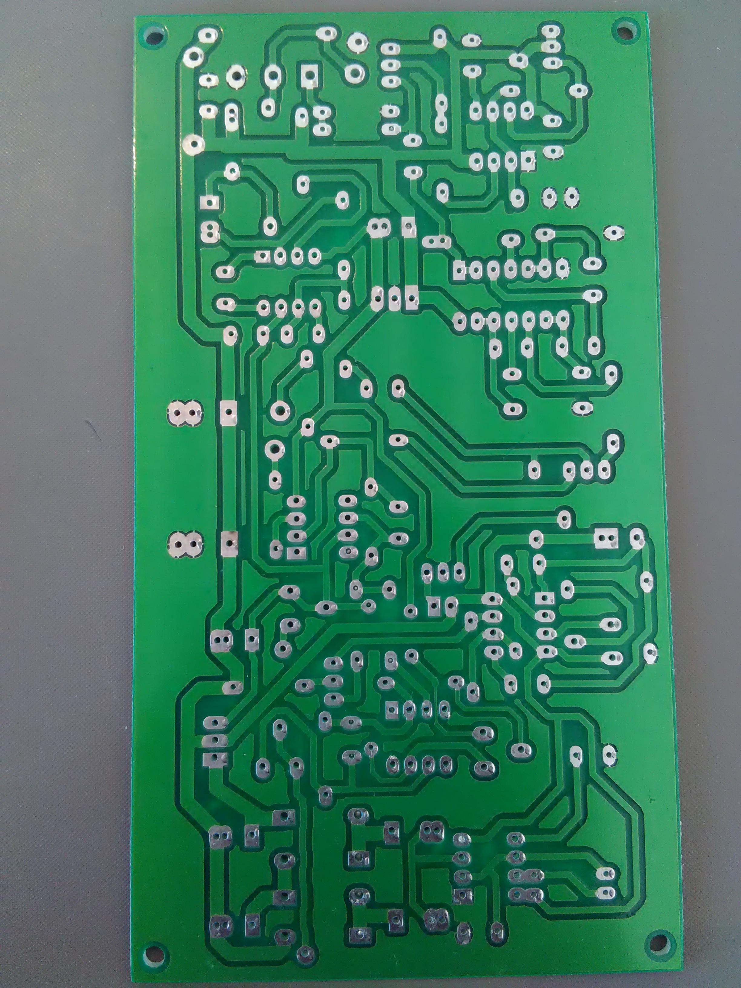

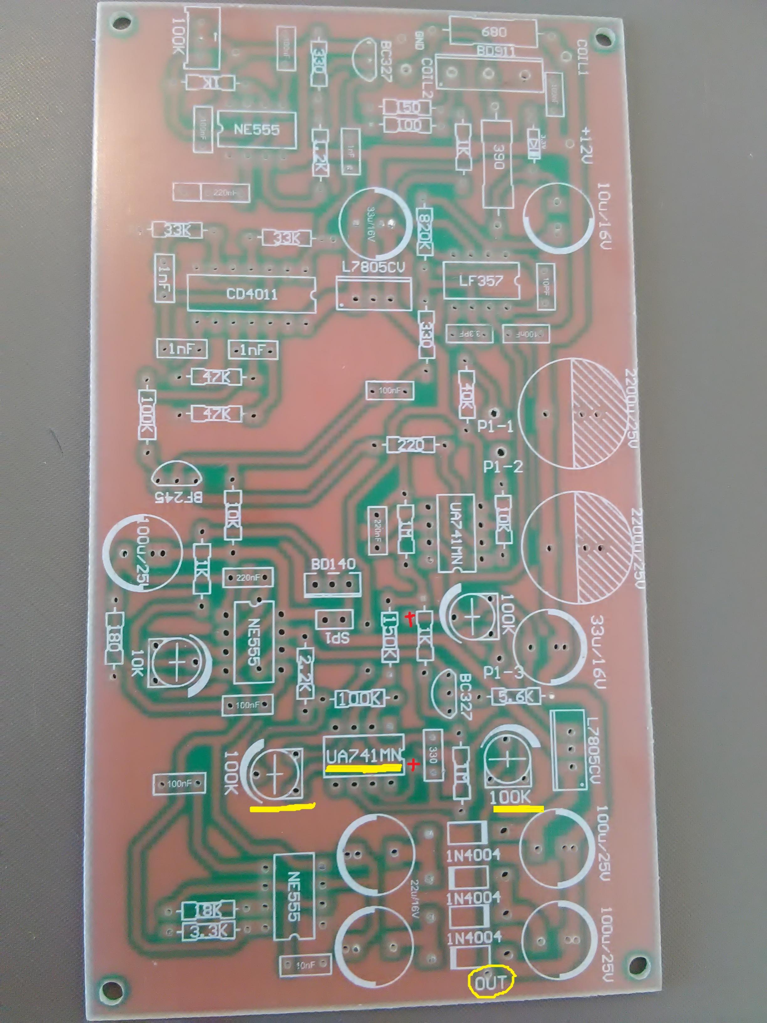

            2) i've just bought a polones kit and i found out it is a bit different from the original schematic , it has one more LM741 and couple of 100k trimmers ,i reverse engineered that part of circuit, take a look at these images:
            1- the original schematic(i guess)
Name:	Modified Sandbanks(polones) - from Ivconic.jpg
            2- pcb with new components, marked
            two red dots are for +5v jumper for the LM741 i believe
            3- now other side
            4- red parts are the new components
            i need to understand how the circuit works so i can fix it if something goes wrong and build it perfectly
            so yeah ,if any help i would appreciate that

              ok i just find out the answer for question number 2
              designer after three days replied : that is for meter!
