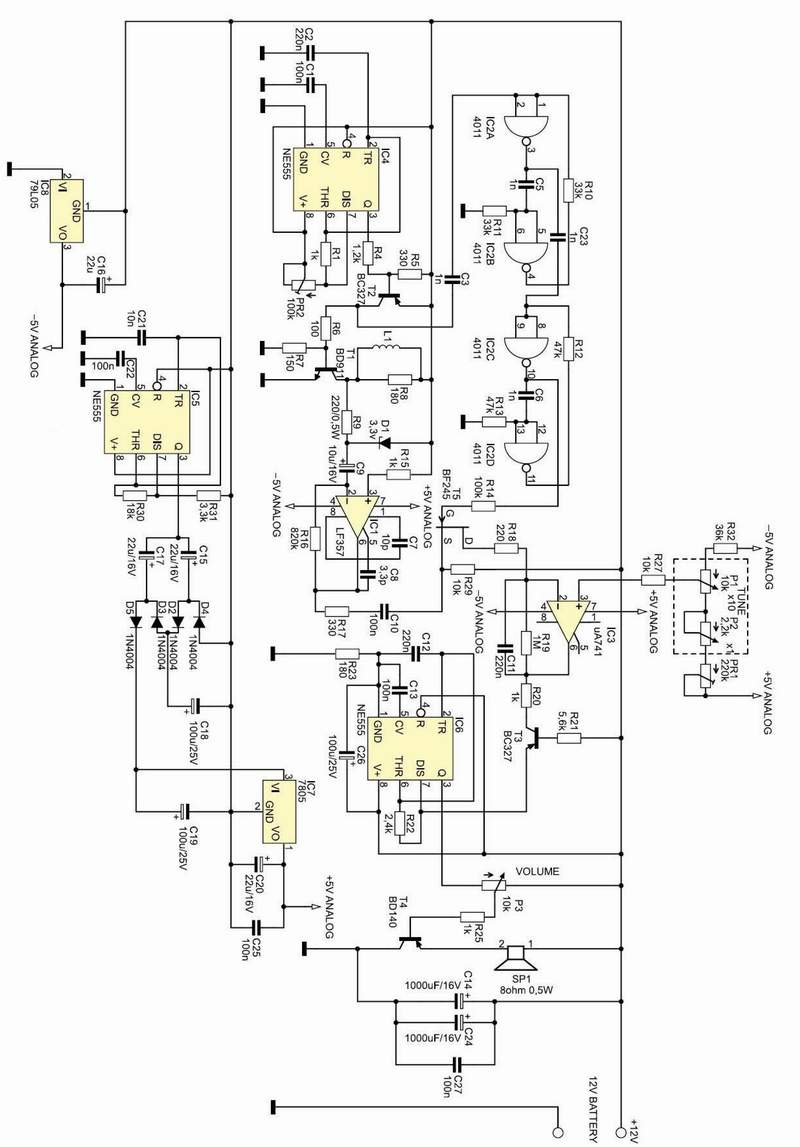

                    do you refer to R8 as damping resistor?
Name:	Modified Sandbanks(polones) - from Ivconic.jpg
                    i used R8 = 680 and R9 = 390 in my circuit
                    the mistake i made was using 0.5mm wire for coils, I should've use 0.75mm or higher
                    but your experience for depth is crazy , i love to make that happen
                    thank you
