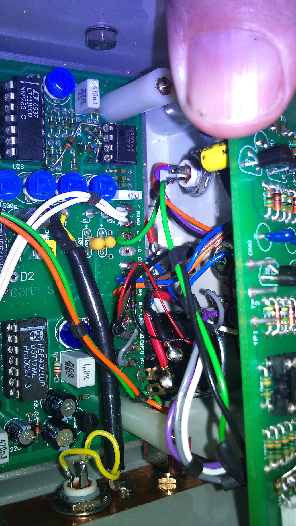

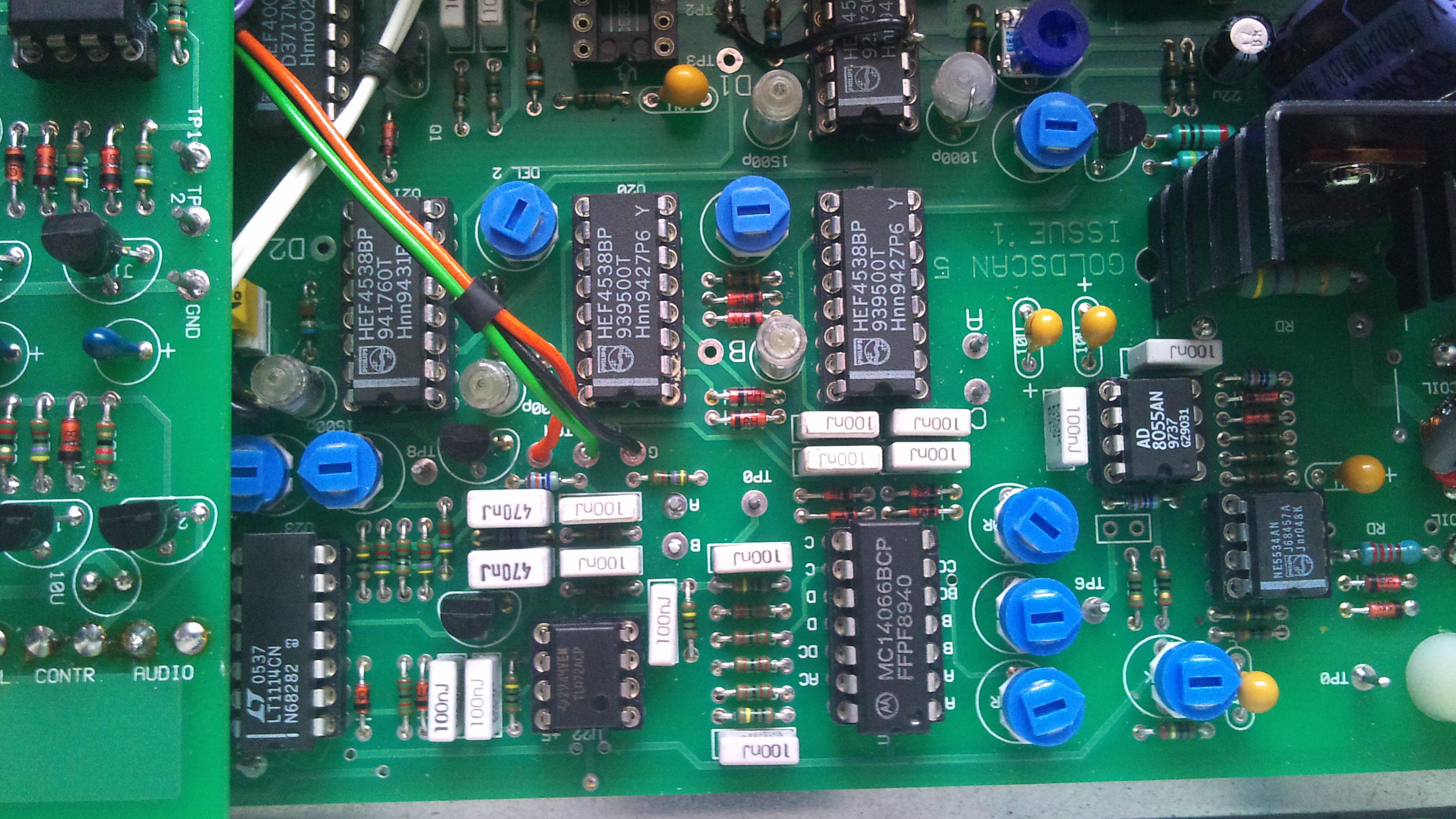

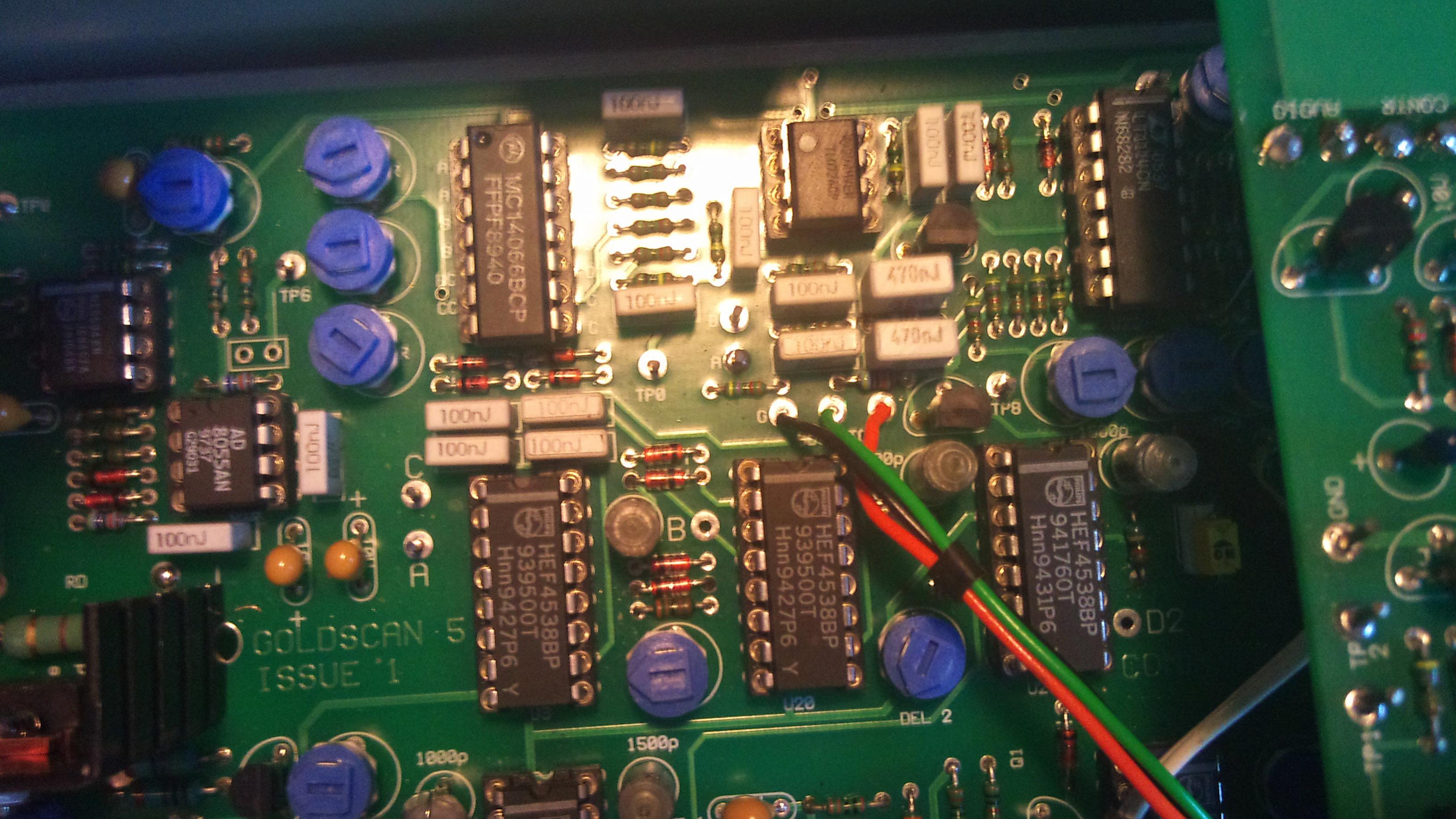

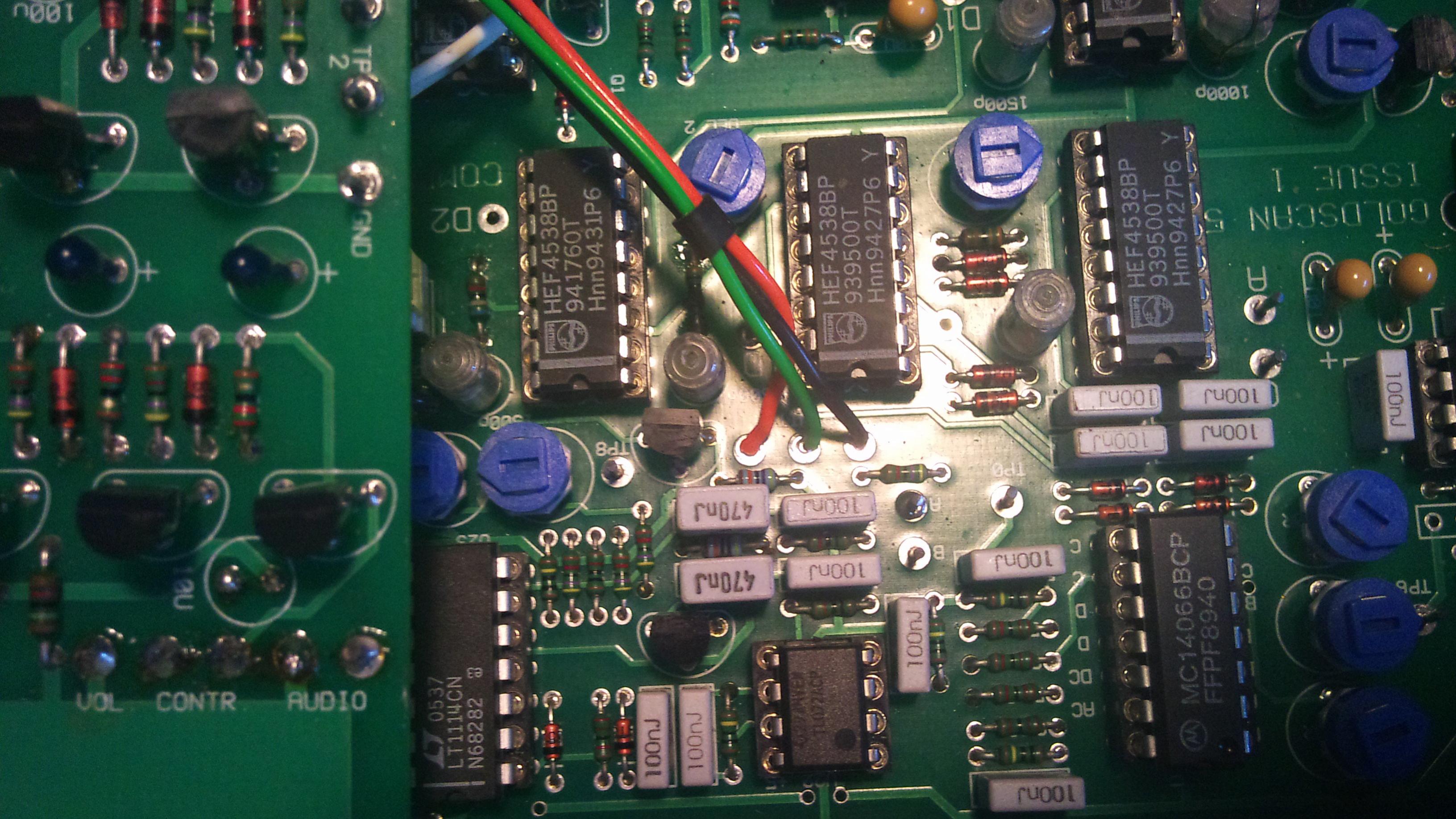

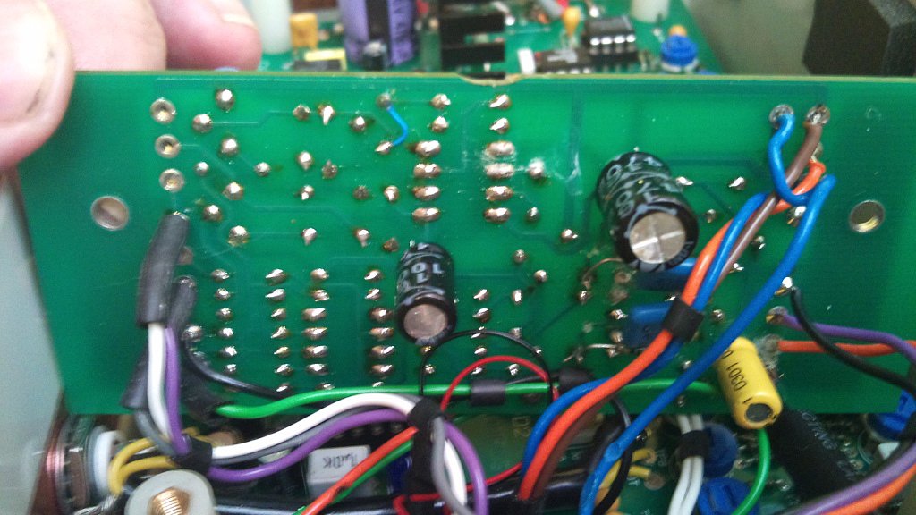

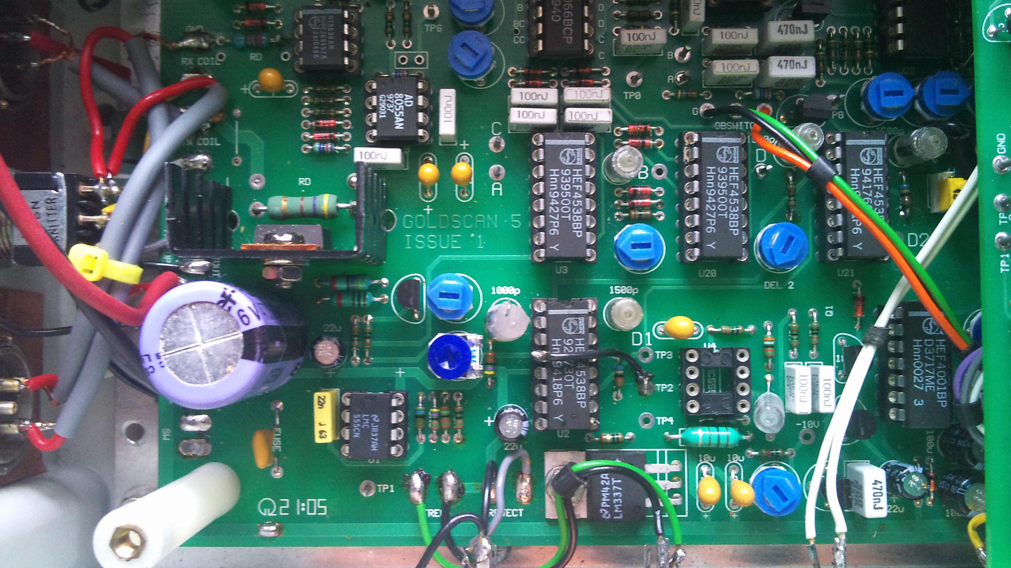

          The 4001 looks to me as it's a type of auto-tune section. Maybe someone knows better. Here are some photos

              is this your own gs 5 ??
                Gee no, don't know where I got these, from webz probably. Those are original boards.
