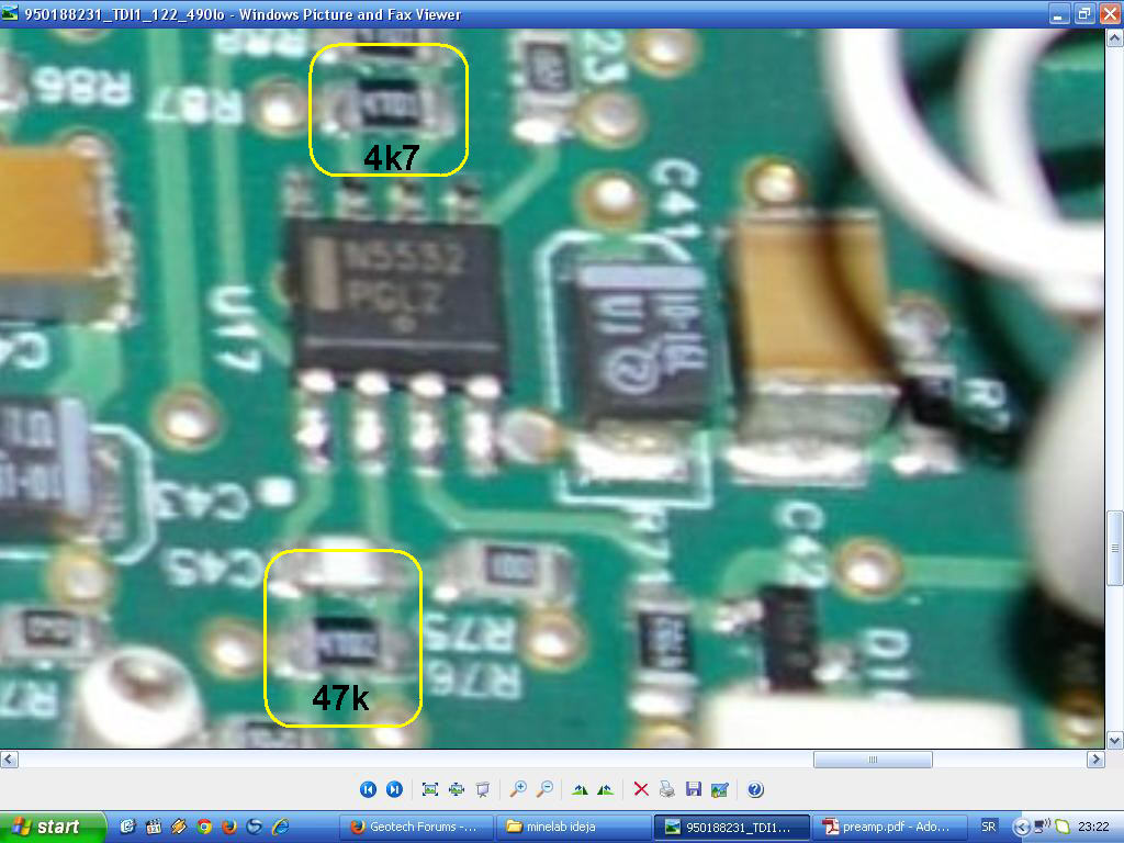

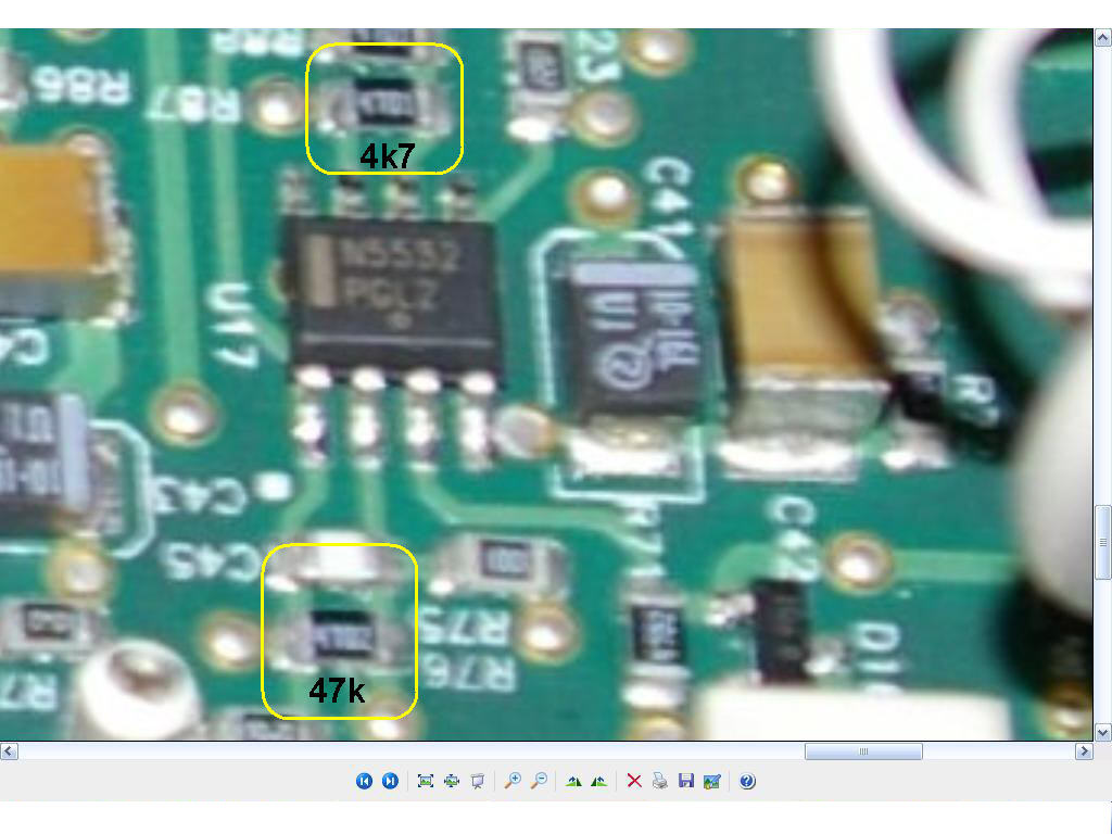

Altra, the photo in post #222.Originally posted by Altra View PostIdefix
Which photo? My board has a NE5534 and a AD8055. The second photo was not my board it was from this forum which showed a NE5532 and Geo clarified that a NE5534 was hidden under the wires
The marks on the first preamp IC are not very clear.
I think next ..The first operational amplifier ne 5534 has a very small gain double operational amplifier ne 5532 all metal channel there are, say, reinforcements from 500 x , while golden channel other half ne 5532 we amplify 1000 x and then, on the channel aplly filter time we get more gain with less noise ! That's my idea noise reduction !The amplification of operational amplifiers is arbitrary !
As I understand, there were the TDI, and the Goldscan 5. After, merging the knowhow from those two, the TDI Pro was born, with all the improvments , and sometimes some compromise.
So I think the TDI pro contains the last evolutions to be followed.
Here is a preamp which would feed single cap integrators from one of my builds. Change the AD8055 to 1/2 NE5532 and it may be what Geo's TDI preamp configuration looks like? Some good photos would tell.Attached Files
Also i think yes! !Originally posted by Altra View PostHere is a preamp which would feed single cap integrators from one of my builds. Change the AD8055 to 1/2 NE5532 and it may be what Geo's TDI preamp configuration looks like? Some good photos would tell.Attached Files
