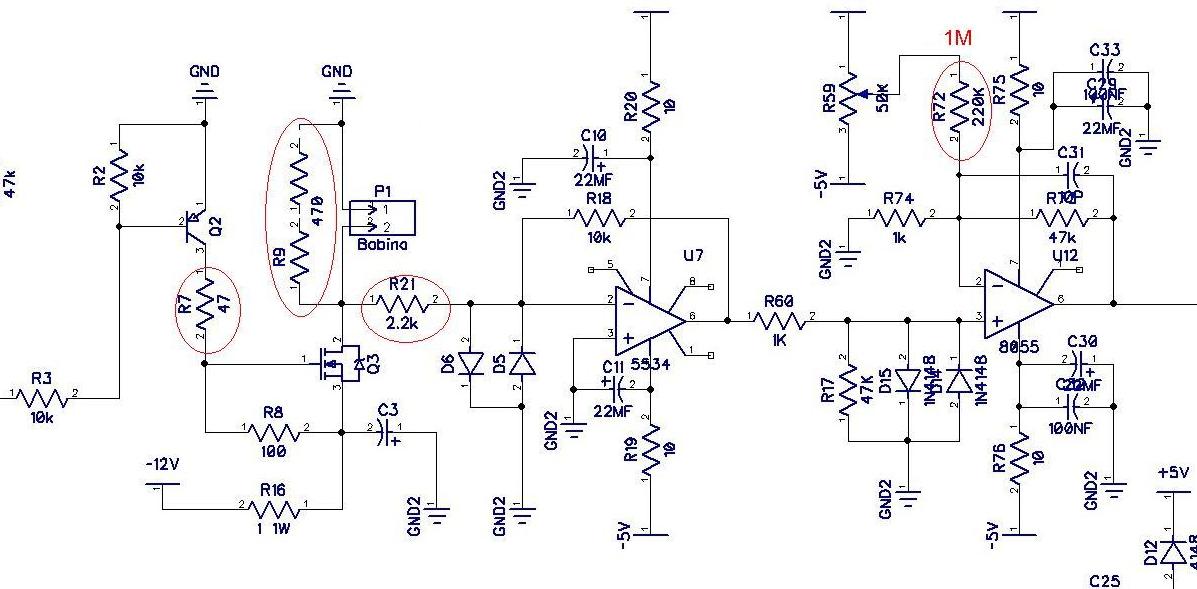

              • Originally posted by ispanyol2 View Post
                [ATTACH]44817[/ATTACH]
                [ATTACH]44818[/ATTACH]
                Hello there, well I see you have made PCB using a layout that was designed by me.
                This layout has never been tested and proven, so it is unverified.
                It was meant as an experimental platform only for verification purposes of circuit.
                That being said, I cannot say for sure that it is 100℅ accurate. I think there was a small error on area of tx stage which I later corrected, but can't recall if I posted the corrections.
                I will have a look at my files.
                In the meantime, have a look at the tracks surrounding the MOSFET and it's accompanying circuitry, comparing to the schematic.
                Please post the schematic you are using.
                • I think I have found the problem you are experiencing. Where is the SOURCE of your MOSFET connected? There is a 2ohm/1W resistor from source leg of MOSFET in series with the supply. Do you have this?
                  This is omitted from PCB layout as it was intended to be part of power supply board which I can't recall if I posted the layout for it.
                  I think layout is good, maybe you can put some pics of your board.

                      • Your writing seems logical, jose. Do you use current limiters in the mosfet feed. Or just resistance. It is possible to describe this part as Drawing.
                          I do not use current limiter, only the resistance of 1 ohms.
                          The resistance of 1M, which is seen in the image you published, seems to be 220K, in the existing schemes.
                          I use 12V, on my detector.
                          I enclose the scheme for better reference.
                          In red circle I indicate the values ​​of the components, as it is in my self-built GS5.Click image for larger version
Name:	GS5 Errores1.JPG
