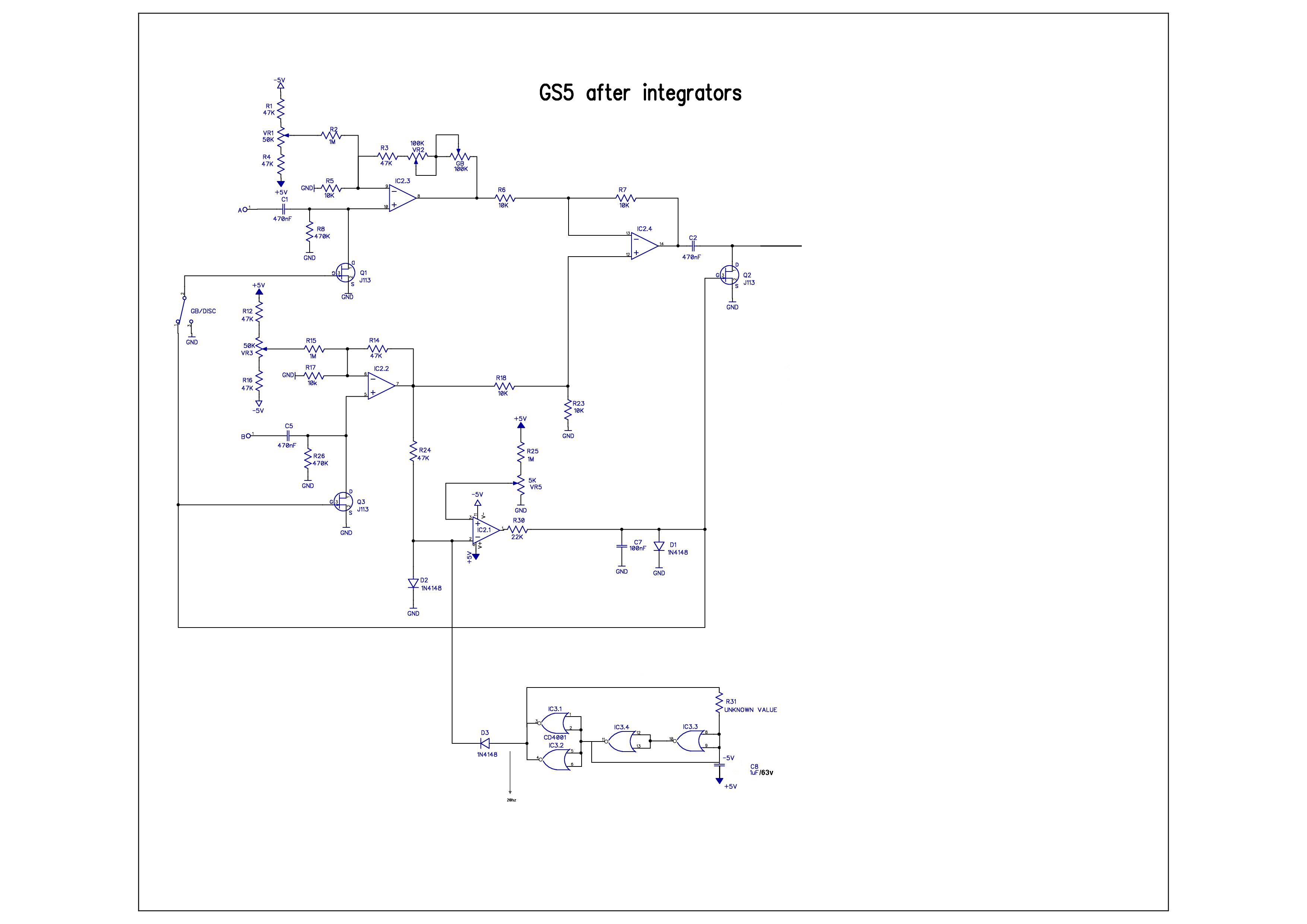

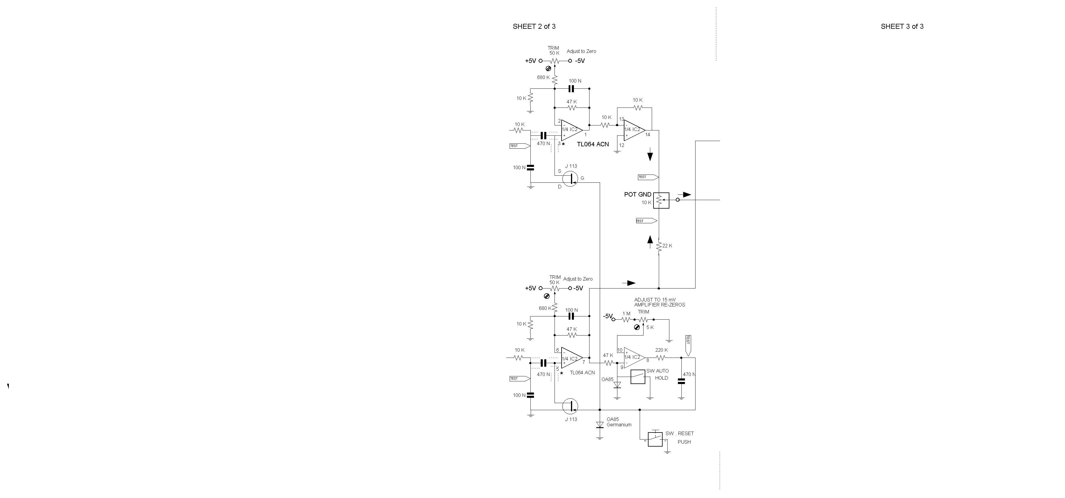

      • #78
        Hello Eric !What is specifically obtained with a different approach In the section ground balance at gs 5 In relation to gs4 ?

          Orbit are you sure the output of the "auto tune" or whatever it does, the section with CD4001 is 20Hz?
          If that is the case we can use something else to generate the 20Hz signal.
          It can probably be tuned to appear 1 time on every 100 TX cycles, before TX signal.
            Hi Orbit...i think the 4001 is a delay to stop any "blair" from the audio on switch on...maybe eric can correct me on this if am incorrect.
            • #81
              Stops high tones that they do not interfere with the low tones , when you cross the target that there is no prolonged tons ..stop any "blair" , but I did it with 20hz and it works its function ! Capacitor goes to the pin 11 directly !

              • #82
                Yes David, that is correct. Just enough delay for the electronics to settle down before releasing the Jfets. The circuit is not an oscillator. There is a redundant line on the circuit as posted with no connection points. The supply is +5 and -5V.
