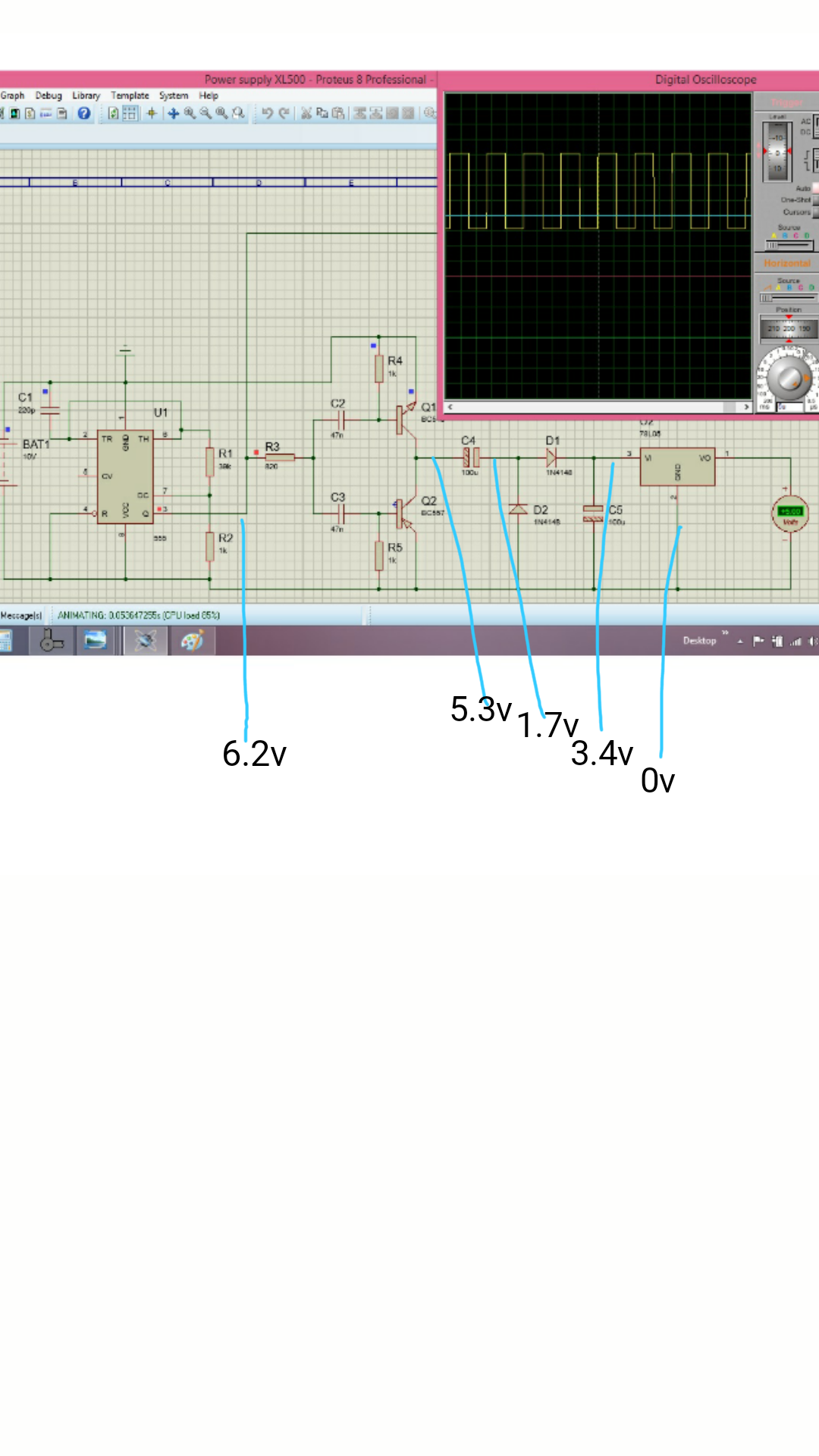

              Mr.Fred, so, all the measurement should use + pole of the batt as minus probe, right?
              With that i have:
              79 out -5v
              78 out 2v
              555 pin3 6.2v
              With 555 on right side only
              Please take a look from your proteous

              • Hi,
                Are you sure of the 220pf around right 555 ? Cause my first error was 220nf instead and i did not have my 5v. I noticed that after changing 4 transistors.
                The output of the charge pump is too low. Try with a smaller C value to increase frequency
                  Why you not mention before.... Hahaa, i put 220n, my eyes.....
                  Now i get 2.6v.......
                  Bc458 and bc558 get hot.....

                      We take time to help you. I don't like the way you talk. We did not hask for that because the first thing you do when it does not work is checking the values...
                      If your transistors get hot, they should be reversed or they drain too much current.
                      That's why your voltage is too low
                      • Sorry man, there is no expresion in a text, and im not a native english,so sorry if i offend you....Thanks
                        When i check again there is 470n missing to, already soldered now.
                        But still get hot bc557 and bc458
                        Got -6.2v on 555 pin3
                        • Okay, I am back from work, there I have no connection.
                          First check all values, as reptooyep suggested!
                          Also look careful for any short circuits, check every solded connection with DMM!
                          I try to explain do make measurements too.
                          You have to make voltage measurements of +5V, while connecting Digital-Multi-Meter minus to battery plus and DMM plus to +5V.
                          But when you make measurement of -5V, you have to connect DMM minus to normal ground battery minus and DMM plus to -5V.
                          When you want measure the voltage supply for IC, for example 709, pin 4 is -5V, pin 7 is +5V. So you have to connect DMM minus to -5V and DMM plus to +5V, than you should read +10V.
                          Anyway, when you want measurements with oscilloscope, you have to use normal ground minus from battery, for your oscilloscope ground and the signal of course to your probe.
