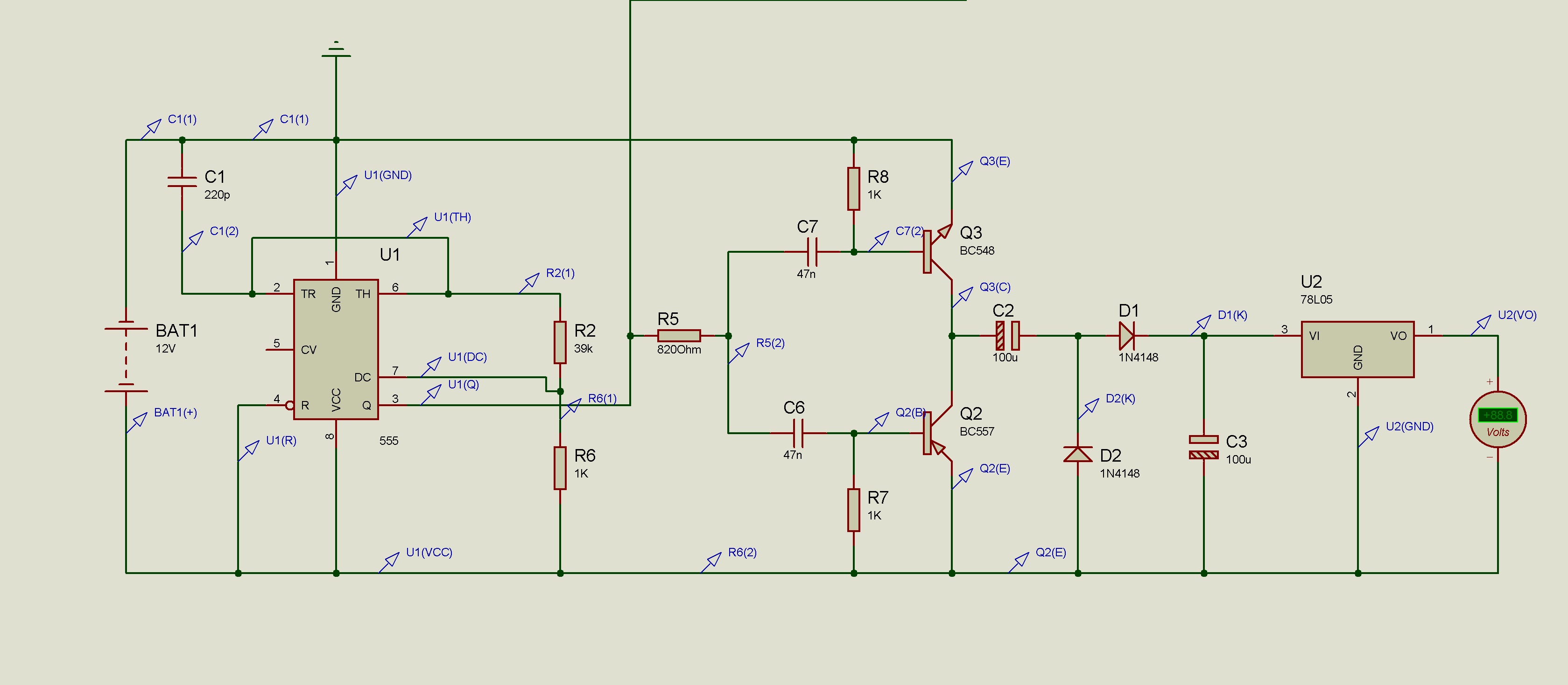

                  I make alot of mistake, its already 4 wrong component and 1 short, ...... still get hot.....
                  Any clue why i get -6.2v on 555 pin3, +pole as ground
                  According to the schematic, if you mean the right 555 (charge pump) and taking battery + as the measurement GND, finding -6.2v seems coherent cause with 12v battery and half duty cycle ..
                  The other 555 output, you should read about -0.5 or less cause the duty cycle is very very small ..

                      Good morning,
                      Yes its charging 555, so theres no problem with my 555, i will get some of it again to make sure. So there is no conection with bc548 get hot right?
                      And for 78l05 i will get some replacement...
                      And about prometeus mr.fred explain, when i make the circuit diagram, i see output of 555 pin 3 is 12v dc (max) not -6.2v, or maybe i dont know how its work, please take a look:

                      • My simulation gives me pin3 555 9,5V p-p.
                        What do you read, when you put there in parallel pin 3 to olus battery, an AC volt-meter? With DC volt-meter I have there an always changing signar, I think because, this is not a real simulation, the frequency is too high, for CPU. I had this message below in the programm.
                        • With AC volt meter its read 12v, then down...down and down, with DC voltmeter have the same maner, changing every time.
                          • Just change 555 and 78l05 with new one, same result
                            Pin3 -6.5v, 78 out 3v....
                            (Change 78L05 with 7805)
                            What is it preciusss......

                              • Originally posted by blobber View Post
                                To get 5v on 7805 output, i need 12v on pin3 555 (-pole ground), acording to prometeus. You have 10v batt, pin3 is 9.5 (near 10v).
                                Now i get 5.7v on pin3 (-pole ground), how to make it near 12v?
