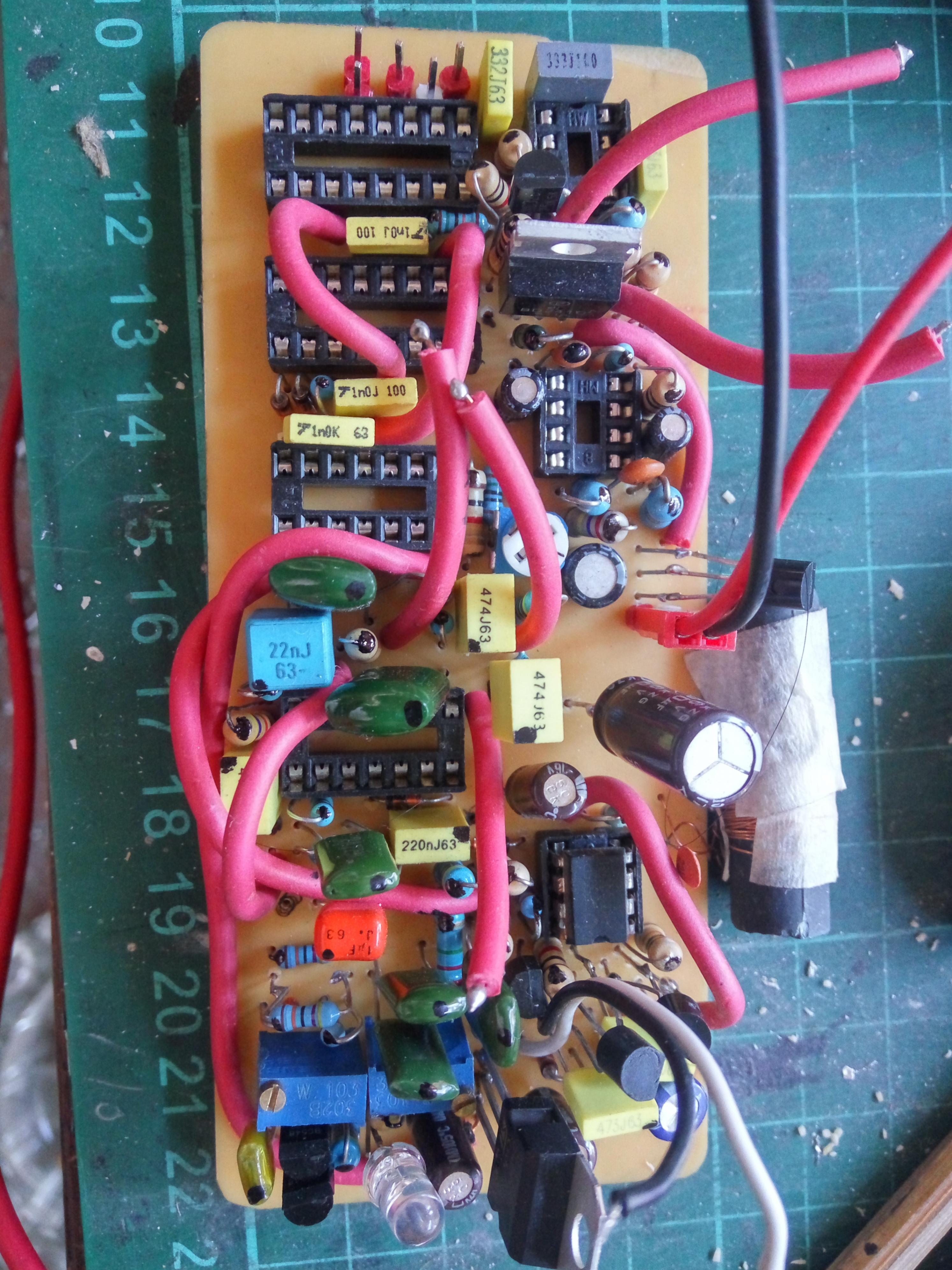

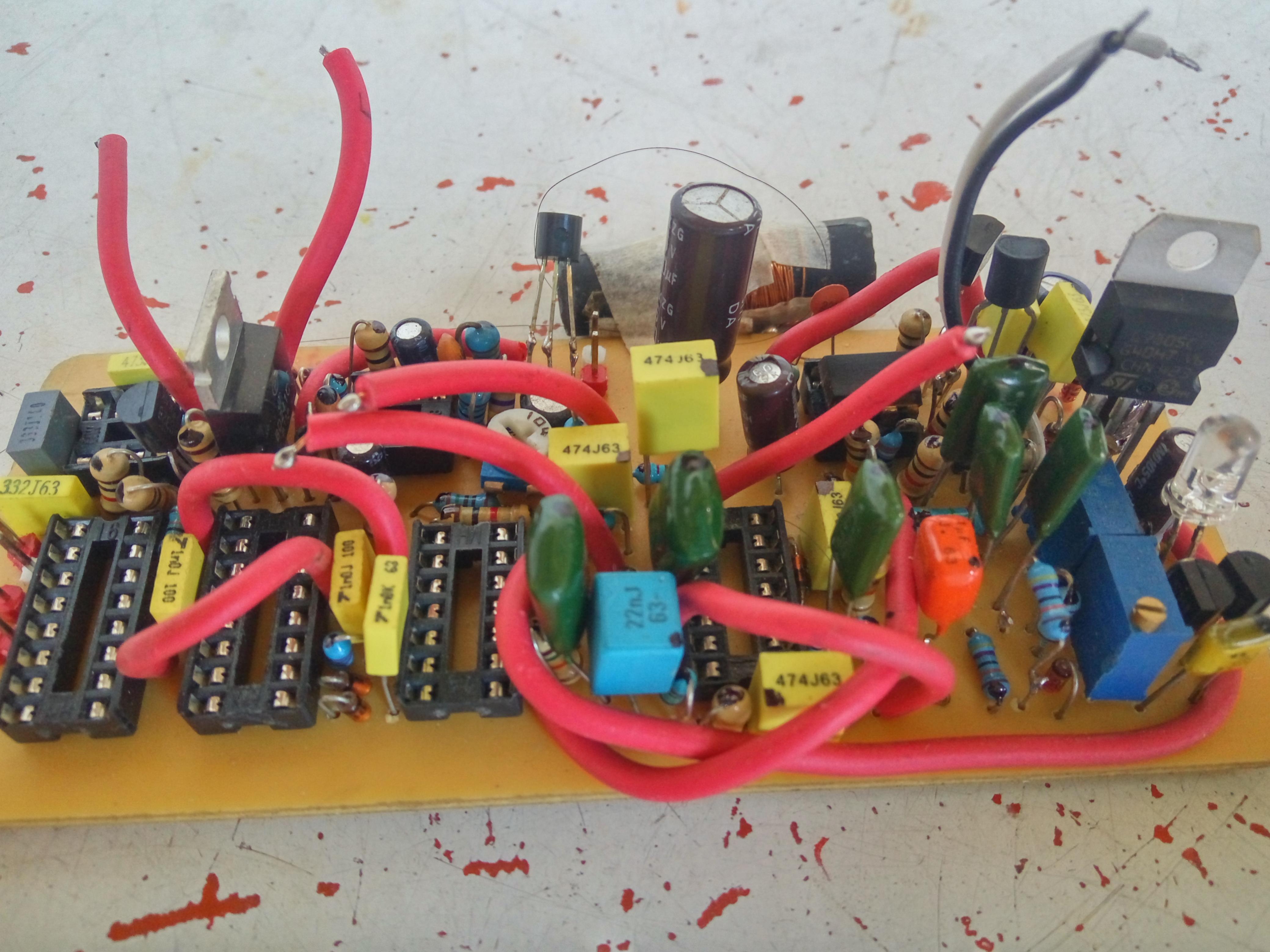

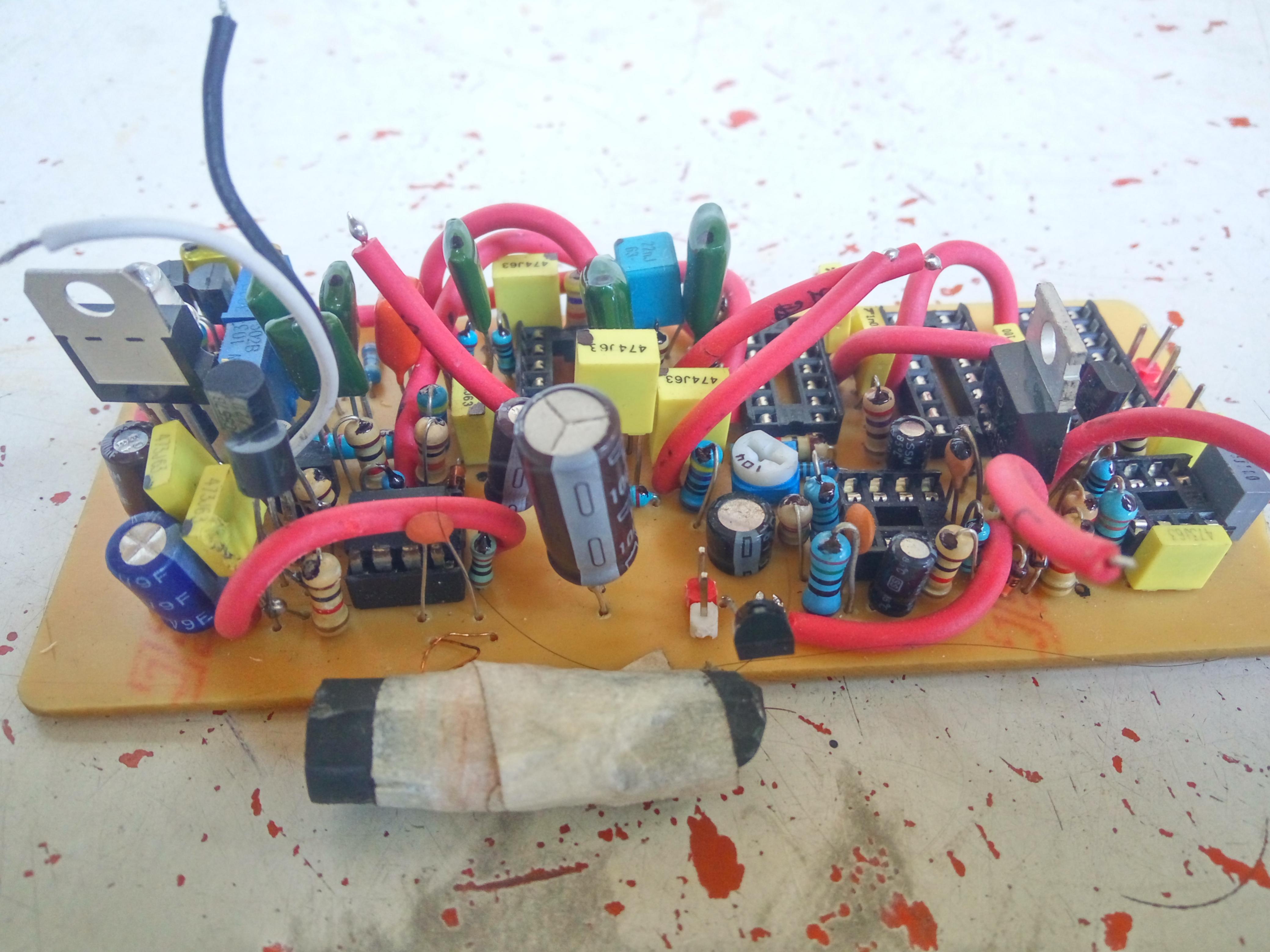

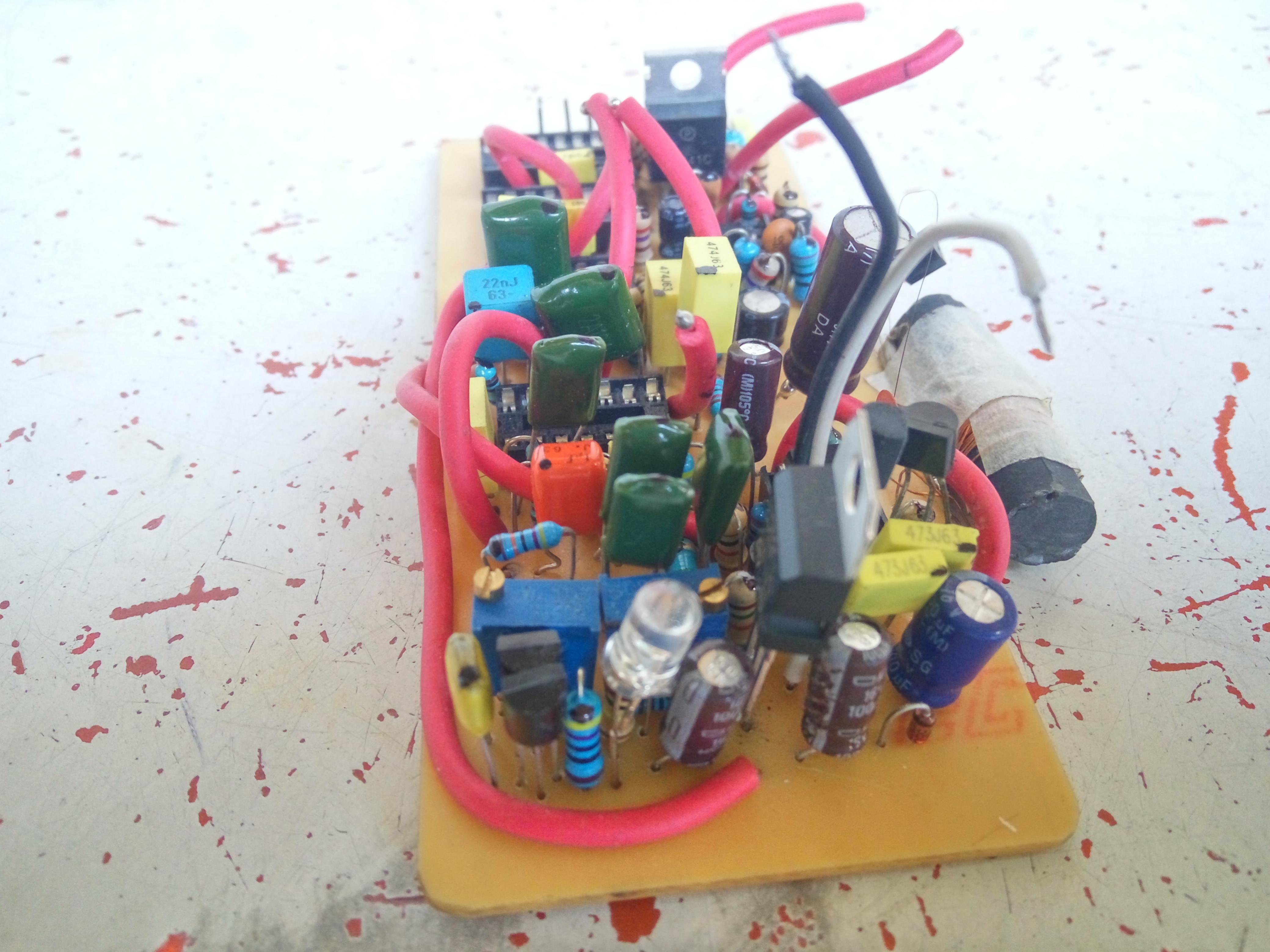

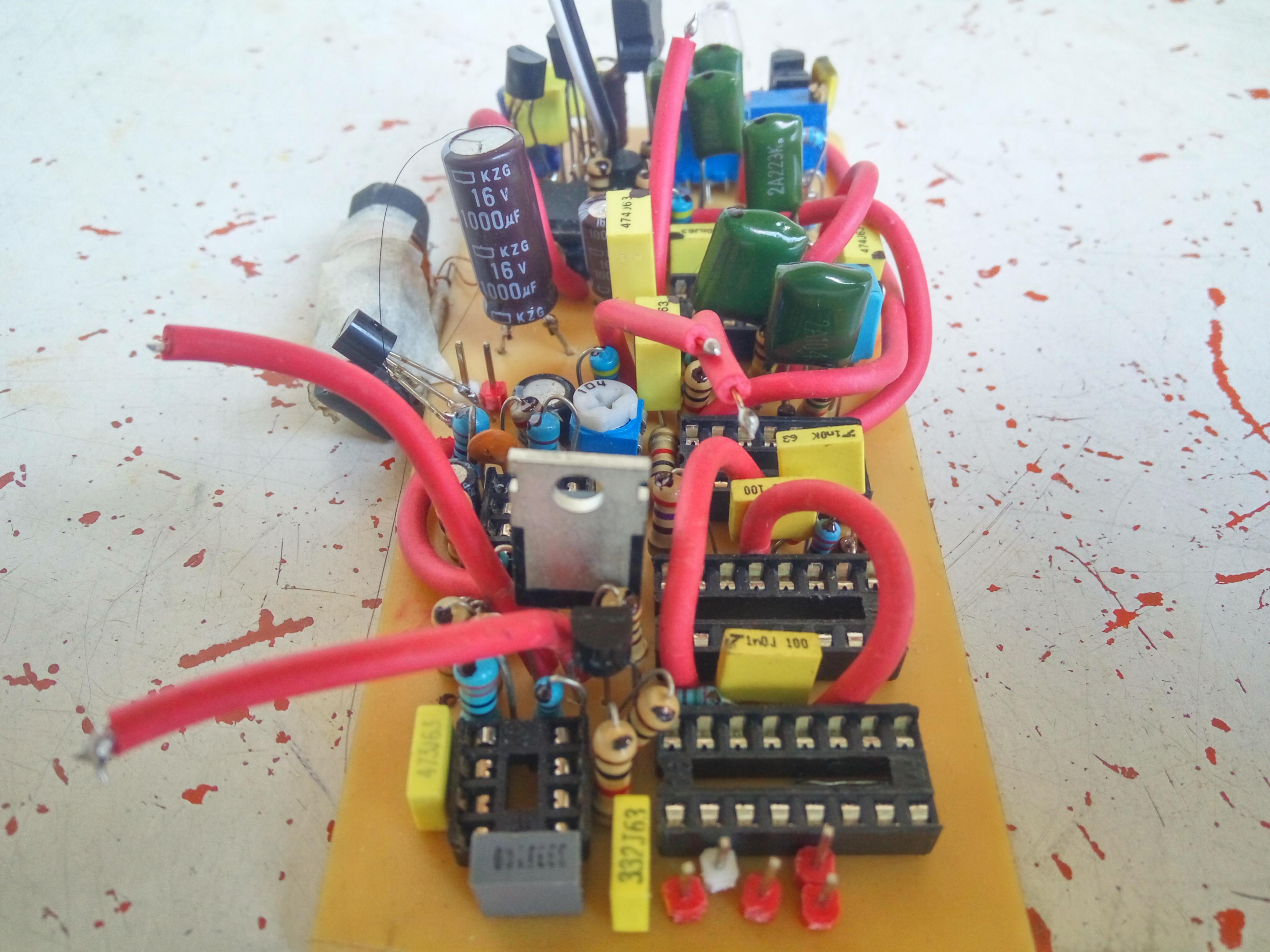

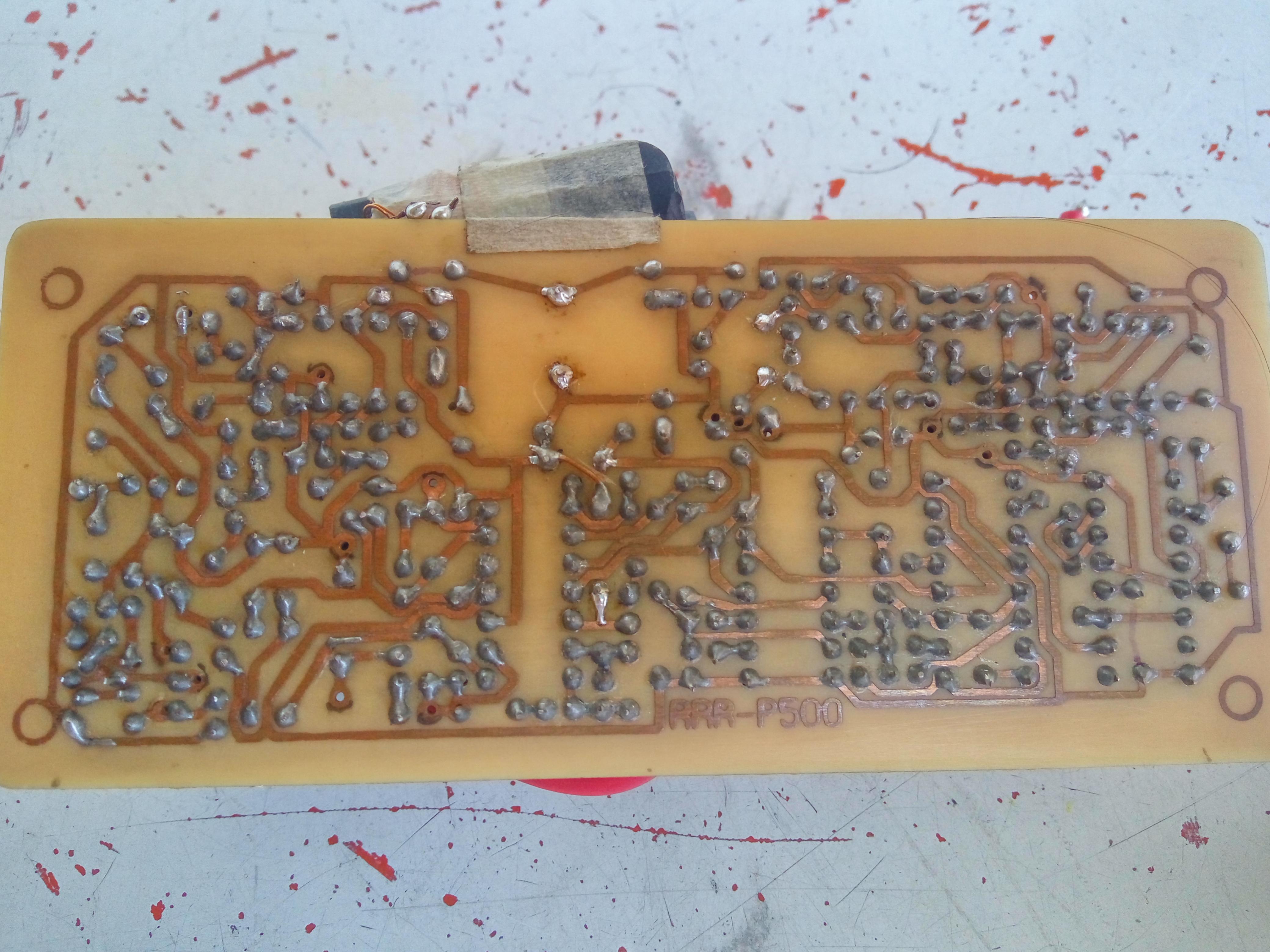

                              • 7808 input 3.9v
                                High res pic
                                Top

                                Side1
                                Side2
                                Side3
                                Side4
                                Bottom
