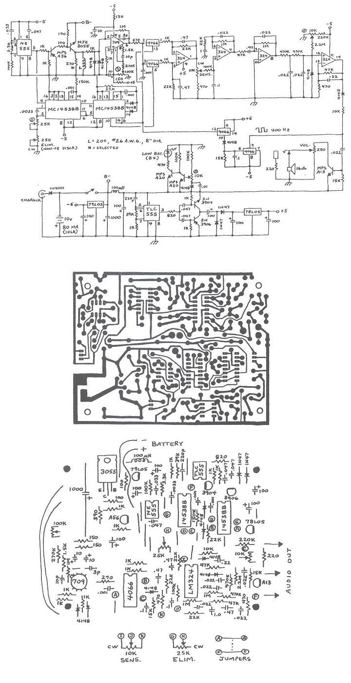

    7808 input 3.9v
    Too low output charge pump could have several reasons.
    If your 200pf is good value, i would change the 2 transistors and the 2 diodes of the charge pump.
    I'm sure you've already verify the capacitor's polarity..
    • Originally posted by reptooyep View Post
      Hello,
      220pf is good, i measure it before soldering, 2 transistor already change.
      Let me try change diode....
      • Reptooyep,
        Geniuss....!! I found it to be 4v3 diode...... I think the seller give the wrong item, i will check the others 4148

          Your bottom view is not so clear! Are you sure, that you have there no short circuit?
          • Originally posted by blobber View Post
            Bottom
            [ATTACH]37145[/ATTACH]
            Yes im sure, some pad s is less than 1mm to each other, very hard to see in picture.
            Bc548 and 558 not hot anymore, but pin3 555 charge pump is 0v, not like yours 10v

                Measurement without 555 oscillator, -pole as gnd:
                battery voltage -11.9v
                555 pin 3 charging pump -6.4v
                Oscillator 555 pin3 0v
                collector T2 0v
                output 709 pin 6 0v
                4066 pin 13 0v
                4066 pin5 0v
                There is something wrong here....
                • Pole — as gnd ?
                  Is it a joke ?
                  You said without 555 oscillator but it has non sense, which one ?
                  Do you mean you have put all chips exept 555 ? It's not clear.
                  Without any chips, it's normal to have 0v output..
                  • Omg...sorry wrong writing, i mean +pole
                    Yes that only with 555 charge.
                    • Could you please measure the power supply of the chips, now that you have -6.3 charge pump supply ?
                      GND (Still battery +) of NE555 (pulse generator) and pin 1 = -5v
                      GND and 4538 pins 8 and 12 = -5v
                      GND and LM324 pin 4 = +5v
                      GND and LM324 pin 11 = -5v
                      GND and LM709 pin 7 = +5v
                      GND and LM709 pin 4 = -5v
                          Good morning all,
                          Yes, 555 pin3 charge pump (555 right side) -6.3v
                          NE555 (pulse generator) (left side 555) and pin 1 = -5v ok
                          GND and 4538 pins 8 and 12 = -5v ok
                          GND and LM324 pin 4 = +5v ok
                          GND and LM324 pin 11 = -5v ok
                          GND and LM709 pin 7 = +5v ok
                          GND and LM709 pin 4 = -5v ok
                          All okay....
