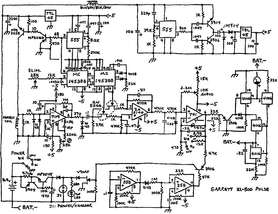

Garrett (pulse) XL 500
Name:	GARRETT XL-500_sch.jpg
      Yes, those are correct.
      Eric.
        Eric.
        http://www.geotech1.com/forums/showt...384#post219384

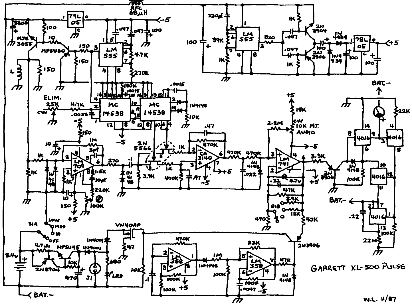

        Hi Eric
        The schematic reply #31 has the .1u cap. mentioned in above link. Would you suggest changing it to a different value?
          Hi Eric
          Definitely. Provided the differential integrator is balanced then you should be able to put a shorting link in place of the capacitor.
          In the original of this circuit I used a 22uF 6V tantalum cap with the negative end to the preamp. I then set the preamp offset to -0.5V to give a bit of bias to the tantalum cap. You need a response almost to dc in this part of the circuit as otherwise the EF cancellation is compromised. A 0.1uF cap that Garrett used, giving a high pass response at this point, was not the best.
          Eric.

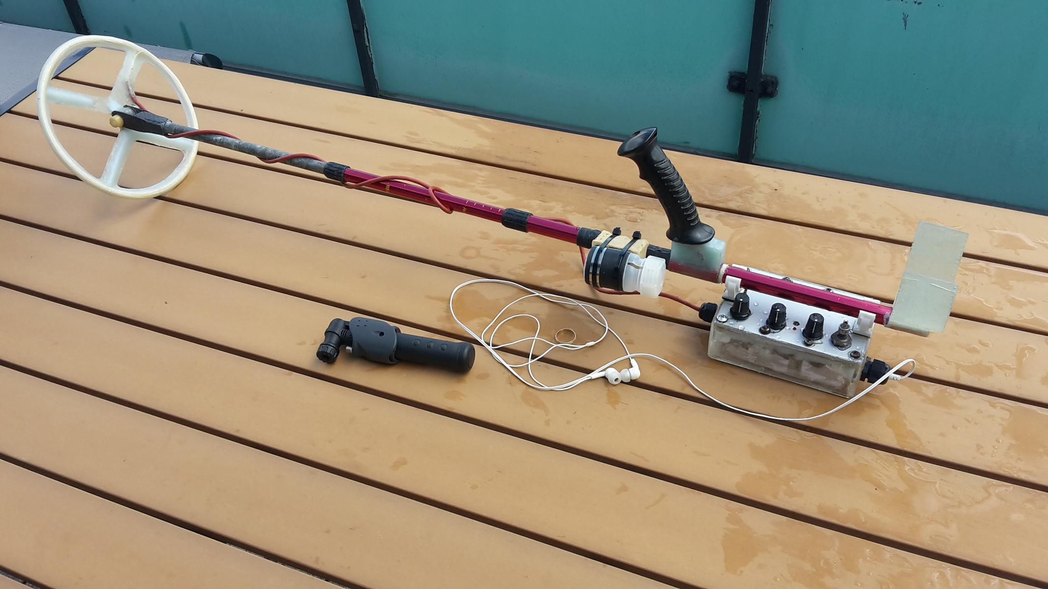

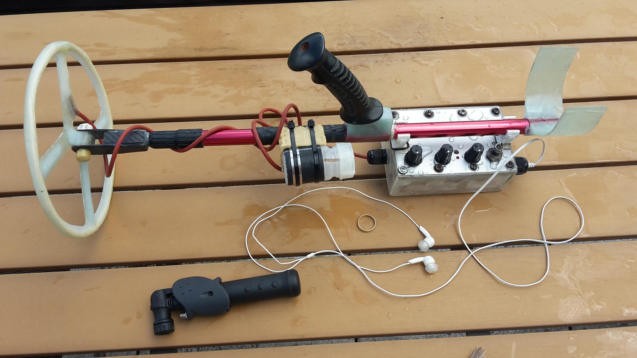

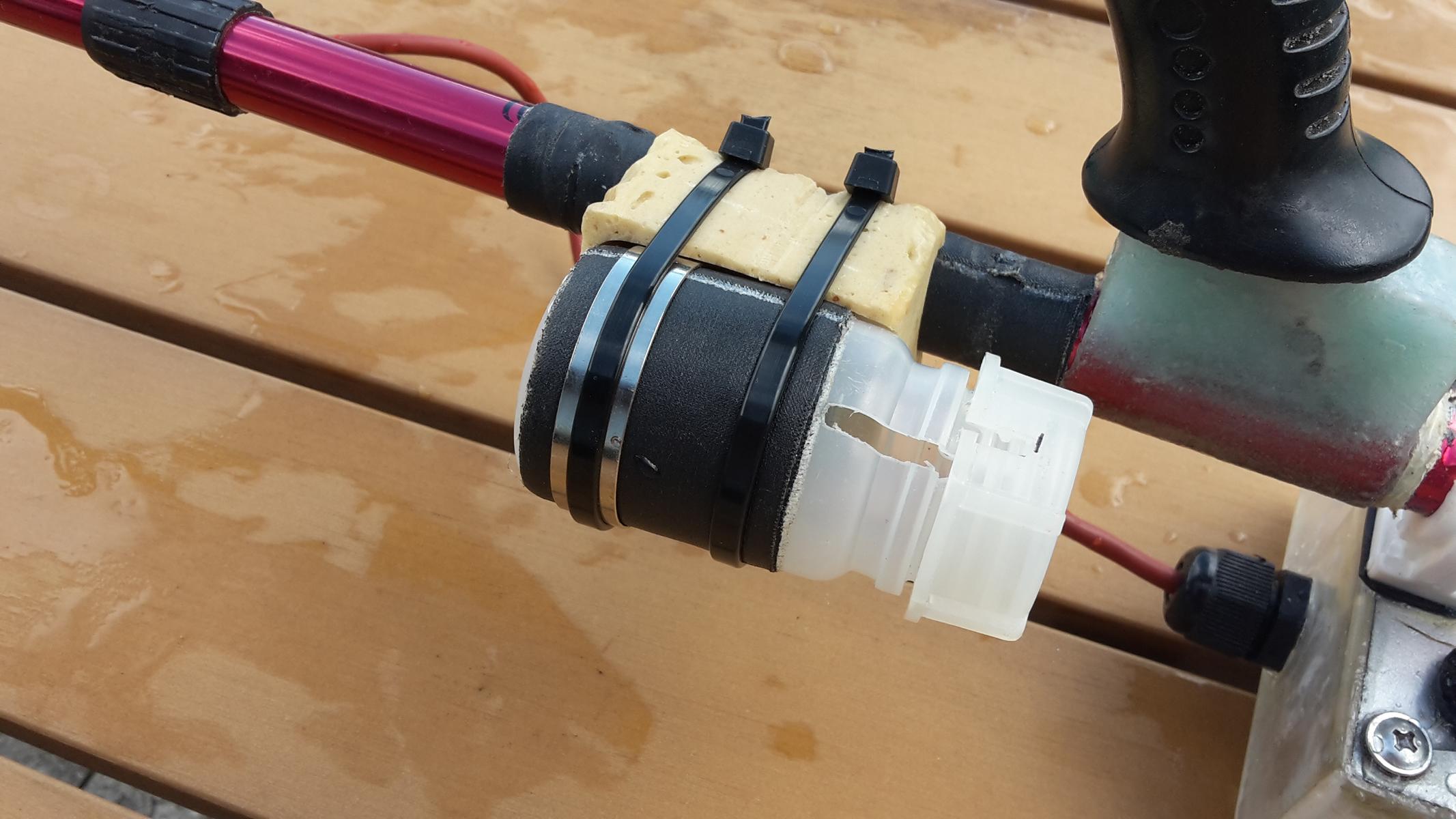

            some impressions of my PRO XL500
Name:	56 cm for transport.JPG
Name:	ready for the hunt.JPG
Name:	container for rings and coins.JPG
Name:	everything in my bucket.JPG
Name:	my under water head phones.JPG
            https://youtu.be/zcRZcBLnDhU

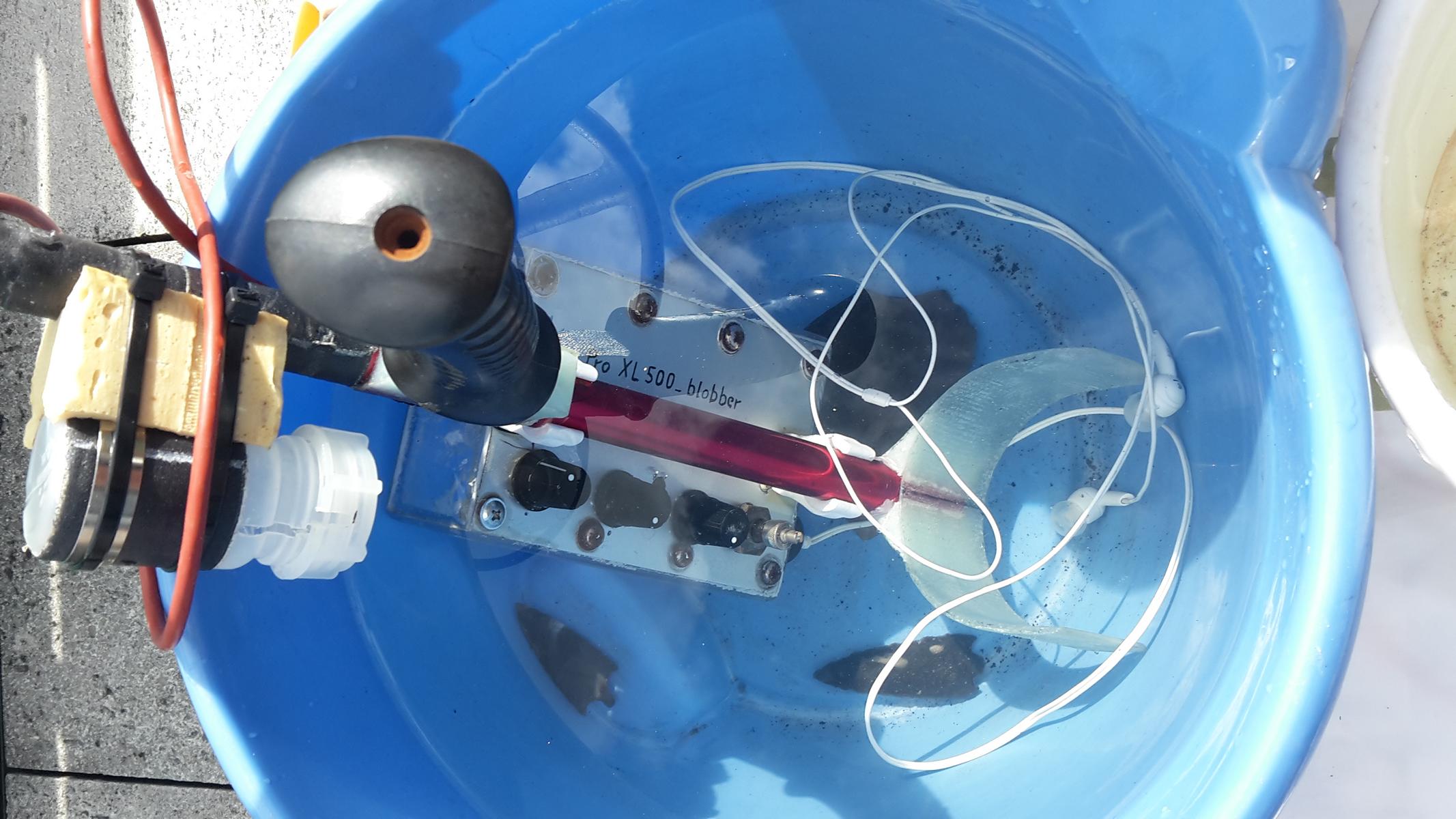

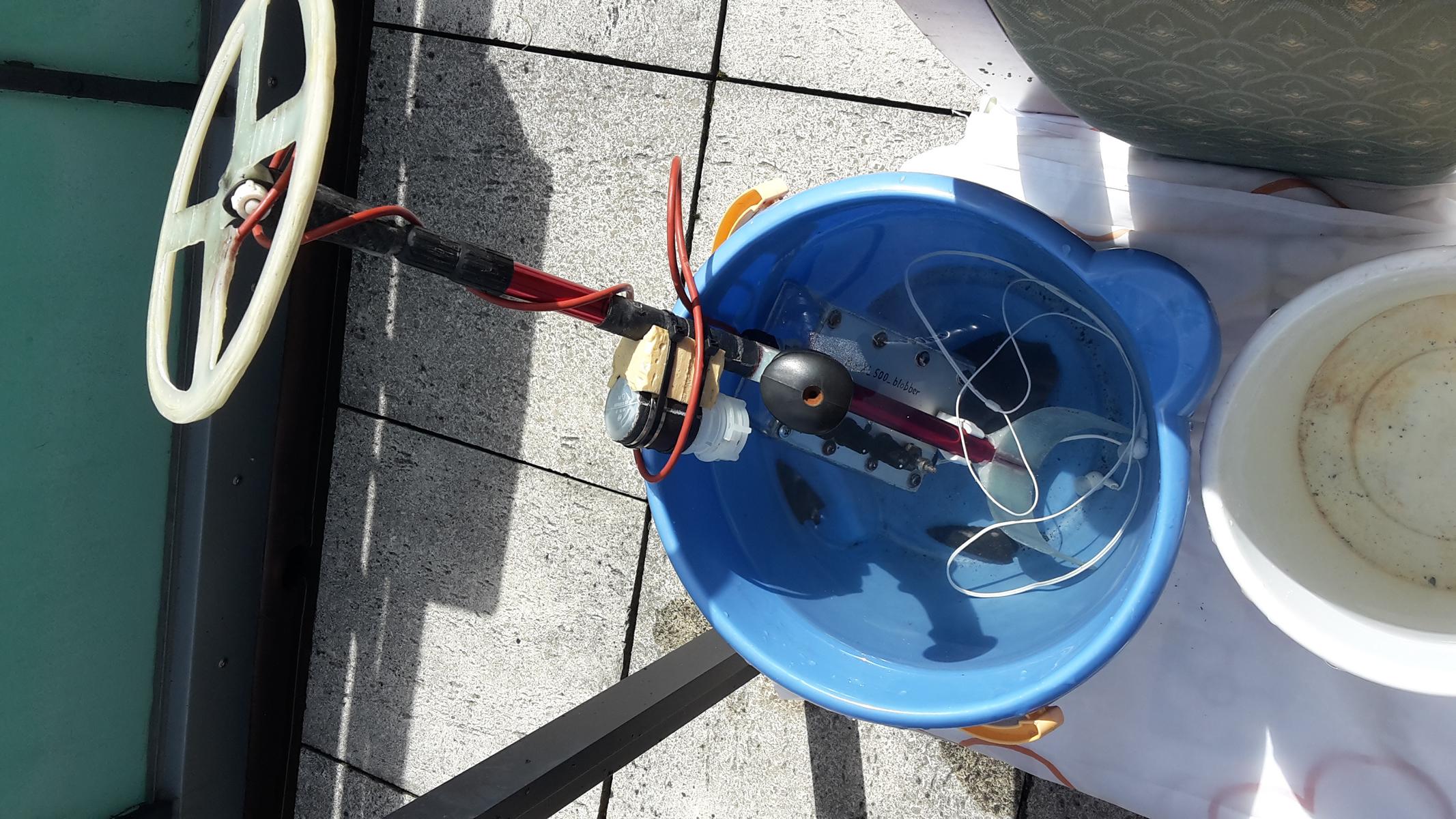

              I'm making a waterproof detector to use it in salt water scubadiving.
              I have few questions about the motion pi detector :
              1st: Do you think IP67 pots would work in salt water ?
              2nd: Can you explain few thing about tuning this unit ? I mean, adjust the trimmers on the board.
              3rd: I have two coils waiting for a detector (see picture). Which one do you think is the best for this detector (maybe none ???) ?
              I was puzzled the first time i saw the shematic cause the + power is generated by a charge pump on the negative power with NE555 ... It was strange for me, usually, it's the opposite way but waybe i did not see enough schematic ...
              Your help would be appreciate.
              About pot IP67 I can only say, they are dust proof and in my opinion, it means not, that they are water proof.
              The trimmer 10k near 78L05 is threshold for audio and 25k near 4538 is discriminate basic adjustment. 10k near T5 is low battery control, Trimmer 100k near 709 is also not critical. Near middle position, you will have the best operation point and detecting range for targets.
              As I made this detector in 2004, I had only a simple multimeter and my ears for adjustment. It was very quick to do.
              Your coils are looking very interesting, I think both will working good.
              Could you give instructions, parameter please, about the left coil?
              Fred
                Yes, I also was confused, about power supply, but it's working realy
                fine. But a good option could be #17 by RS_Phil.
